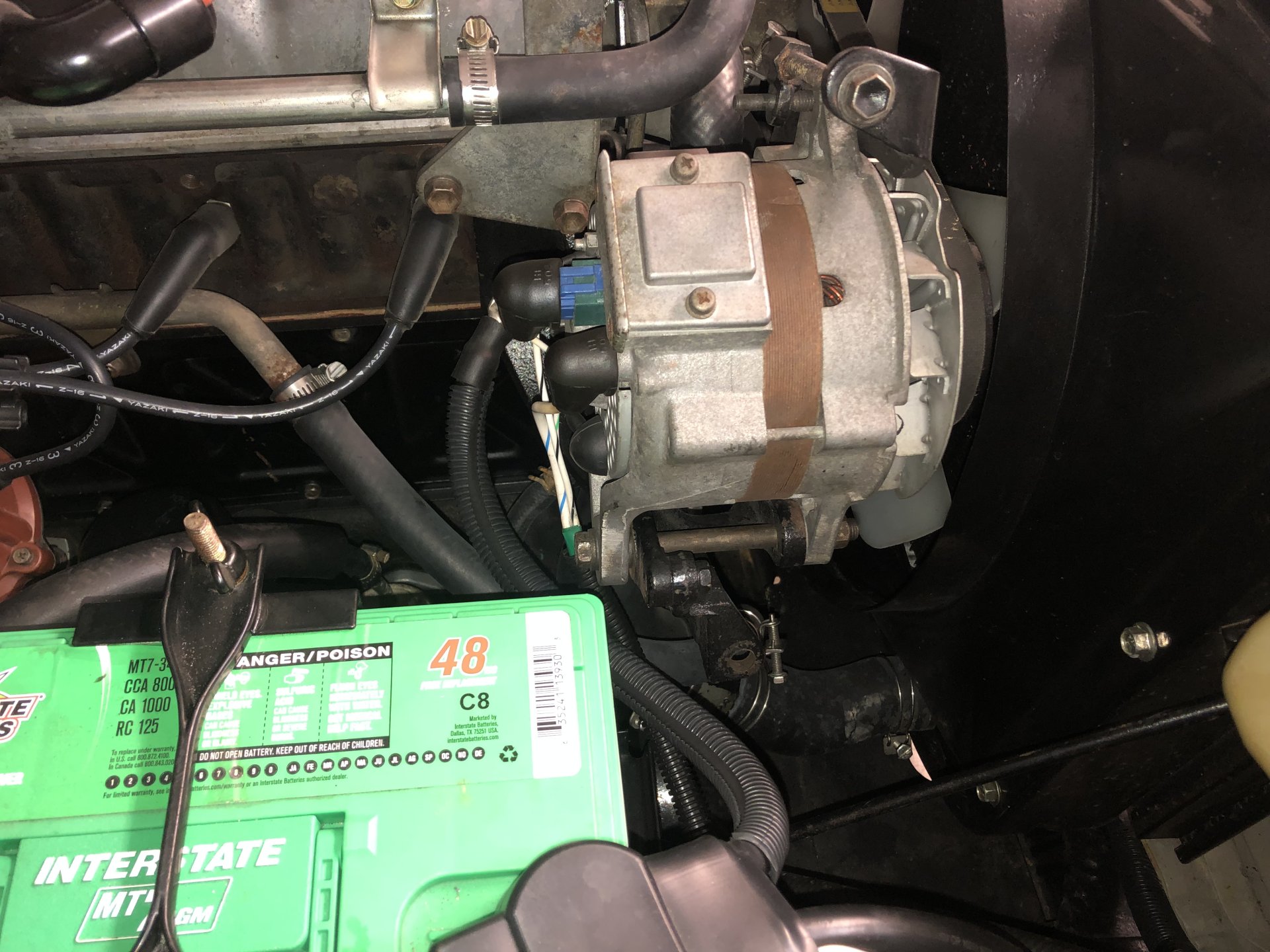

You might check for an alternator grounding issue. The alternator grounds through the mounting bracket, through the starter to frame ground strap, to the frame. A bad ground connection in any of those areas will cause issues. On Coolerman's recommendation, a few years ago I added a battery negative ground line direct to alternator bracket. It's not required if all the other ground area's are good, but its nice insurance. Photo below.
My first check would be to make sure you have a good alternator and battery grounding. If not make sure the alternator/bracket, the bracket/engine, the starter ground strap, and battery ground strap mating surfaces are all clean, rust free, and tight.
If you grounding is good, then the electrical guru's will need to jump in.

Regulator is part of the alternator just like picture above...not sure how to check it. Wouldn't bench test check for correct output voltage?
Nevermind, I see now yours is internally regulated other than our General Countries spec. You now need to ensure current can flow to the battery and also, that the sense system works to get current flowing. And always check grounding as stated above.
