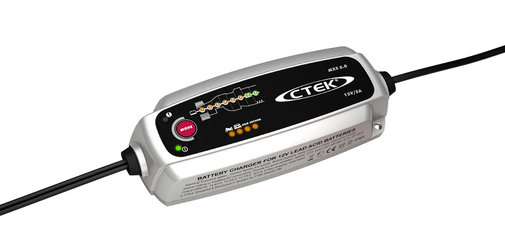

CTEK all the way - find them here: CTEK MXS 5.0
I've been using them for years with no problems.
HTH

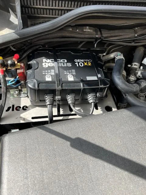

This NOCO has worked great for me on dual battery AGM's. It's bolted to Slee accessory mount. I connect an extension cord to connection under front bumper to top both off.

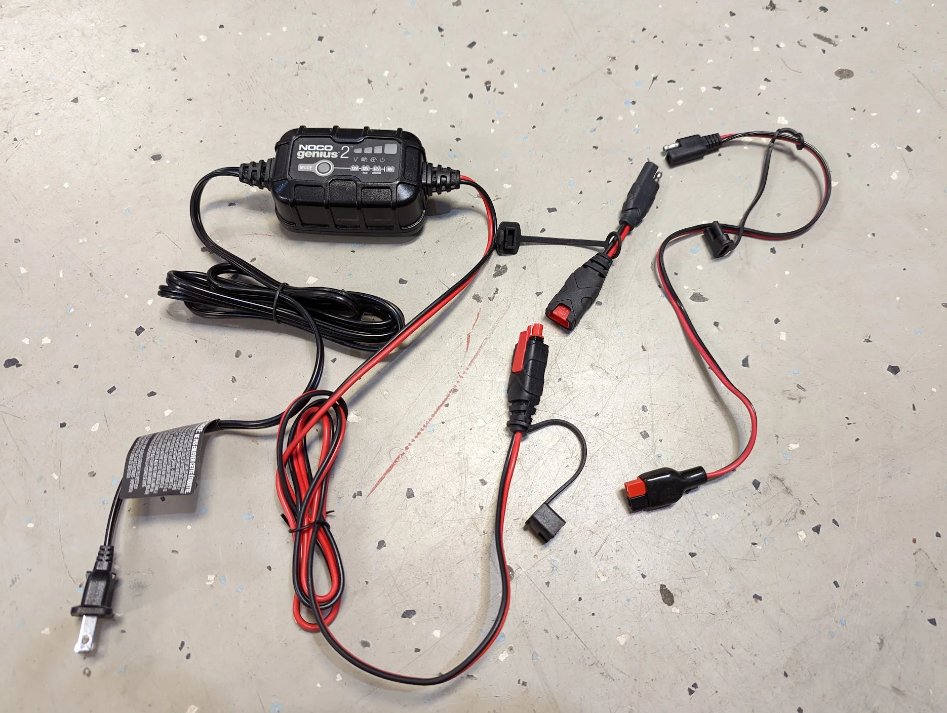

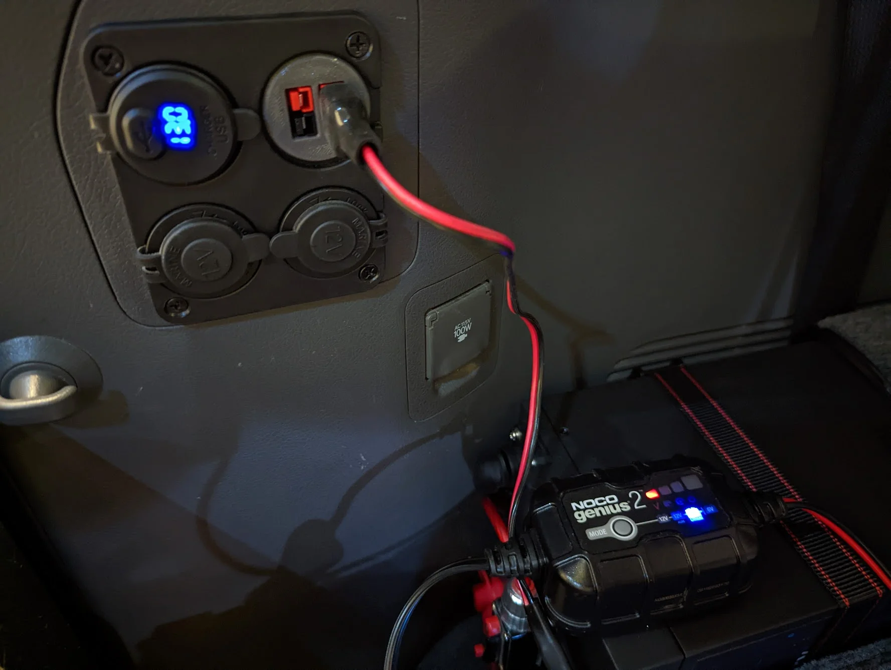

Part of what I don't love about Noco's is their proprietary connecter. I have SAE plugs installed on a couple cars for the tender. So I have the Noco SAE adapter. Just made another SAE to Anderson connecter, which should allow me to charge the new LiFePO4 house battery I just installed. Nice that the Noco can handle anything from flooded lead acid, to AGM, to Lithiums.
What's great about Anderson is I can just plug it into what would normally be an output port in the hatch area.

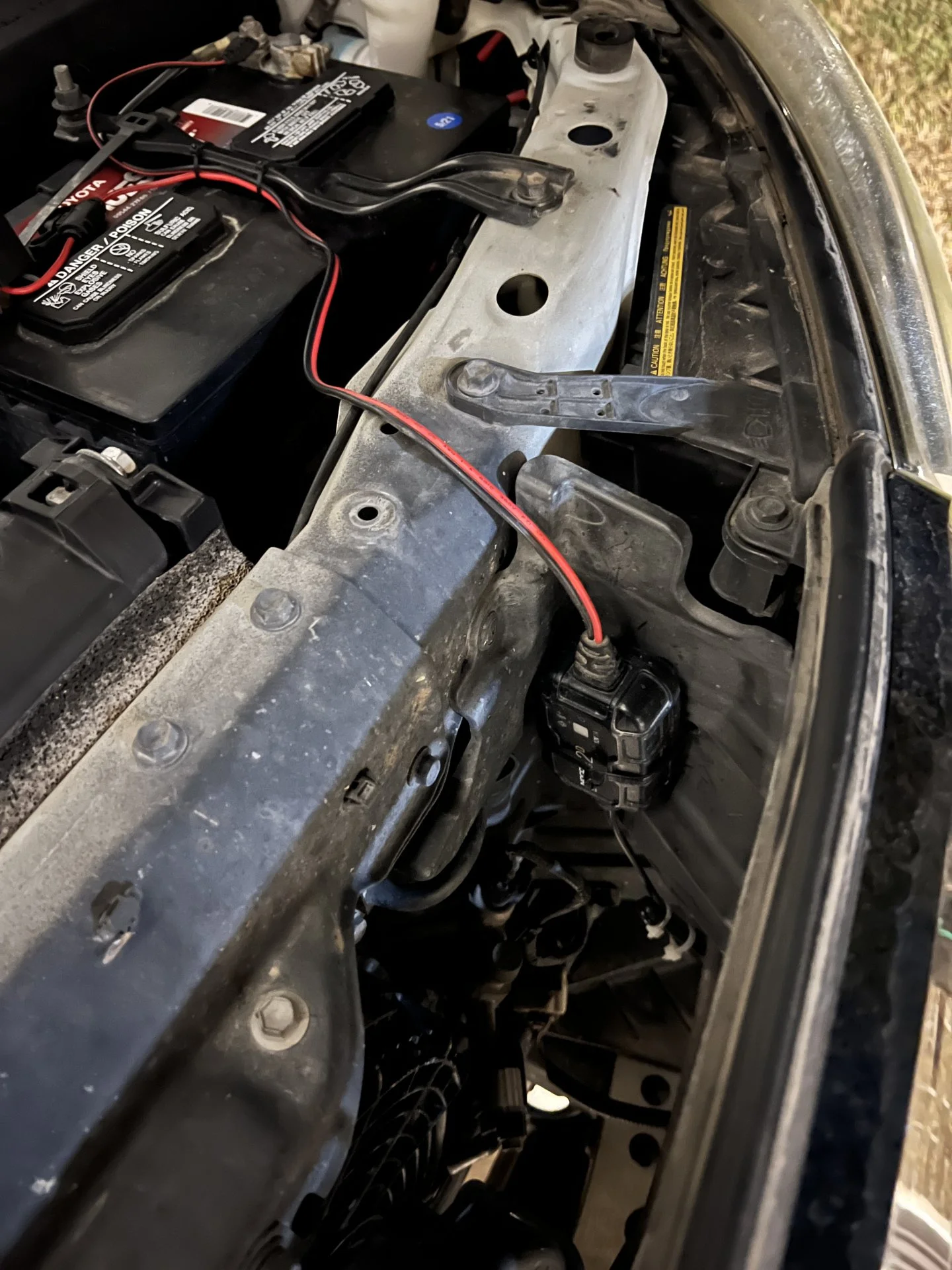

Another 2D fan here. Only had to drill two holes in plastic and install with zip ties, then one small relief cut under the core support plastic trim.
