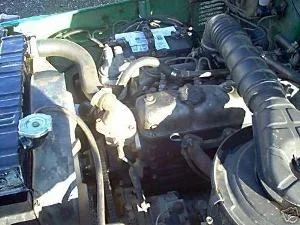

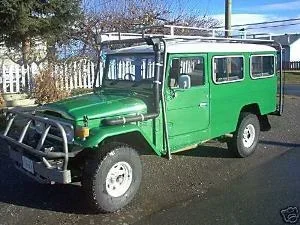

Hello, I posted over in Diesel parts but thought my questions were probably better suited here. I am looking at a 1982 HJ47 located in Canada. It came here from Aus. in 2006 and looks really clean. I dont know anything about diesels so at this point I am going on what the owner says and my experience with regular fuel cruisers....the engine is listed as a 4.0L...anyway to tell what engine it is? Reports 285,000 miles on the engine and recently says new radiator, block heater, and diesel injectors in last 3 months. Reports valves rattle but follows up with diesels are noisy anyway. Here is a picture of the rig and the engine. Any tips or advice on what to ask, look for appreciated. I am planning on using it for my full tiime work truck, or a similar rig if I dont get this one. Thanks!
Check the floor pans, check the inside rear corners, check the roof line (for rust)... The Ozzies have a way with concealing rust;)
While the 2H can last for a while, you could be looking at a rebuild or replacement in the near future... If an owner took care of the motor, you could get 400-600 k off the motor, but knowing it's from OZ, it could be ridden hard and put home wet...
Plan on a rebuild costing $1k per hole (6 holes, $6k)
It will be a dog loaded full of gear without a turbo. You can get a turbo kit from OZ for around $2500 CA. Don't turbo it without getting a compression check first.
A five speed would swap in with a little work. That would help on the highway.
When the motor dies I would contact Radd Cruisers or G&S for a 1HZ with a turbo.
Looks like the stock exhaust manifold is missing. Are they running headers on the motor?

It will have the 2H engine, 3980cc displacement. Standard compression pressure is 398 psi at 250 rpm, with 284 psi being the lower acceptable limit. there should be no more than 28 psi difference between cylinders. It should idle at 625-675 rpm.
When you look at the truck, check with your hand against the side of the engine block to see if the owner pre-warmed it up before you got there. From cold, normally a 15-30 second glow is required before starting. A puff of white or black smoke at starting is normal enough, but should dissipate quickly. Excess smoke, esp. when warm, is not good, though is not always a major deal.

Look very carefully for rust in the floorpan, esp. around where the front door pillars join the floor. The engine will be a bit noisier than a gasser. It will have 4-wheel drum brakes - you will want to pull the drums off and take a look inside. The parking brake is on the back of the tranfer, and it will have the H41 tranny, which is very desireable.
It will have the full floater rear axle, which is desireable as well.
Inspect the wiring loom to see if it has been significantly modified/hacked into. Odds are the fuse panel cover is missing. Check the fuse panel for cheesy s*** like cigarette foil bridging, etc.
The main thing with trucks from Australia (I have one myself) is whether they spent time at the beach or not. If so, they will have a lot of rust problems.

I am a bit gunshy with just the small amount of info you guys gleaned from the two photos i sent. He sent me a bunch of photos of the body, which looks great compared to the other cruisers i have purchased in the past. But as you well know, you just dont really know until you actually see it and touch it.

The body condition is very important - probably the primary value of the truck in fact. A recent repaint makes me suspicious, as 95% of the time there is stuff covered up that wasn't repaired properly. Looking closely at the body seams for rust bleed is one place to begin looking. The color is non-stock, as are the seats. The snorkel looks like a bunch of abs pipe glued together. The exhaust has been chopped as it should exit at the back of the truck and is probably non-stock. Lotsa non-stock stuff, from the few photos that i have seen. Why's that?
The engine, while very reliable, is quite expensive to rebuild and parts are not available at your local Toyota dealer, for the most part, so you need to assess its condition carefully. That truck has a lot of km's on it at 455,000 (fairly typical for an Australian rig), and the engine, if it has not been rebuilt, and lovingly cared for its whole life will be tired for sure, along with the tranny and transfer and mechanical parts. If the rad was recently replaced, then the condition of the heater core may be poor.

Thanks for the info on the price reduction. I'll let you know if I get Chris to come take a look at it. Based on the discussion above, are you aware of any modifications to the engine?

An Australian viewpoint .Open the glovebox lid and with a torch have a good look at the cowl seams .Put your hand up the inside of the A pillar and feel around as high as you can ,your looking for rust on the body seams .Do the same on both pillars .Shine a torch up above the pedal box area .PVC pipe on the rack may have been to store fishing rods .............surf rods......
If the owner can tell you what state it was last registered in ,in Australia ,will tell you what to look for .

The headers are nothing unusual over here .
