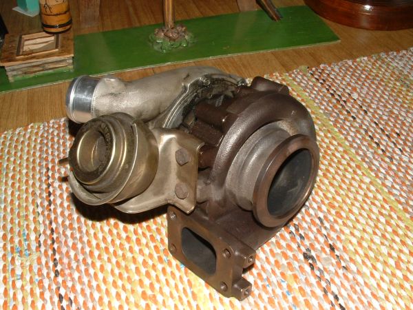

I have these few parts waiting to be installed to my 2LT2, turbo is Garrett GT2559V
Now I just have to find some time so i could install those and few else little parts.

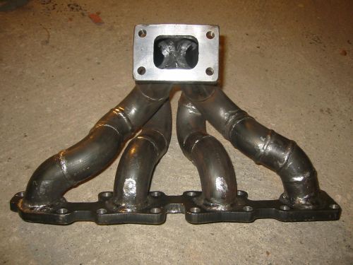

get a load of that exhaust manifold
SWEET .......
good luck mate
