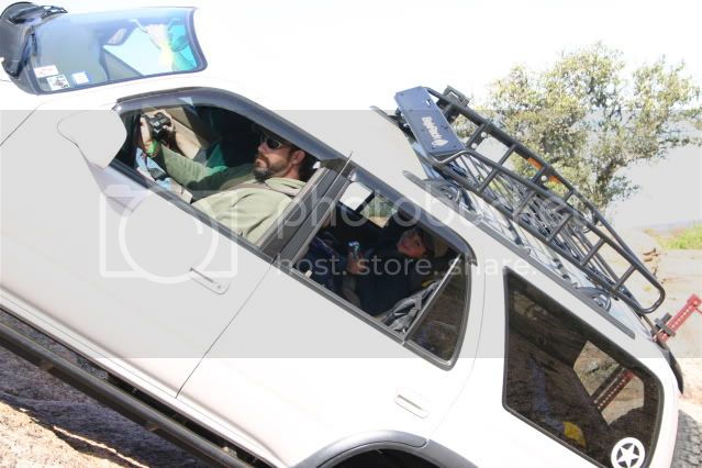

Anyway, I got a chance to visit with John at Baja Rack, and was informed of 4 offerings for the rig currently (Note: their web page has not been updated yet...call for specifics). The Mule, Mega Mule, and two just for the 3rd generation. Both 'Mule' racks fit onto the factory cross bars and set higher that the 3rd gen racks.
Here are a couple of photos of Jacque's rig with the mule...

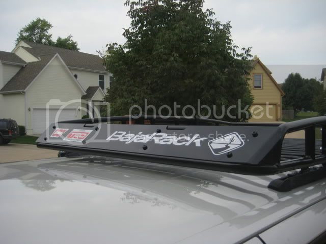

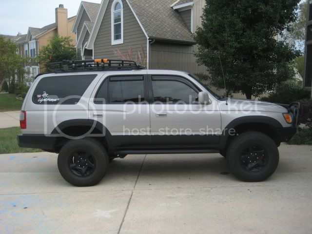

I went with the full rack as the trailer will get the RTT eventually. These new racks will retro fit into the factory rails and will sit considerably lower.

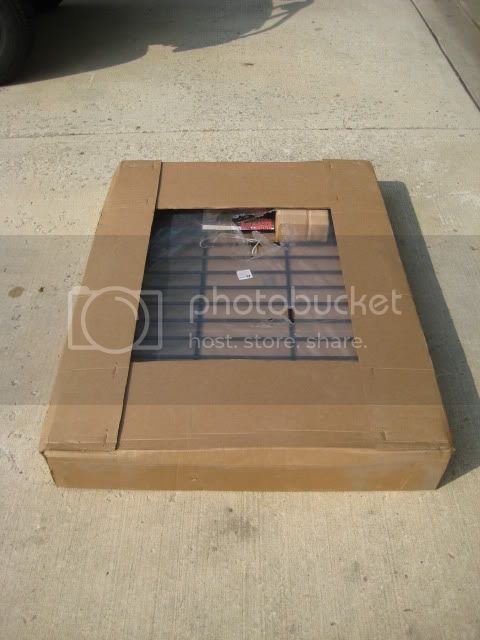

When my rack arrived, my initial impression is that it is light. I was able to hoist this unto the roof by myself due to it weighing under 52 pounds. The finish is durable, and looks good right out of the box. Comes with instructions, all of the mounting hardware, and a cargo net. It shipped as one piece...

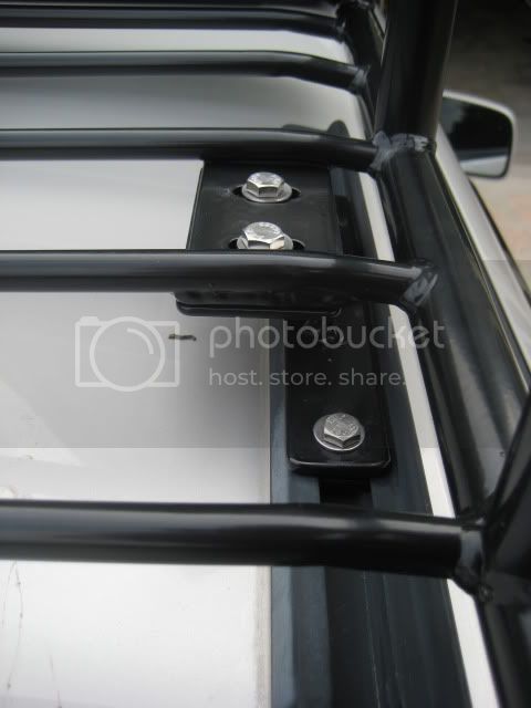

The rack bolts to feet that slide into the rails as such. Not seen is the foot that is in the rail itself...

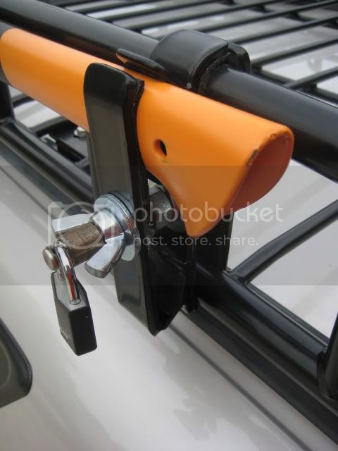

The accessories that I went with were the following: Hi lift jack mount and the axe / shovel mount...shovel will get here in two days...
There is a hole drilled in the mounting bolt that will allow a small padlock to lock the wingnut down. I found some steel spacers to prevent the wingnuts from loosening too much and slow the thieves down. Hopefully, they will see the effort needed to kipe (s.p.?) my goods and move on...
