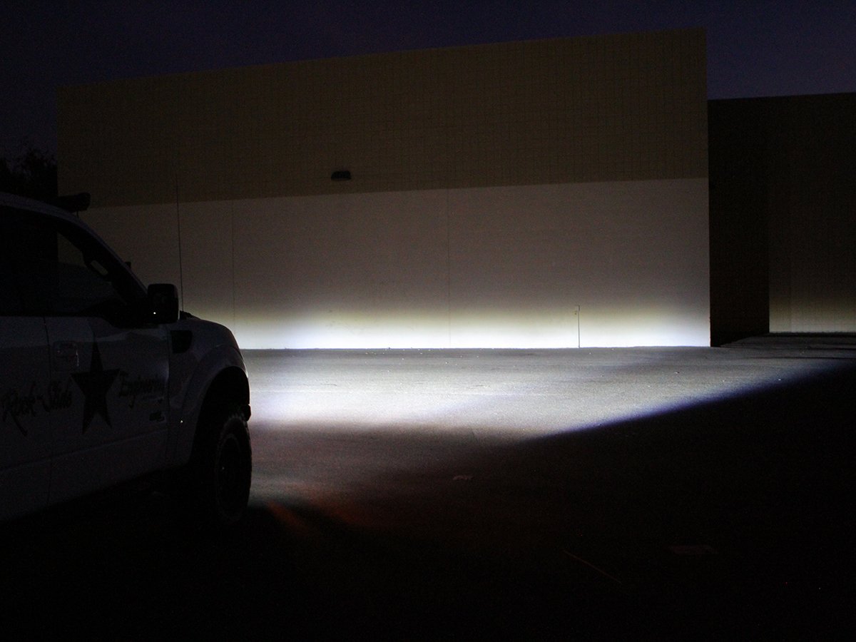

I have Rigid square fogs on my aftermarket bumper. They are SAE-compliant and waaaay better than the stock lights. This link from Amazon is pretty close to the truth. They have a nice sharp cut-off

BTW the Rigid fogs are waaaaaaay better than the Toyota ones. Bright, good cut-off, really light the road. And they're SAE-compliant housing so if "the man" stops you they're street legal (though you still need to aim them correctly of course).
