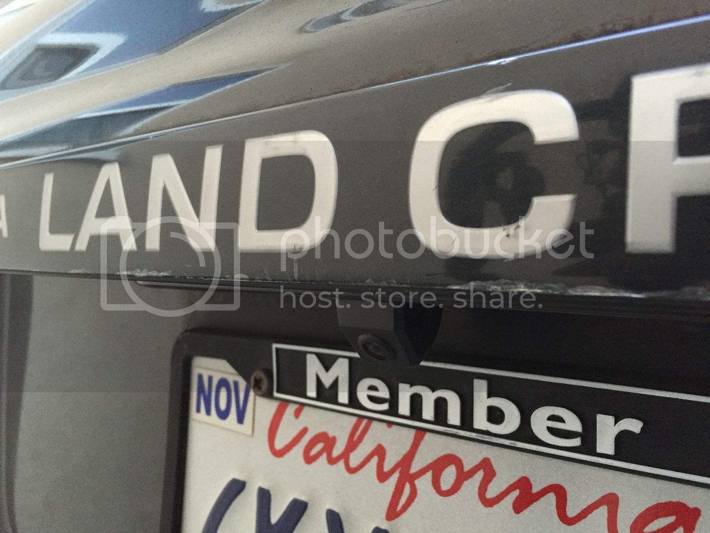

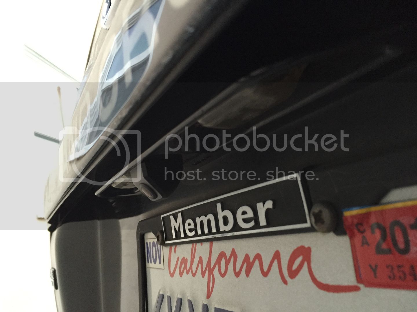

Got this - Front View Camera,Chuanganzhuo Universal Normal Image Car Reverse Backup Rear/Front View Camera For All Car,Black

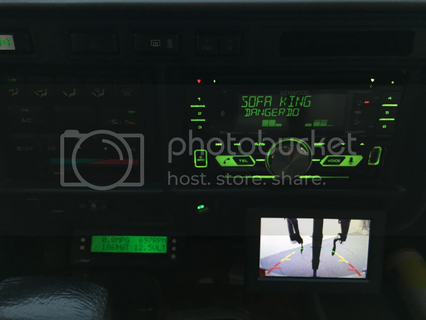

$15 on amazon. Works well. Using small monitor (which I replaced now with stereo monitor).
Installed backup cam and monitor.
