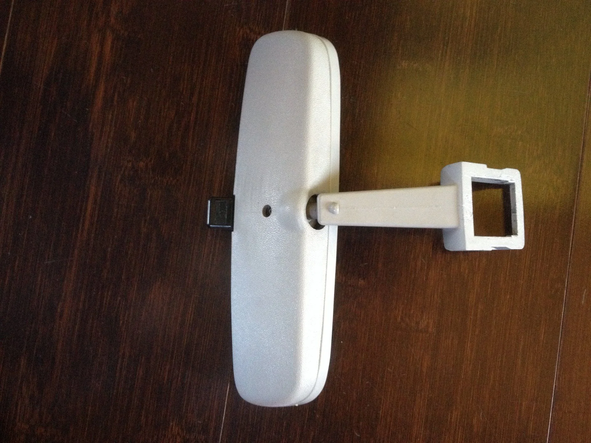

The current mirror on my 96 should look like this.
full
So I would need to buy the block from Wits End for the new Gentex back up camera mirror/
Can I buy this set up, and marry the Gentex to it?

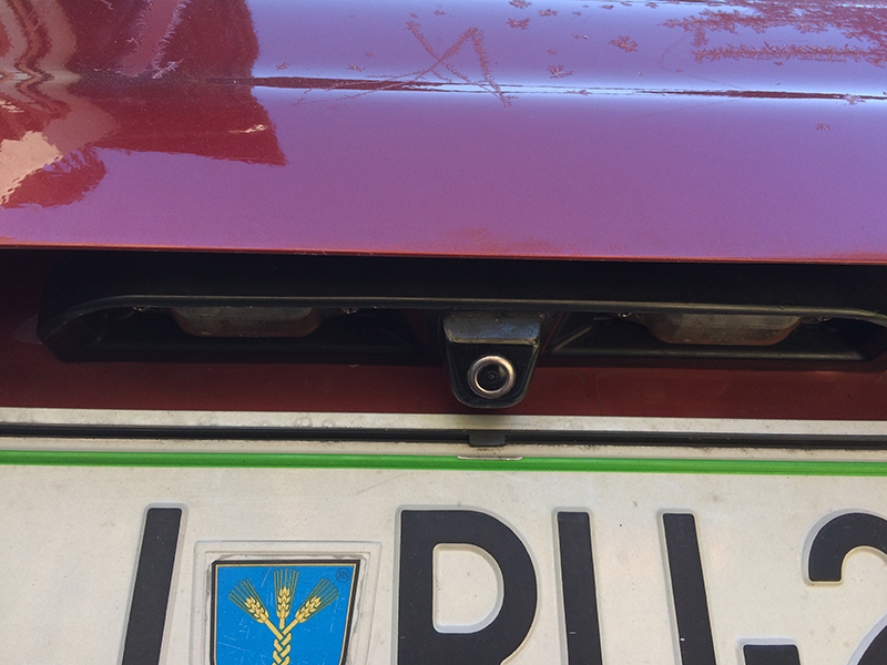

I would recommend mirror with bigger LCD. I've tested booth and (wide version with small LCD and taller version with much bigger LCD) and it makes quite big difference on visibility.
I have installed mirror like this:
7" LCD Mirror Monitor +Wireless Car Rear View Reverse Night Vision Backup#Camera | eBay

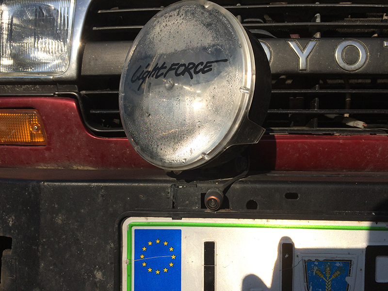

You can connect it to two cameras so I've installed front and rear cam.
Ya that set up looks pretty cool. Nice find. Does the clipped on mirror stick out alot? Doesn't look like it from the front pic.
Most need a 2-wire with RCA plugs that go from the camera to the display. Most of the other needed wire can be found at each end.
