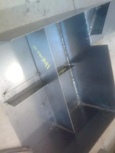

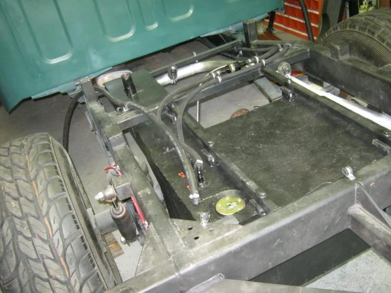

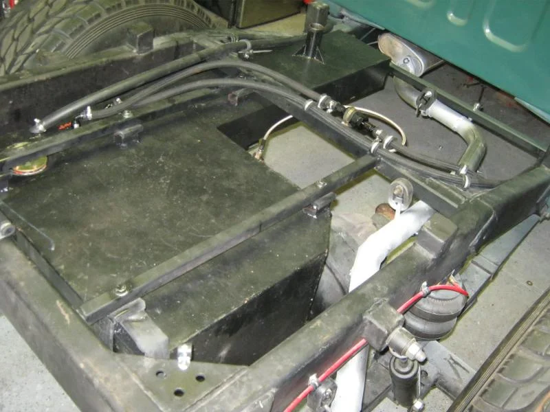

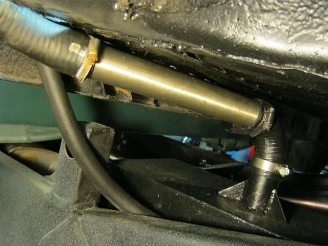

Here are a couple pics of the tank finished and installed.
I was going to TIG the tank, but I opted for MIG because is was faster, with more material. That, and 16 gauge was a breeze to weld. Unfortunately it is a little heavy.
I pressure tested it to about 5 PSI, with water in the tank. No leaks, but I was not sure.....
I spent the $70 ish dollars on a POR 15 tank sealer kit as insurance.
We will see...

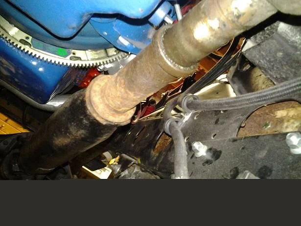

I actually finished the exhaust today. All is 2" in a single outlet.
There is not much room under there!

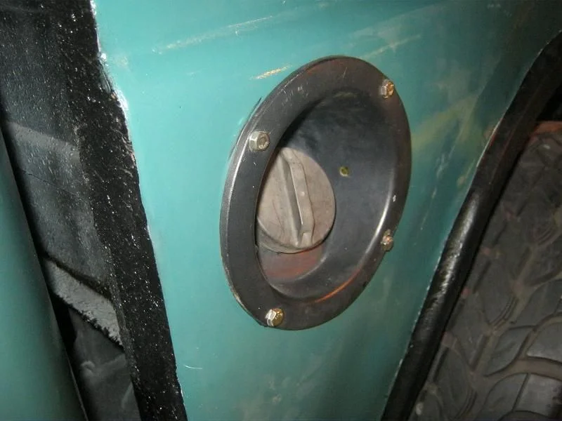

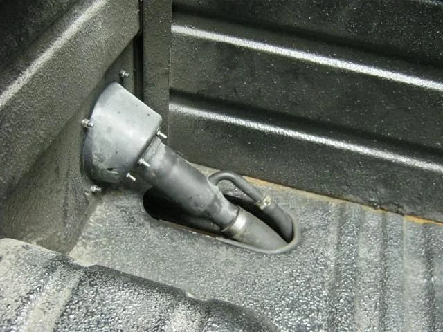

Here is the finished gas tank sitting in the truck.
Hopefully the cruiser gods are not angry, because I used a TJ filler neck on my 45 :p
It worked great and almost looks factory!
( That is a piece of stainless connecting the cut down TJ factory filler tube)

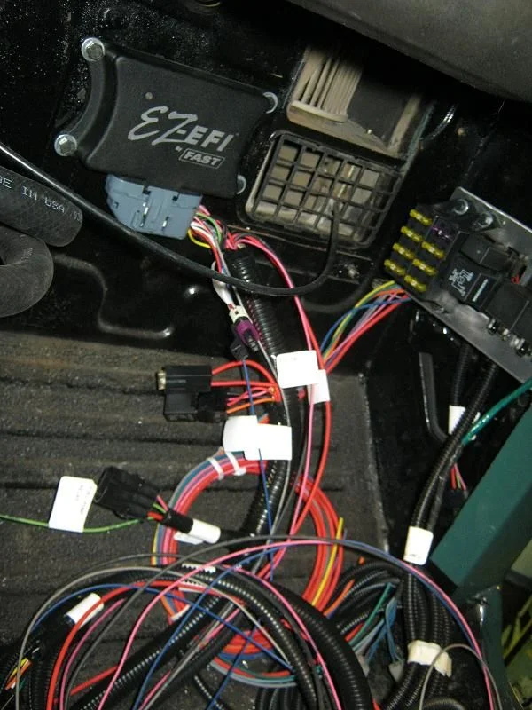

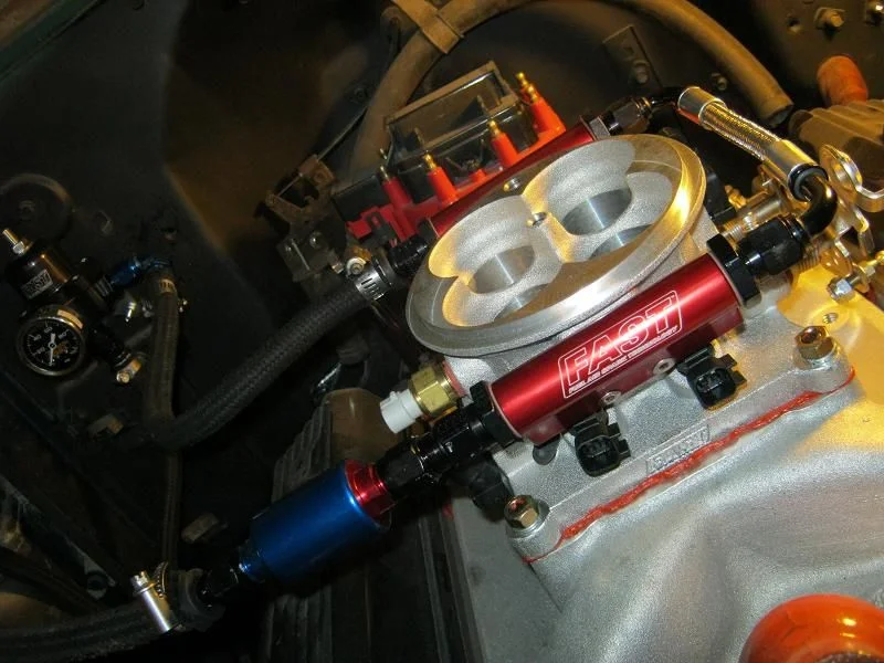

I bit the bullet and I ordered the Fast Fuel injection Master install kit.
EZ-EFI by FAST™ - The Easiest Way to Convert Your Carb to EFI
I ended up getting the Master kit for $1800 at an industry trade show, which was the price of the normal kit. I couldn't resist but my bank account really hurt after that :crybaby:
I also bought a Rebel wiring harness.... I am going to pull out all of the 40 + year old factory stuff.

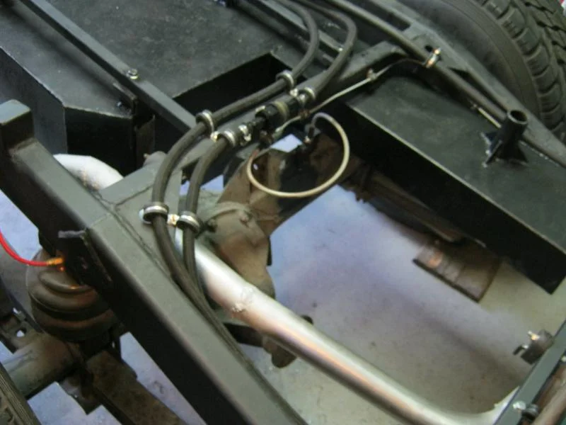

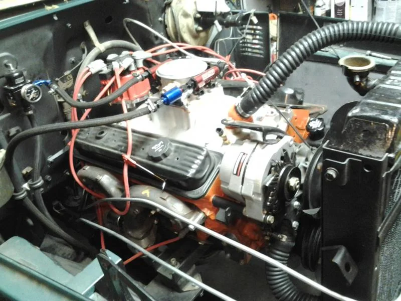

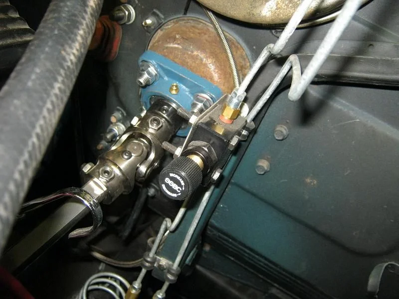

Here is an updated pic of the engine bay.
One wire alt, triple row pulley for AC, and PS pump installed.
NOTE: The plug wires are not going to live there forever :hhmm: I just threw them on.

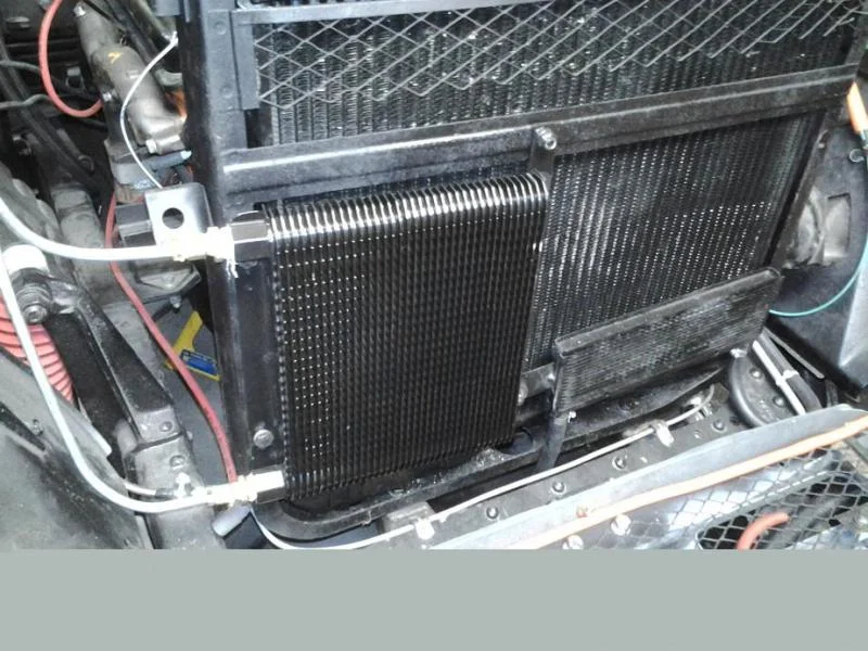

The rad is out of a BJ42.
The steering cooler is out of a 96 Ford Exploder.
The steering box is out of about the same vintage (96) GM 1500.
The high pressure line was out of a 1978 CJ with power steering. Only issue was that they require a bubble flair instead of the single flair. I hope it doesn't leak, but we will see.
As for the bonehead move of the last little while..... apparently B+M coolers are brittle as FAWK!
I go to tighten up the lines, and the "input" cracks instantly on the cooler. :S
The place I got it from ordered me another one free of charge. Not sure why this happened, but I was a little disappointed. I didn't heave on it or anything, almost felt like the factory attachment was faulty.
More pics when all lines are installed.

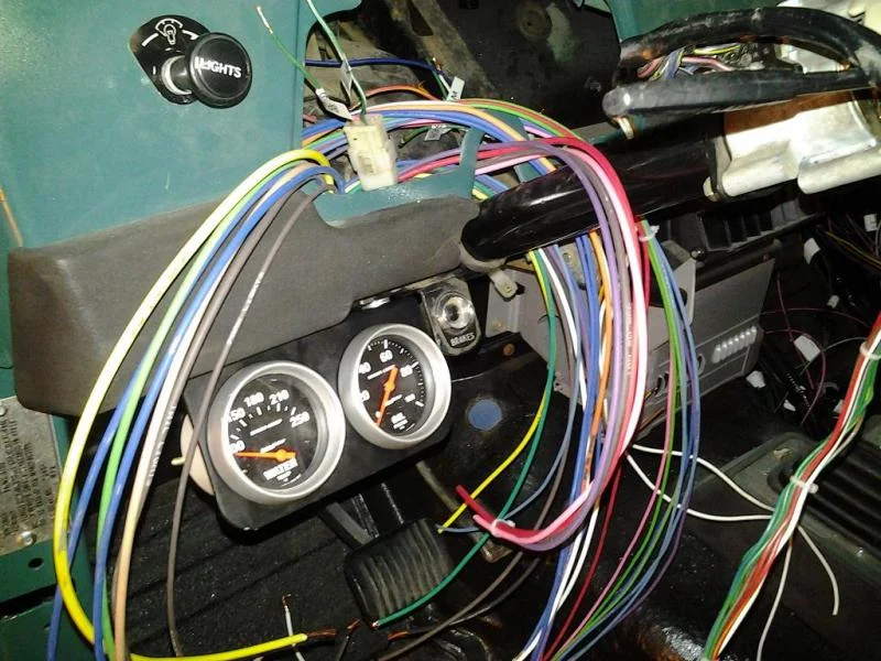

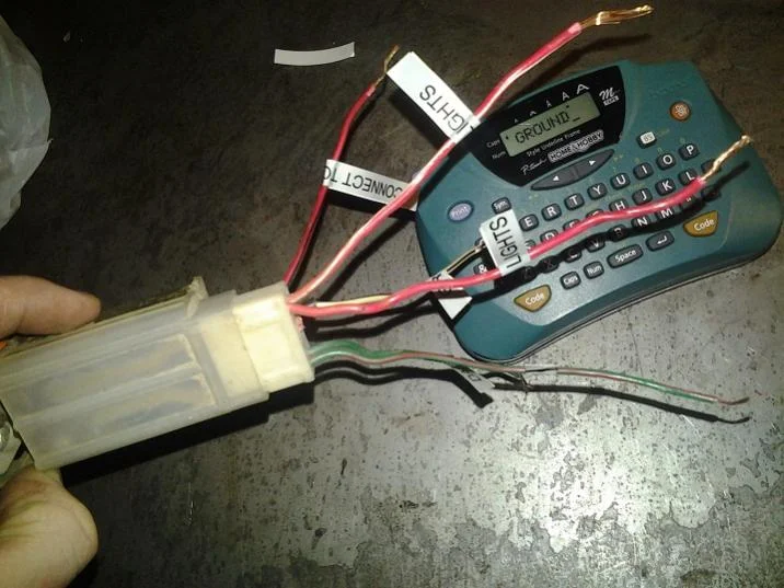

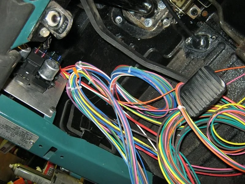

Although it doesn't look like I have accomplished that much... wiring takes forever!
I have most of the engine compartment finished, battery loosely installed under the drivers seat, and most of the major stuff figured out.
I still probably have a few months in this yet. I hate wiring :crybaby: but it is a necessary evil.

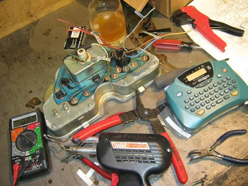

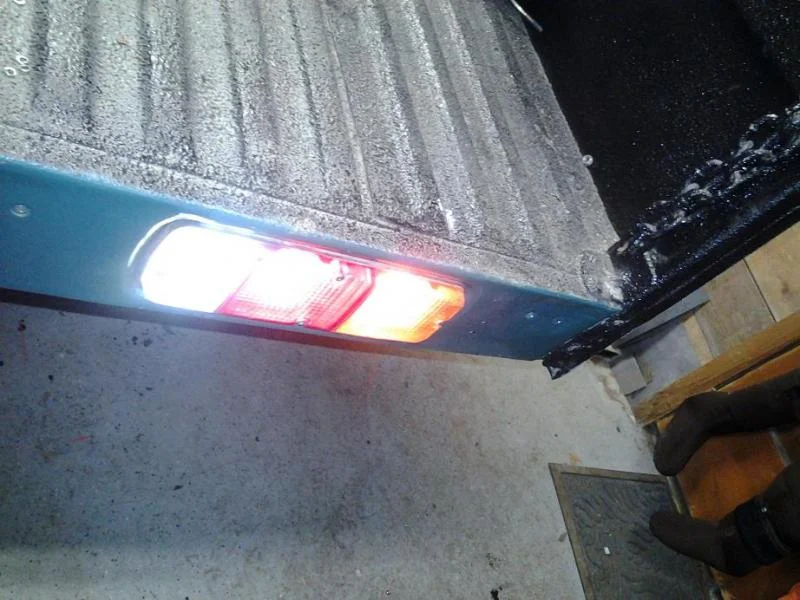

Here a some gauges I just figured out where to install.... and although you might say "ooooo lights" these took me better part of a week to drill the frame, solder, wire and loom. I used LEDs from www.superbrightleds.com.
I am very happy with them.
