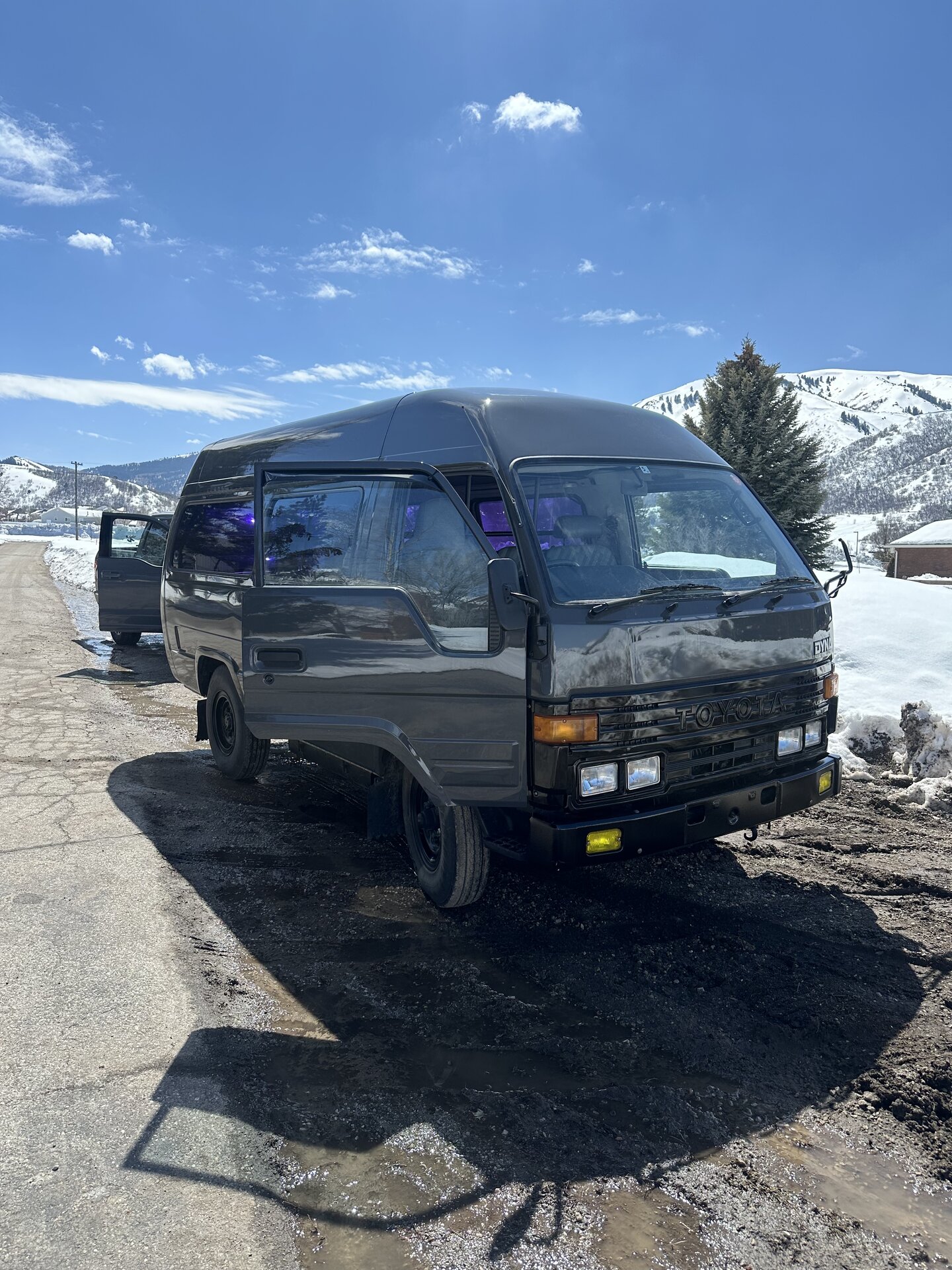

Bringing back an oldie. @Gengis what year is/was your mark ii b engine? I just picked up a 93 Dyna van with a b engine. Hoping to turbo mine. Did you ever get to this on yours? Thanks.
No, I never did the turbo, but if yours is a mark II then the 14B Turbo manifold fits like a glove and you are already half way there.
@Gengis thanks for the response after all this time. I have lots of questions. I’m familiar with L series motors, specifically the 2LT and 1KZTE and new to this motor.
Did you ever have any apprehension of turboing the B due to it being IDI? Thoughts on maybe modifying the precups(assuming the head has precups) for better injection? I’m weighing out the pros and cons of turboing my Dyna and the longevity of it. I would do new injectors, ARP studs, intercooler, and adjust the timing a few degrees. I’d likely keep boost under 10psi and keep an eye on EGTs. How does this approach sound to you?
Toyota themselves turbo a number of IDI engines so not to worry there. I would only replace head bolts if yours are TTY. the main thing about IDI with a turbo, and this comes up again and again, is the extra heat in the head, so an intercooler and perfectly running cooling system is a must. Vans, like yours have cool air flow restrictions and space constraints. So you have some work to do. Think of water to air intercoolers and get a nice shot of cool air to the intake ( snorkel). Do a search on turboing the HZ motor, which is also IDI. They do not seem to touch the pre-cups, and push heavily for intercoooling. Don't fret about the boost pressure if you watch the egt's properly.
It's heat ( cooling and EGT) that will kill your engine, not boost. Oh ,and your right foot.
@Gengis makes a ton of sense. I have both a 2.4 2lte and a 3.0 1lzkte in my surfs at the moment. I am very familiar with the head heating issues. Seems like as long as we stick to the basics and get gauges set up to monitor, we should be good. Thanks for chiming in after all this time!
Out of curiosity, where were you going to run your oil supply from?
