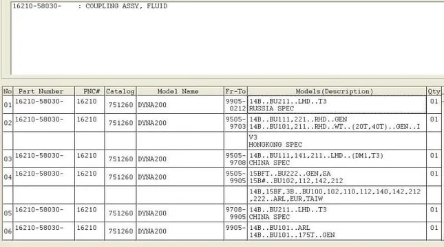

Here's the full printout in case you're going to search for this part at a motor wreckers over there:
