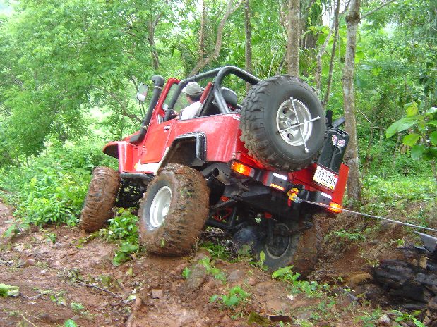

14B is a great engine .. this rig
after 350 chevy conversion, it has a 14B engine mated to a H42 tranny with out problems.

I thought is a great upgrade .. in the red 40 show above, he was the 14B engine a lots of years .. with 0 ( big 0 ) engine problems, no vaccum and no power stering issues. Running 37" boggers, full locked rig with 4.88 on the axles.
