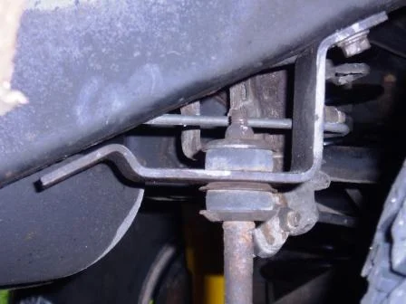

Broken nut:
The nut inside the frame holding the rear sway bar bracket to the frame is gone. Now I have 2 holes with no way to connect them. Is there a do-hickie available that works like a "toggle bolt" in the house?

For your swaybar bracket, since I think the frame is fully boxed in that area, you really can't get in there to weld on a new nut inside. But you could possibly weld on a nut on the outside and then bend the sway bar bracket to account for the space of the nut. Then screw the bracket back on. Other options are just welding the bracket onto the frame, or tapping out the hole -- however I'm not recommending this because I don't know enough about engineering and the forces involved to know if it's 100% safe.

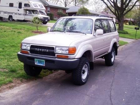

Man-e-fre~$720. Needed springs and shocks badly (15 years, 210k miles).
BFG 31dia x 10.5w I think? All Terrain A/T LT
Sweet: Only reason I kept it was it's toughness (made it through 2 years of teenager) and body/interior still looks good (most expensive things).

broken nut: frame is boxed, but rubber grommet close. I'll try to manuever a bolt to the hole inside the frame. If that doesn't work, will try to find a u-bolt to put around the frame, if can't find one, I'll do a hillbilly fix with hose clamps.

When trying to extract a broken bolt, don't try to hammer the bolt extractor into the broken bolt to where it "sticks" in there. You'll bust the nut into your frame (see broken nut):doh: .

For the broken bolt; try this. Put a center punch in as nearly as possible to the exact center of it as you can. Then beat the holy livin' hell out of it with a BFH! The percussion may break up the rust enough to loosen the threads. Drill out the center of the bolt with a small bit. If you are lucky, the bolt might spin out with the drill. If not, then drill a larger hole thru the bolt. Then beat the hell out of it again and try an easy-out, but don't get it stuck or break it off! If that doesn't work, then drill again to the proper size and tap a new thread.
Patience is key here.
St. Charles, Jim: Just got back from Reelfoot. Bad fishing! Never been skunked before there, but ate bluegill and drum last night. On Thursday night, May 3rd, we're all meeting up at Sybergs in south city. I don't know anyone, but should be there. You should come.
Macgyver: DON'T BEAT IT TOO HARD OR IT'LL END UP IN YOUR BOXED IN FRAME LIKE MINE!
