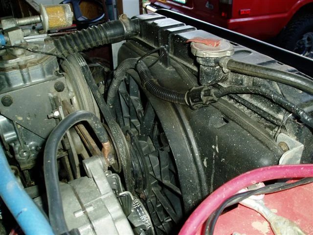

Taurus fan fixed mine...fit like a champ with only minor trimming. Really dig the amp needle being pegged when it kicks on too. Let's you know something is happening up there. That and the squirrels being sucked out of the trees and into your grill.
Jun 15, 2005
1,486
SoCal - westsiiiide
nice to finally see an install photo of the Taurus fan I've read a ton about.... but I am sticking to my story about just wanting an 'auxillary' fan setup (though I doubt it is going to happen given the lack of room).
