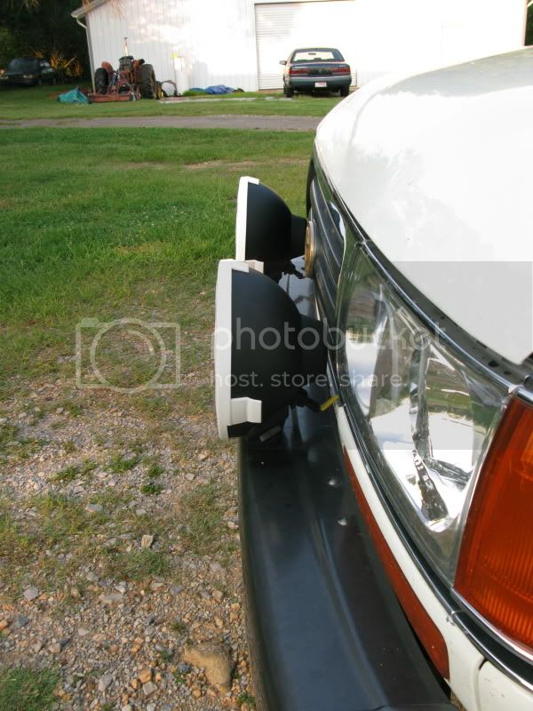

I wanted to fit big Hella 4000 Luminators but they were too deep to just bolt straight onto the stock bumper.
Just went for the easy option of bolting a small strip of steel onto the bumper and bolting the lamps to that. Thought they would vibrate like crazy but 3 years on with no issues. Just use a decent thickness of steel strip.

^ hella 4k's fit just fine on my 95+ bumper
Thats strange! I wonder if they've either changed the lights or the later bumper is deeper...
I'll take a better photo of mine when the gf brings the truck back.
I've sure even now with the small brackets the rear of the lamps is still pretty close to the grill. :confused:

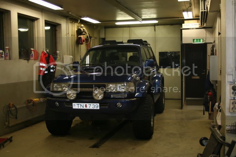

I also have my Hella 4000 bolted to the bumper. I had to mod them to fit because the bumper is to close to the grill.
What I did was drilling two new mounting holes above the original holes in the light housing. Then the lights go a bit further from the grill and lower closer to the bumper.

Very nice step - what beam pattern are you using? I have Hella 500's but am thinking of going to the larger diameter light for more output.
I guess I´m using what you call "Euro" beam. Here Hella offers three patterns, spot, driving and fog. I´m using the driving beam with 6000K HID kit. I used to have the spot lights, but then I had a little accident and broke both the lights. Then I bought the driving beam and I like them a lot better.
