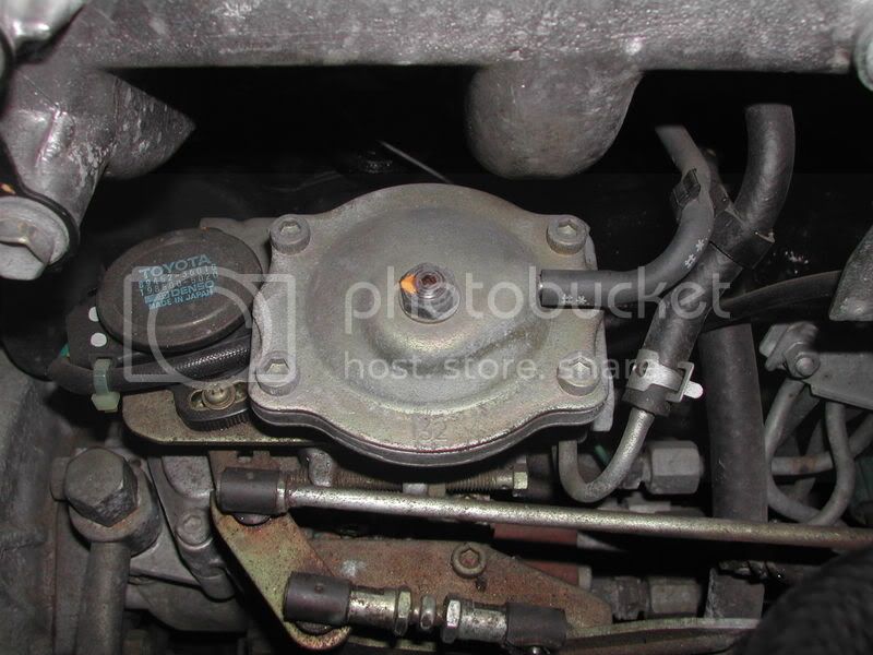

Ok so which way do i adjust the tps, i have marked the position of the tps so it can go back to the same place if it all goes pear shaped & i know it's very sensitive.
Joinerman
Forgot to say i know it's the thing with toyota written on it not the yellow allen key, i am going to unscrew the phillips screw and adjust but which way?

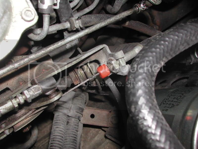

Check the kickdown cable adjustment as well. There is a FAQ in the 80 section I believe.

Checked kickdown cable today & adjusted up, there's nearly 10mm gap between the orange rubber gaiter & the crimp on the cable but the slip has gone, it drives great now thanks to you guys.
