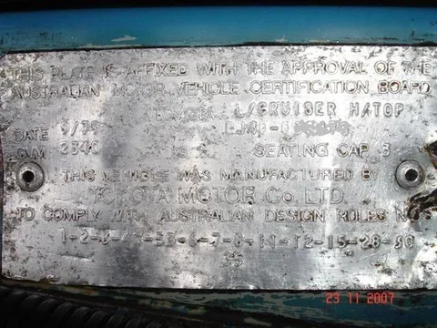

I have a discussion topic regarding compliance plate on an Australian BJ42. I have owned this vehicle for over 7 years and can never recall seeing the plate stating which Australian Design Rules the vehicle complies with. I have owned another BJ42 (1982) which had this plate fitted but my 1983 model has no obvious holes in the firewall where the plate should have been. My vehicle has the identification plate which identifies engine, transmission colour and trim specs.
Can anyone shed some light on the following
1. Were the compliance plates in a different location on the 1983 models.
2. Is there any chance my vehicle was never fitted with such plate.
I have attached a picture of what the plate looks like.
Any help appreciated.

Have a look on the inside of the front guard, that's where it's located on some '81-'82 models. My '81 FJ 45 has it on the passenger side inside front guard. Of course, if someone has changed front guards and not noticed, you're outta luck.

Not a bj42, but my '77 Australian import fj40 has the Australian compliance plate on the bulkhead above the heater blower. The VIN plate is on the inner fender [mudguard] below the battery which is on the drivers side [RHD] and all original. The compliance plate is riveted with 2 rivets and the VIN plate is screwed in place with 2 screws with one hole in the plate being slotted.
You didn't have trouble getting it through Regency with no plate when you brought it down from NT? If you get caught in a random safety inspection you may need to do some quick taking.
One of my mates in Adelaide had an ex-RAAF 47 and had a hard time getting a compliance plate for it. He took it back and forth to Regency about half a dozen times before he decided to part it out. He bought a rooted 47 with a plate and 'put everything on it'..... You can guess what parts went on which, but suffice to say that most of the RAAF rig can be seen on the Port Expressway most rush hours.
My 84 has the plate on the bulkhead as well, as has every other Aussie Cruiser I've had. I believe the Act specifies where the plate must be so that the Coppers don't have to search for it when doing safety stops.
I meant to reply to this thread earlier but didn't get aroudn to taking a picture. I can confirm that my VIN plate (75 HJ45) is located on the drivers side fender (RHD) directly besides the battery. No holes on the firewall, so I will have to check the bulkhead inside the cab for the compliance plate.

I can confirm that my ex army HJ47 has does not have a compliance plate. I recently had this bought into question when I registered it in NSW, I was told by the maratime and roads technical department that it could be registered without one provided it had been registered in another state for 2 or more years or if it had been registered in NSW previously, (it had been registered in VIC since 1998). I have also been told by a mate who works in Vehicle imports in Canberra, that a compliance plate is only mandatory on vehicles imported post 1989. It could be argued that as this is a federal requirement that it should apply to the states as well. In any case this is not a mandatory requirement in NSW.
Here's mine:
It was on my LH inner mudguard facing vertical near my battery. (On the flat surface above where the plate is in twoH's photo.)
I removed it and welded over the holes when I repainted that guard.
The way the Aussi authorities had fitted it was extreeeeemly rough with the pop-rivet holes clearly having been hammered through the sheetmetal (rather than drilled) because there were deep indentations around them.

My father in law bought his hj47 troopy from BHP in 1985 and struggled to find one of the compliance plates. While giving the troopy a vacuum today, I pulled up the floor matting on the drivers side and found it under the seat. It's stamped "L/Cruiser Bus" with no seating capacity marked.
