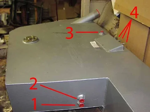

The directions that came with my Aussie tank don't even talk about connections and since my FJ40 didn't have a fuel tank in it when I got it, I could really use some advice here.
#1, #2, & #3 are all threaded bungs. #4 is three small tubes with no threads.
My best guess is #1 is engine supply. #2 is the return line. #3 could go to the vent line in the filler neck. Are those correct? And what should I be doing with the three small tubes labled #4? Cap them off?
For info, this tank is feeding a fuel injected CSB. (GenIII Vortec). It will have a frame mounted fuel pump and filter.
#1 Is The Return, #2 Is The Engine Feed Line. #3 Is The Ouer Flow For The Filler Neck And #4 Are Vents That Go To To The Vent Box Below The Body Filler Neck. I Put Mine In Back In Feb. And You Are Right The Directions Were Very Vague. But You Will Love Iy . I Know I Do.

Thanks for the reply. I don't think I have a vent box... and I definitely don't know what it is. :D Can you describe it or post a photo? For info, my FJ40 is a 1966.
The three vents go to the vapor recovery box that then bleeds off the tank pressure through the emission control system. It basically feeds the gas fumes into the carburetor so that tank pressure and vehicle emissions will be minimized. If you need a photo of one, let me know.

Hmmm... anyone know how to make it work with a fuel injected CSB? I guess I"ll be capping off those tubes for now.
I am installing one in a 1962 FST 40 that is getting a Ramjet...
I am just going to cap them off.

As long as #3 works for venting the tank on the filler neck, you will be good to go. I think it's safe to assume that the mfgr wanted as MANY vehicles covered as possible, which is why they included the #4 bungs on all the tanks. That particular bung configuration matches the factory vapor separator hookups found on 73-78 cruisers [and some mid-year 72's for you whiners]

If at all possible you should use the fuel vapor seperator. I just installed a '97 vortec with this long range fuel tank and installed the fuel vapor seperator very easily. I have read way too many posts out here talking about fuel vapor smell and pressure in the tank and all that stuff to not set it up this way. I now have no issues and no smells. My 40 never smells like gas and my garage never smells like gas (unlike my neighbor's garage from his bronco). Here is a diagram of the system. Part 45 is a plastic part with three small canisters, for you fuel to expand into, that goes under a metal cover shown in a previous reply. The three ports (#4) go into the bottom of part 45. There is then a nipple at the top of part 45 which goes forward to the engine compartment and plugs into the purge (charcoal) canister. The purge canister then has a vent open to the atmoshpere and a vent with a line that goes to the intake manifold through the Purge Canister Vacuum Switch so that the vapors can be burned. Fuel will expand a lot with tempurature changes. If you have a full tank and no where for that fuel to expand to you are asking for trouble. If all you use is the port back up to the filler neck the tank will fill fine but the fuel still has no place to expand to when the tank is full. You can try to use a vented filler cap but then you will smell gas in your garage - especially on warm days. My cruiser did not have the system when I got it and it used to swoosh when I opened my filler neck because of pressure build up. I posted for one out here and found one for like 30 - 50 bucks and it was well worth it. If the pressure builds up too much it can actually force fuel into the engine and cause you some real issues with hydro lock. that is unusual but I read about that happening to someone out here.

Caping off #4( all 3) is going to depend on your gas cap. If the only vent is #3 then the cap should be of the positive locking type that blows the pressure at a certain lbs. Or you may have the stock cruiser cap that just lets air out and fuel to if you are sidehilling or twisted up. I put a filler from a late model dodge pu on ( 3 hole mount ) but the blow off spring lbs was a little to hi cause every time you opened cap it blew like a whale. So I ran 1 of the seperator lines to a cage top breather.
