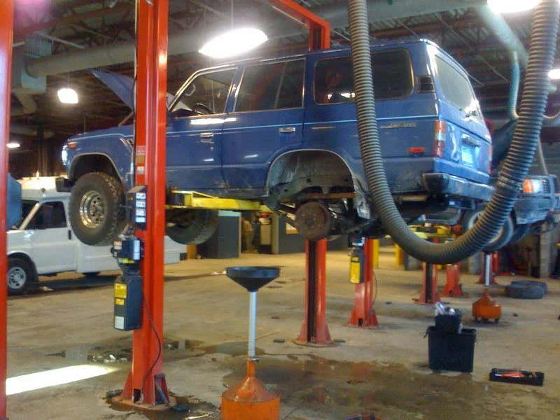

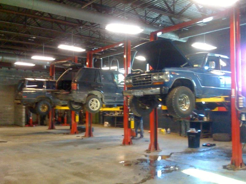

I thought I would share some of the install pictures. When I got to the shop there was another 62 there on the other lift next to a range rover. turns out the other guy wasn't on Mud yet, but I'm sure he will be soon. It's kinda funny because the 62 he just got was the one I was going to buy when I started shopping for mine last September.
The shop is the autocrafts center at Fort Drum. I pay $2.50 an hour for shop time. Let the drooling begin.
Pic 1 is the three trucks
Pic 2 is inside the rear diff
Pic 3 is the other side of the truck

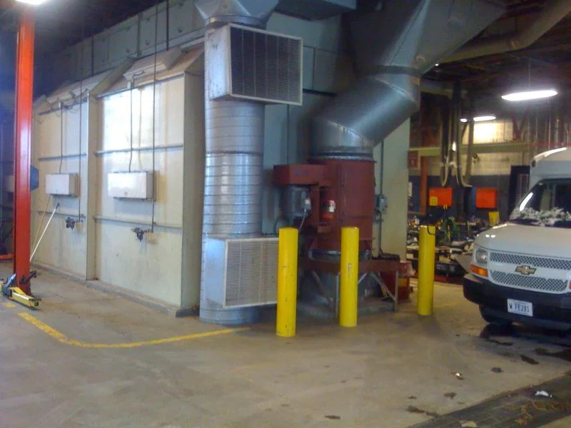

Here are some more pics.
1)The other end of the shop and the tool room (with tire machines, parts cleaners, and Bill)
2)Is the drive in paint booth
3) another shot on the lift.
