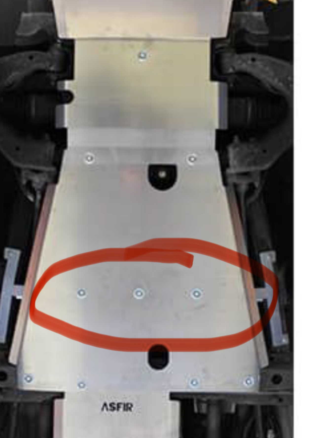

Resurrecting an old thread. Does anyone recall having issues with the transmission plate with a diff drop? The 3 holes circled appear to have a 1-1.5” gap requiring spacers. I tried searching this issue , but haven’t seen anything.
Also. Way late, but thanks for info above. I have WK sliders coming next week.
