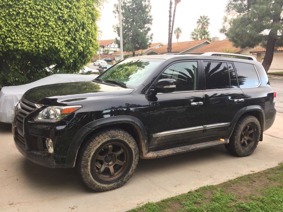

would the 0 offset from the volks cause issues running the with this tire package? Be it rubbing, degradation of hub parts, improper scrub radius, etc? Would the 0 offset actually be a plus in some ways?
photos are from google but probably belong to a member here

You’ll have to deal with massaging your fender liner to get rid of rubbing at that offset.
Being big into wheels and modding in the import days with sports sedans, I have a thing for OG and JDM wheels. I've had many sets and brands of wheels, including higher end forged 3-piece Volk wheel, using them for track days. For track, there's nothing like being on a set of uber lightweight wheel for performance. Perhaps at a trade to strength and durability however as I've bent a few in my days. What they provide in style, street cred, and performance, they do give up something. Not just Volk, but the is true for other high end wheels like OZ Superleggeras that I've run hard.
Zero offset is going to be the big issue no matter what size tire you'll run. It's just way outside the parameters of the suspension. There's at least one individual who liked the initial turn-in feel, but I can pretty much guarantee there's going to be trades. And not good ones to other dynamic qualities including lower ultimate cornering traction, pull on the steering affecting drivability and fatigue on long trips, durability to bearings and the steering rack, sensitivity to alignment, and more. Physical fitment is also an issue. It's going to cause interference issues where there would be none. Fender lip, splash guards, and possibly body mount.

I've run zero-offset Methods with 285/75r17 Toyo AT3s and OEM front coil spacers for about 5000 miles. After an alignment, the road manners are excellent, almost indistinguishable from stock. Before the alignment and spacers it was a little squirrelly (long-drive fatigue for sure). Some strategic shaping and of the wheel well plastics was required, but on and off road now I don't get any rubbing with the stock suspension. I would say that zero offset would not be the deal killer if you're willing to slice and dice a little.

I run +1 offset (Fuel Beast 18x9 +1mm) with BFG K02 305/65's. Definitely required some trimming (some metal too) but no drivability issues. I like the way it looks, however with aggressive offroading I think I would drive the tires into the fenders. That was a definite novice oversight. Next time around, I would go with less offset (like 25-35 mm).

I run zero offset on 2 of my rigs and wheel them both hard, lots of advantages in my opinion. Tires stick out past the fenders and allow for way better use of sidewall and minimize damage to your fenders and getting hung up. Wider track width for more stability offroad. More clearance at your UCA, frame, KDSS bar etc... I've run offsets from 60 to 35 to 20 to zero, all had benefits and drawbacks IMO... I've run 33x12.50's on 35mm offset and they they rubbed, I've run 285/70 R18's on 20mm offset and they rubbed, I now run zero offset with 35x12.50's and if I didn't add the Timbren bumpstops they would def rub. Lots of advantages to different offsets and also depends on what you are going to do with the rig, your expectations etc.. Anyone who tells you there is some magic offset and you can run big tires without sorting out fender liners, bumpstops etc is not pushing their rig very hard, just saying🤪 I beat the hell out of my rigs and this formula just works!

I have an HE and run 275/70/18 Toyo AT3s on1" Bora Spacers. Required some massaging of the fender liner and trimming of the front mud flap
