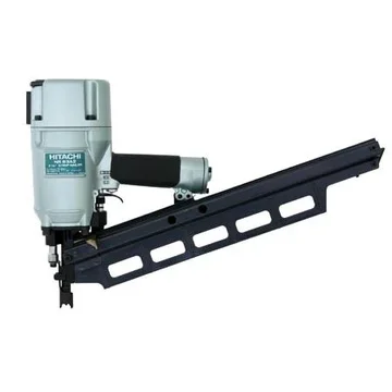

Here's the same model framing hammer I have. ;) $150 on my local CL, and I can have an el cheapo hammer and crowbars for demo. I bought enough nails for life......
Just looked again for kicks......here's another one for $150.
Hitachi Clipped Head Framing Nailer
I have the red max series framers, but they are a tad bit more money than the Hitachis
I'm with bigndn. Hammers are for destruction, not construction.
You need to make sure the clipped head nails are okay for construction. Some codes do not allow the use of clipped head nails.
I would use a nail gun when possible to save time and shoulder/elbow joints.
