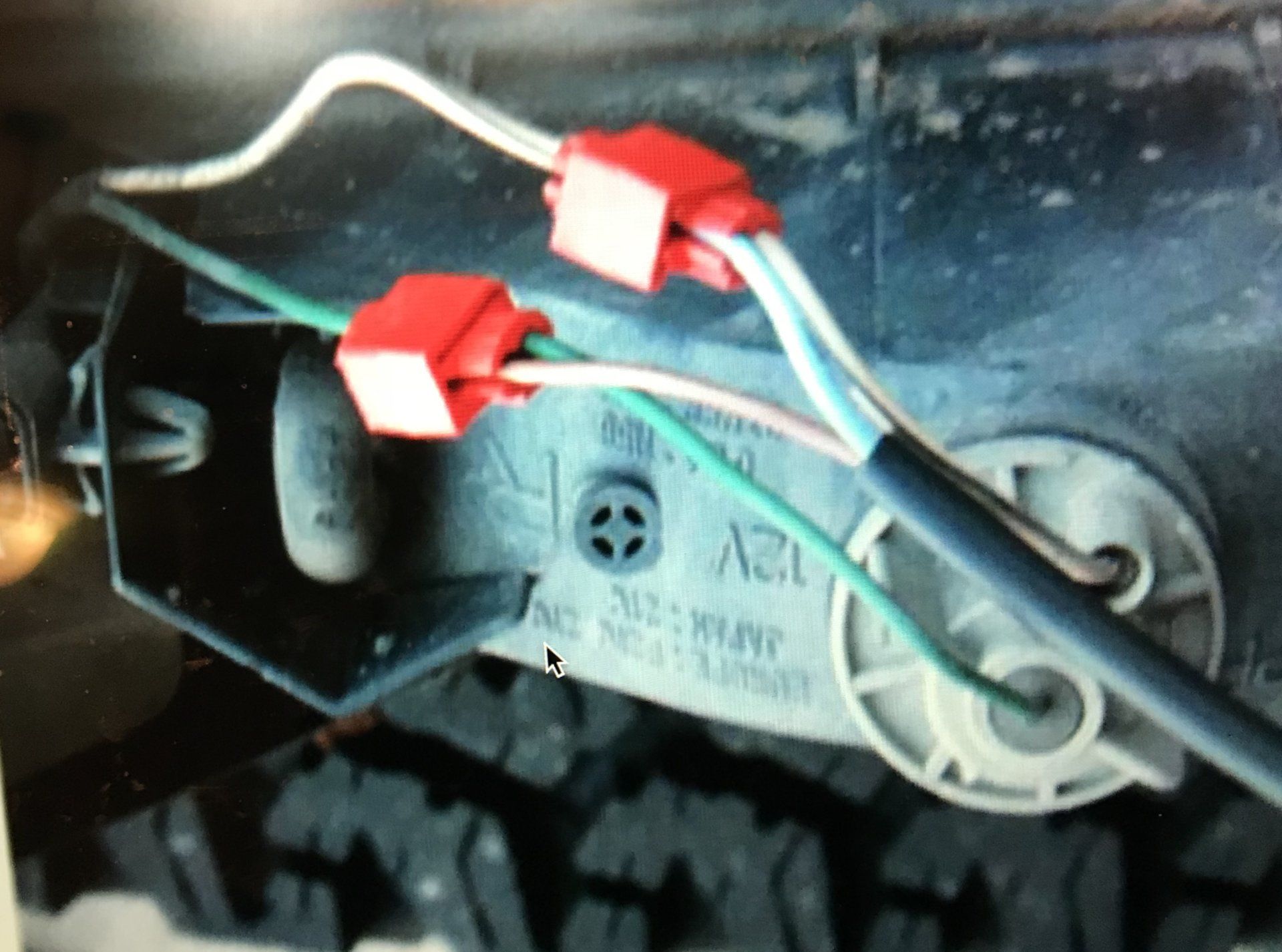

T-taps on the green & white wires & male insulated spades into the T-taps, then you have power going to both bulbs.

I got It figured out I am embarrassed. I connEtter the current the wrong way.
Power needs to come in to the butt connection the other end of the butt connection is the signal going to both sets of turn signals. I was Connecting power to the bumper lights in one end and then the truck lights coming out of the other end.
So I thought I had It figured out. I have It wired like the picture above with butt connectors. Nope, the truck blinker will still not go on despite the ARB lights working fine. What could be the issue?
