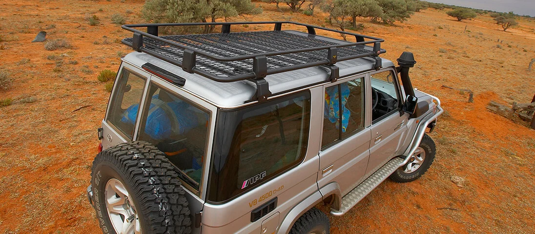

Does anybody on here use the arb roof racks on their Kzj78 prado land cruiser? I live in the United States and Its hard figuring out if its possible to order one of these from arb? I am guessing the arb parts for mounting would be for the newer vdj76. or maybe the size for the fj60 would work? Any info on this would be awesome! thank you in advance.
I would use VDJ76 as the starting point. I am using Toyota accessory gutter mounts and bars from Australia meant to be used for VDJ76 which works perfectly on the 77 series...which also appears to be the same as the 78 prado body. as far as the roof area goes.
If I am not mistaken, the FJ60 is not as wide...but hopefully someone that knows the differences better than I can confirm.

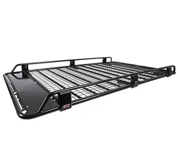

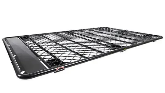

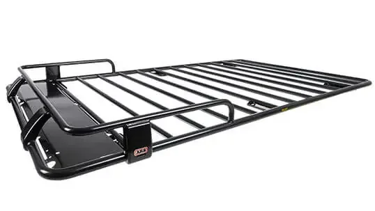

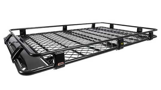

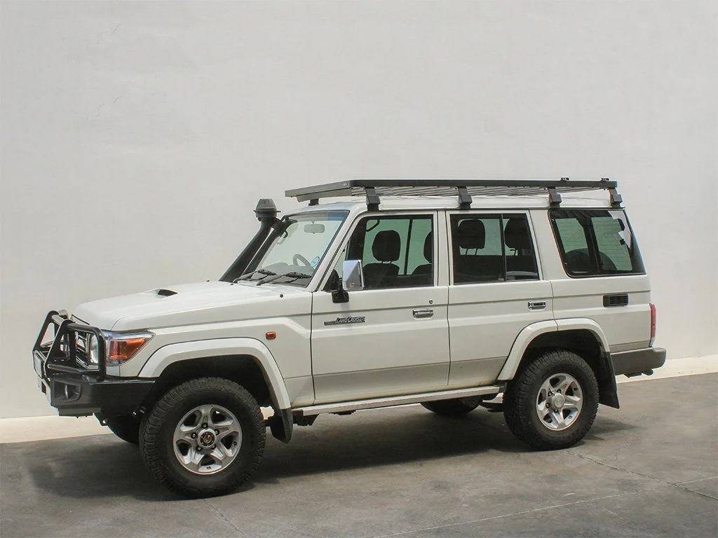

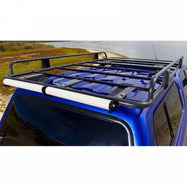

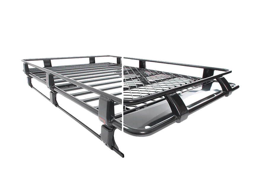

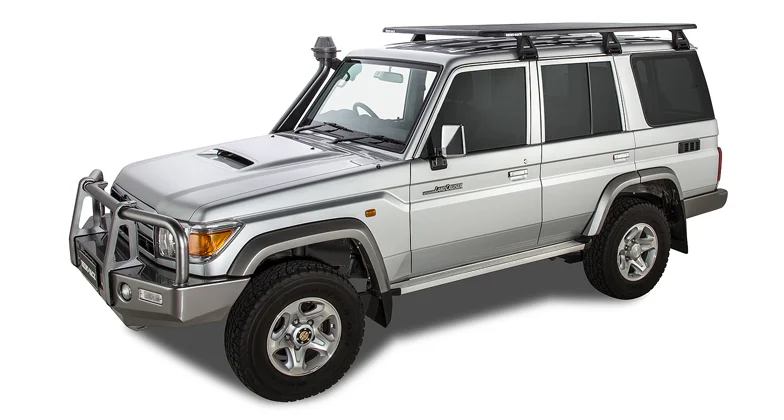

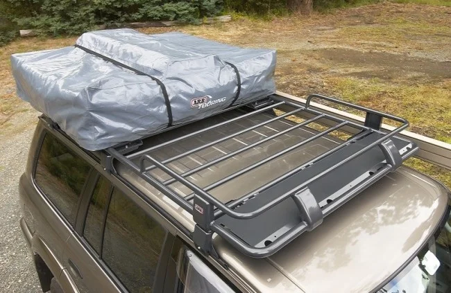

I've researched this a bit, Using the VDJ76 for fitment as the body from front doors back is identical. There would be your usual thule or yakima gutter mount/ bar options or if you are looking for something more like a roof basket or platform rack, I know of 3 options: 1) Frontrunner platform, 2) ARB base rack and 3) the regular ARB Touring type rack. See photos below. I think I am going to go with the ARB touring rack with the flat section in the back for a RTT option. I think the look of this rack matches the 90's era off roaders better than the newer platform style racks, though either would be great I'm sure. I can say from the research I've done, the 80 series roof doesn't appear to need as much clearance as the 70 series wagon does, so I wouldn't gamble on a rack made for the 80. If you are interested, I'll list the ARB part numbers below for the touring rack.
FRONTRUNNER
ARB BASE RACK
ARB STANDARD BASKET RACK
ARB TOURING RACK
ARB Touring Rack with Front rail only #3800200
ARB Fit Kit (towers, clamps, etc.) #3700100
ARB Air Deflector #3700310
Double Jerry Mount #3500390
