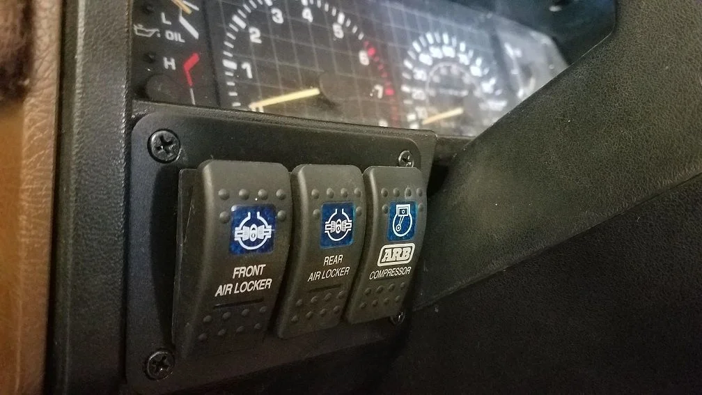

Installing the two switches on the dash so that the wires are clean, tucked in nicely while not breaking any of the plastic tabs should be done with care.
Sorry, just for you @alia176

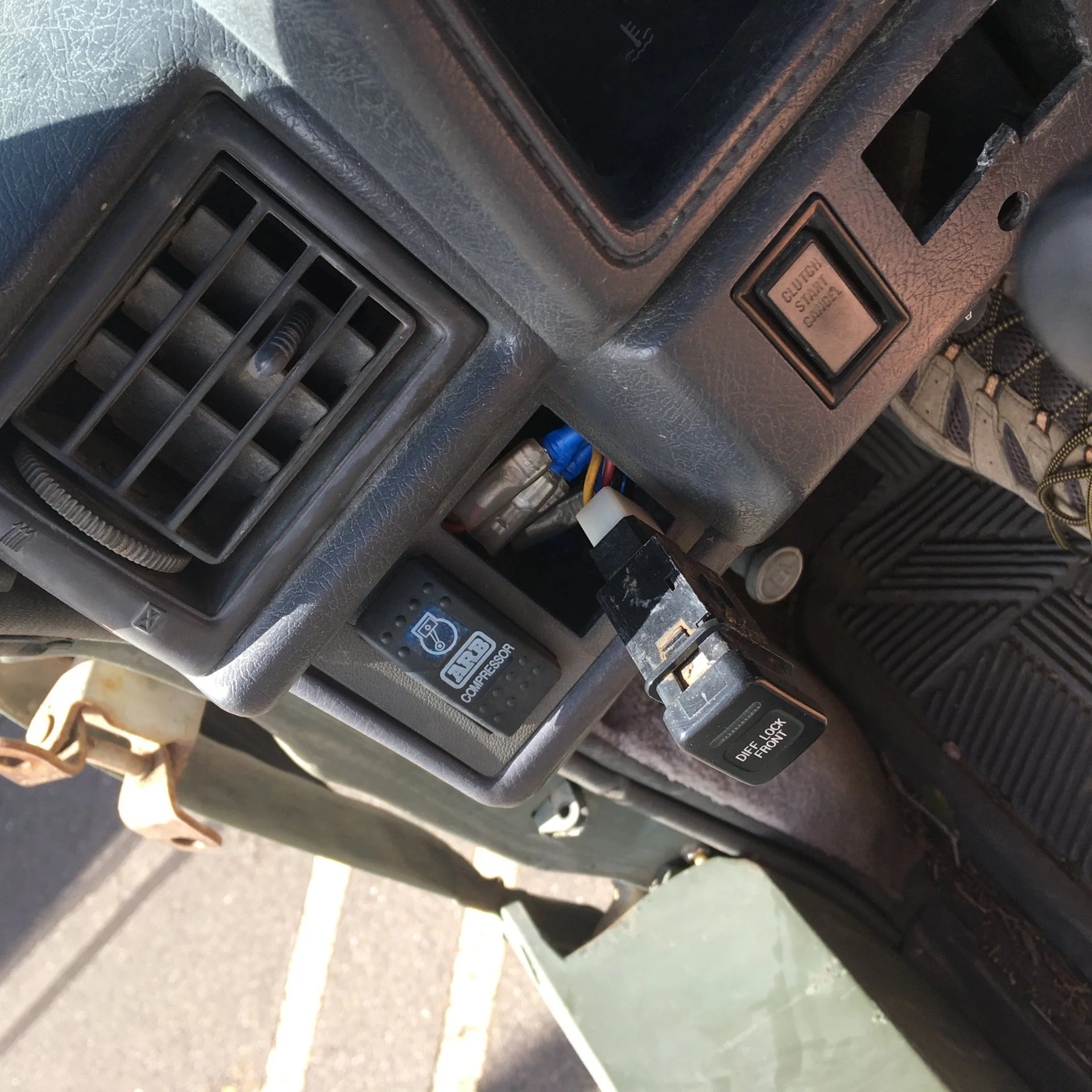

Ya it’s a dang miracle any of my junk actually operates
Gosh, then you can just hack up the dash and do this …
Looking good fellas!
