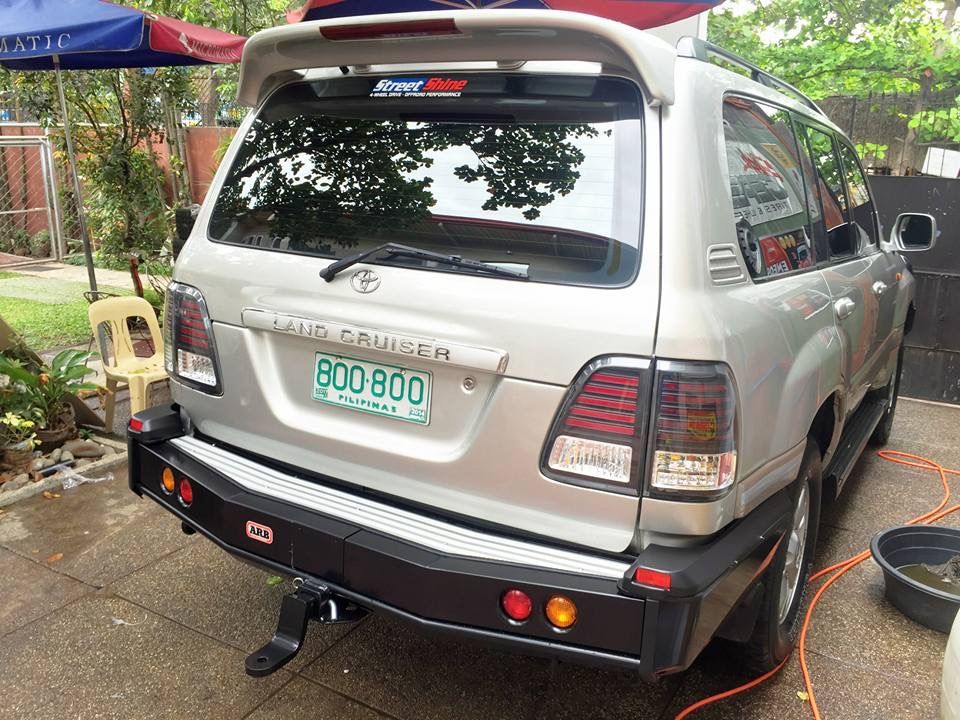

My favorite rear bar for a Land Cruiser. After a 10km ride I noticed the rear went lower approximately 1”. That’s because of the additional weight of the rear bar. The suspension on this LC was bare stock and same like yours it doesn’t have any problems with it so no real immediate reason why we had to.

Wow, ARBs just look amazing. I have been told to get slee rear bumper instead, but ARB just looks more robust-old school. My friend has tire carrier as well, so his rear went lower exactly 2". My stock distance is 6 1/2'' and his 4 1/2''. Also, I have heard ARBs are insurance rated for towing when slee and others are not.
