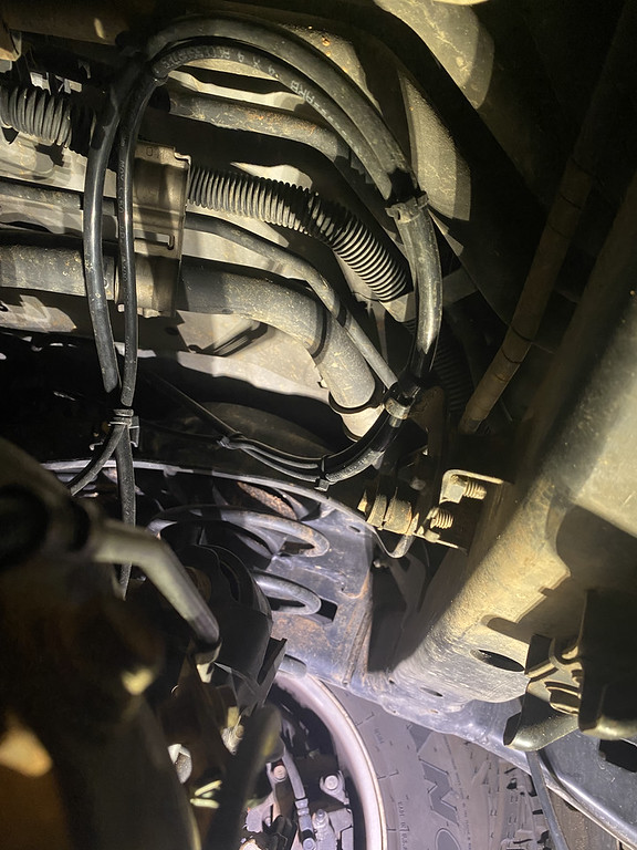

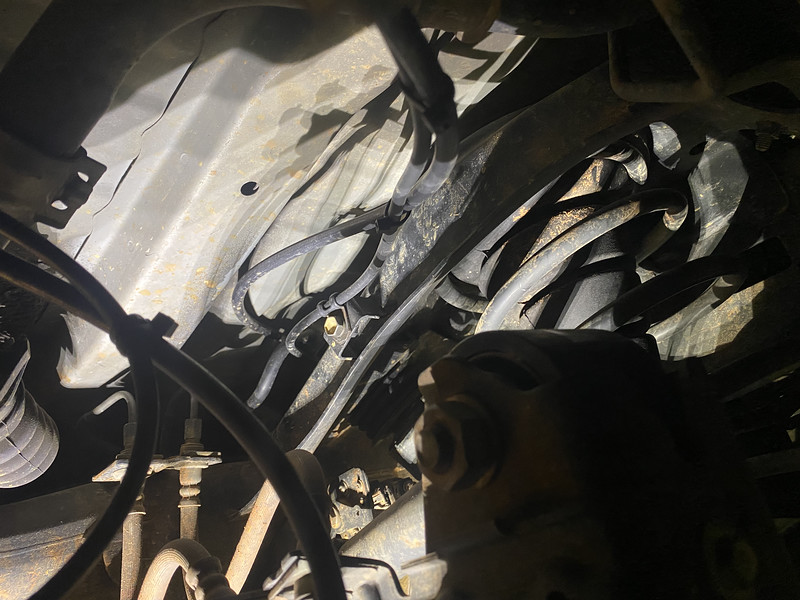

For those of you with rear ARB air lockers on your 200 can you show me how/where the air hose was routed to the compressor manifold? Thanks!
I routed mine along my diff breather extension, looping back towards the rear crossmember. I attached it there with a toyota hose clamp, then ran it along the passenger side frame rail, through another hose clamp, and then up through a gap in the frame rail and down between the frame and my sliders. Ran it passenger side to avoid getting close to the exhaust.
This is exactly what I needed to see. Is your compressor on the drivers side?
I ran elocker wiring, not air hoses, but I went from the rear diff followed the brake lines up to the body, between the exhaust heat shield and body, over a steel crossmember to the driver side, over the frame rail, along the kdss lines outside the frame, up through the wheel well opening, up to the area near the master cylinder where I happen to have my compressor. The front diff went straight up to the same area.
I was able to snake it most of the way inside the drivers side frame rail and then inside the rear cross member to the breather line.
