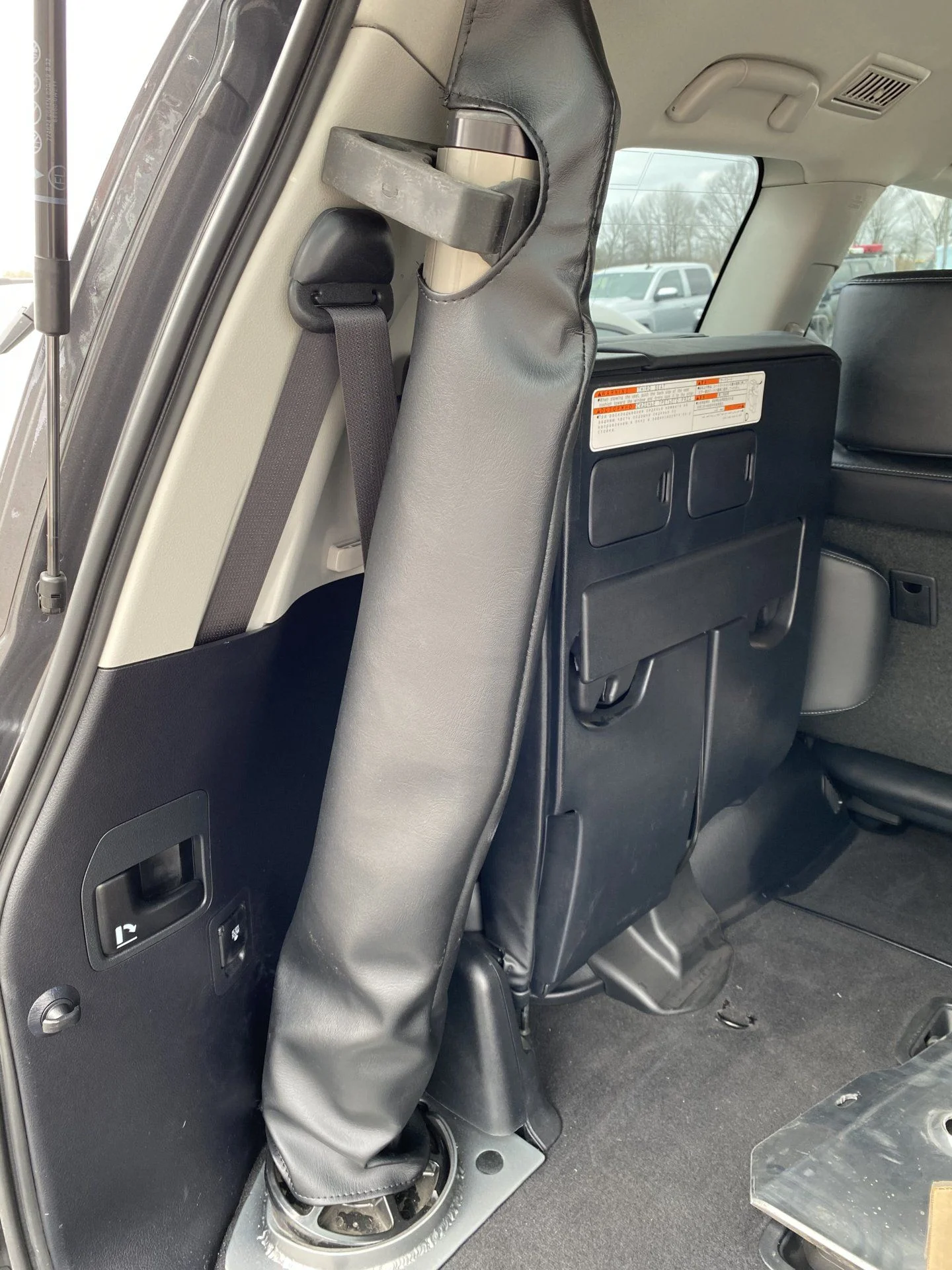

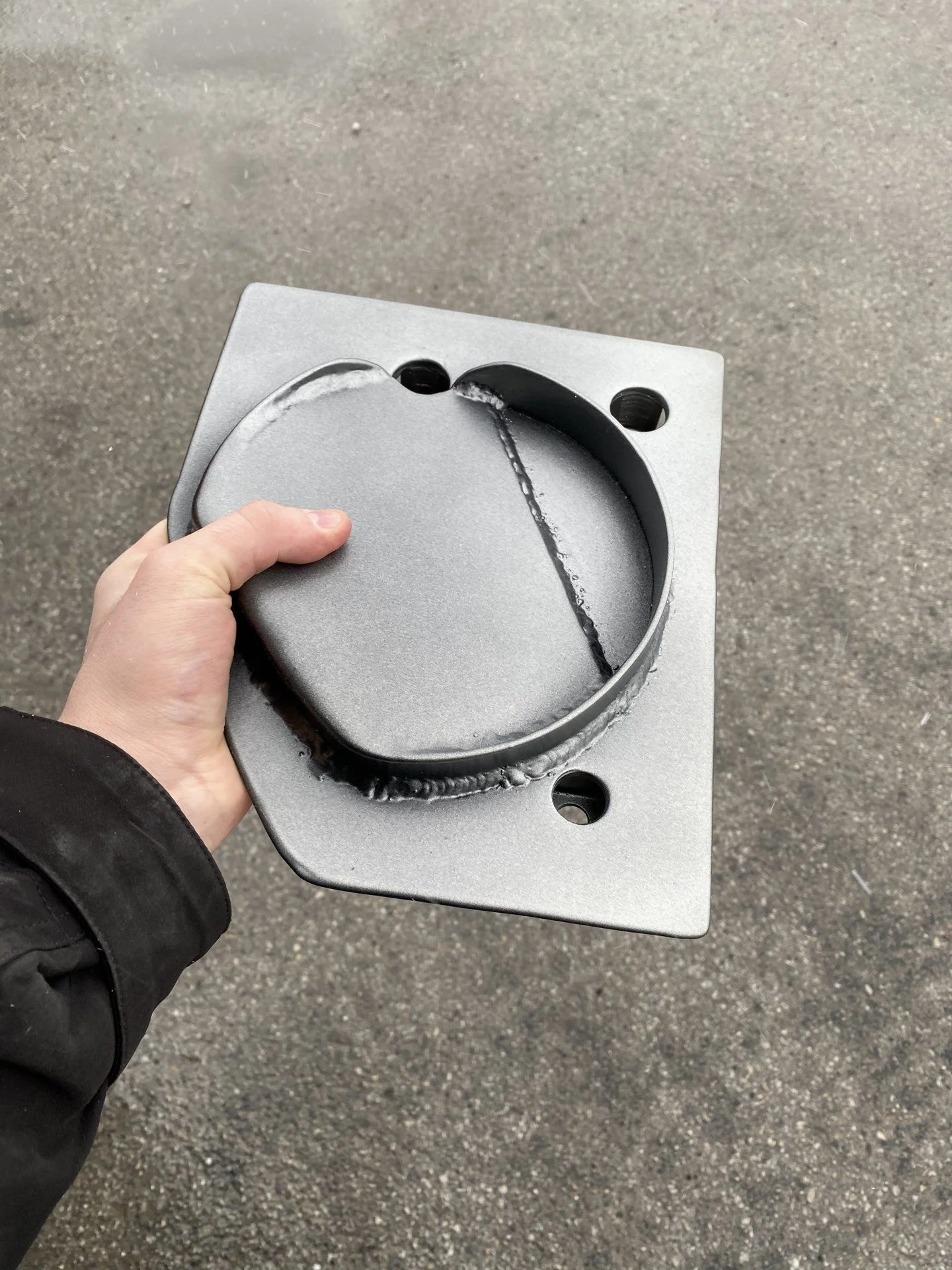

ARB JACK Mount for a 200-Series Land Cruiser. Powder coated titanium to match the wheels. What are your thoughts?

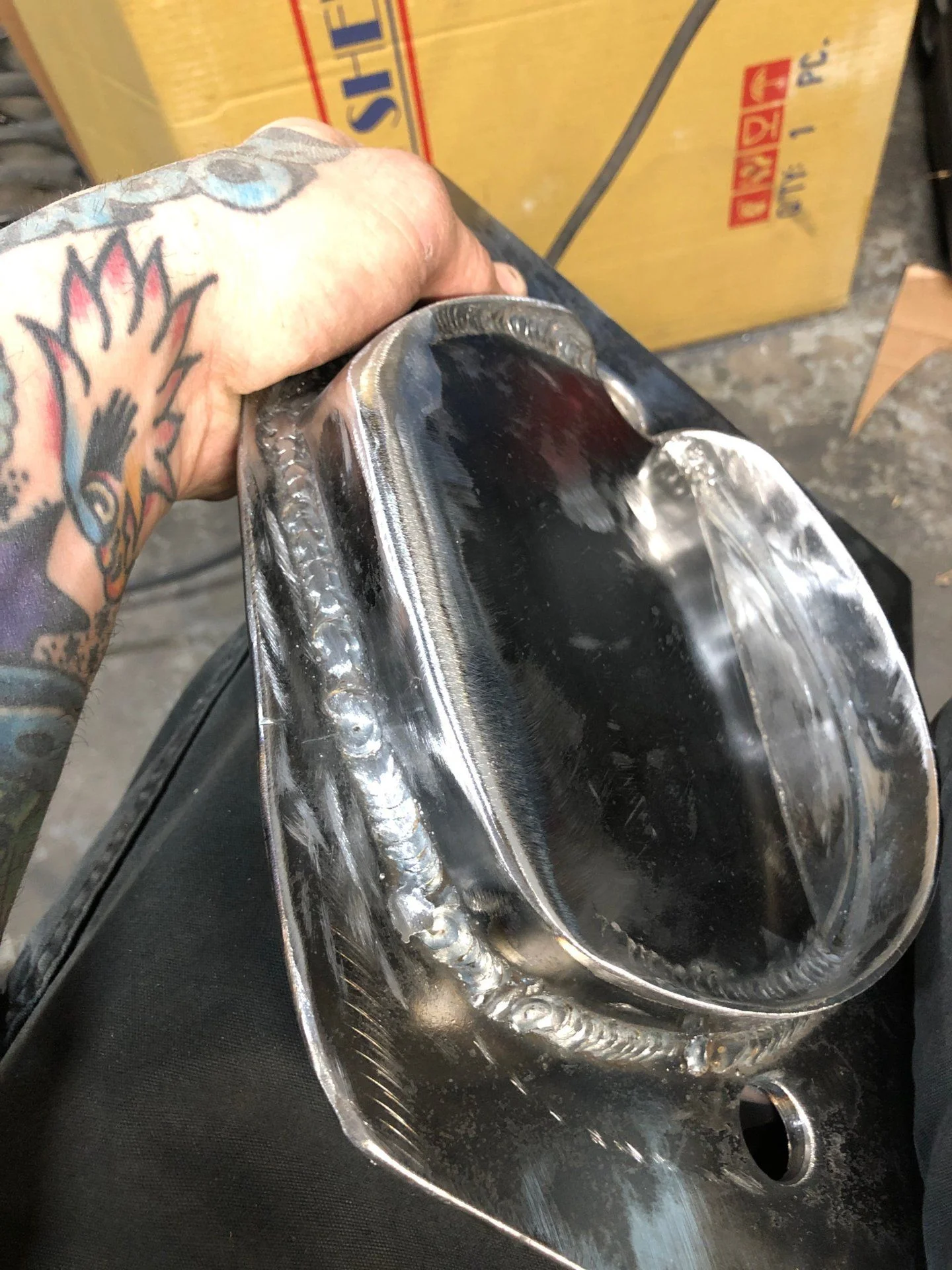

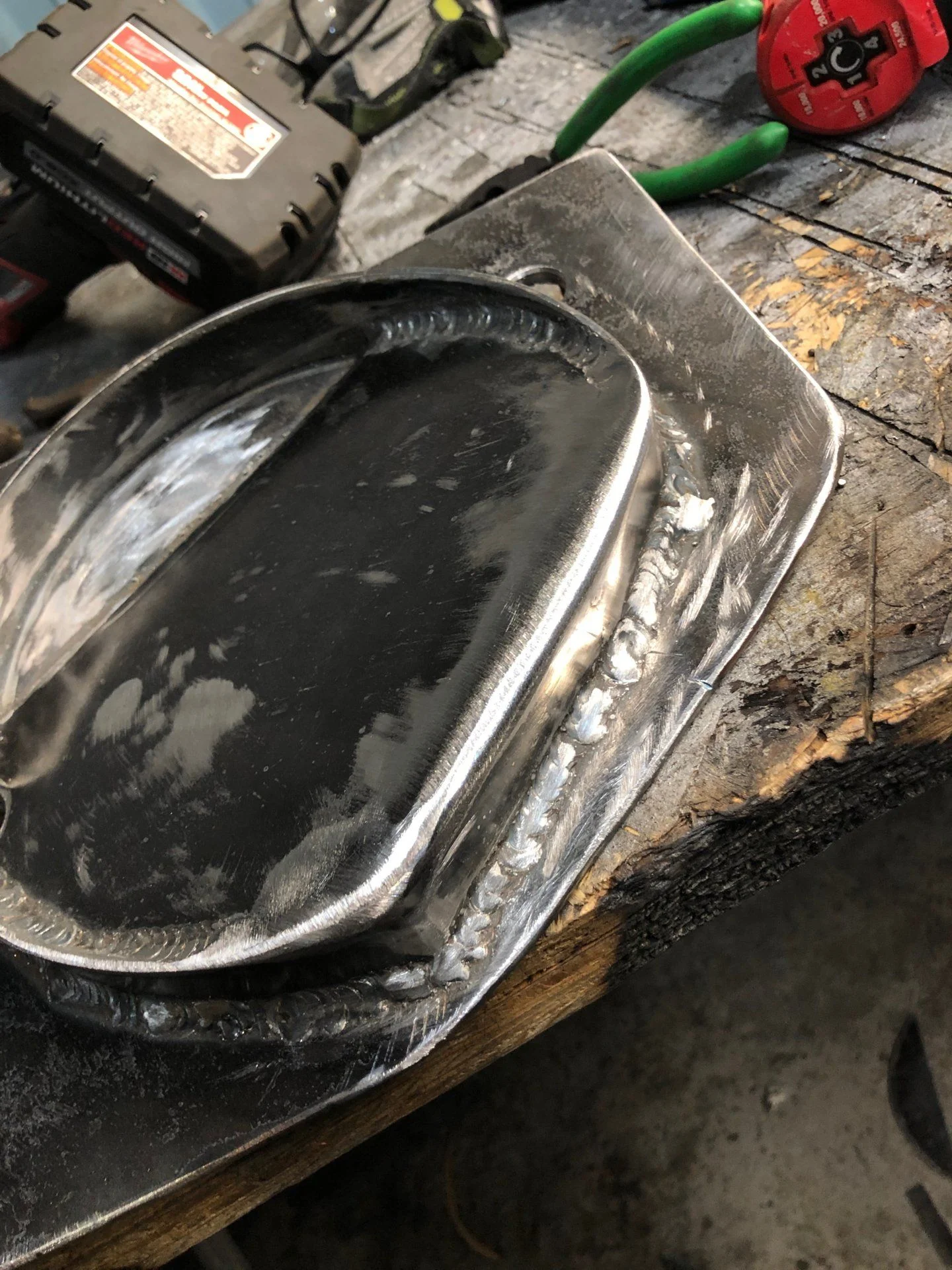

Post powder
Pre powder

You need to find a better welder.
Hey, you asked...

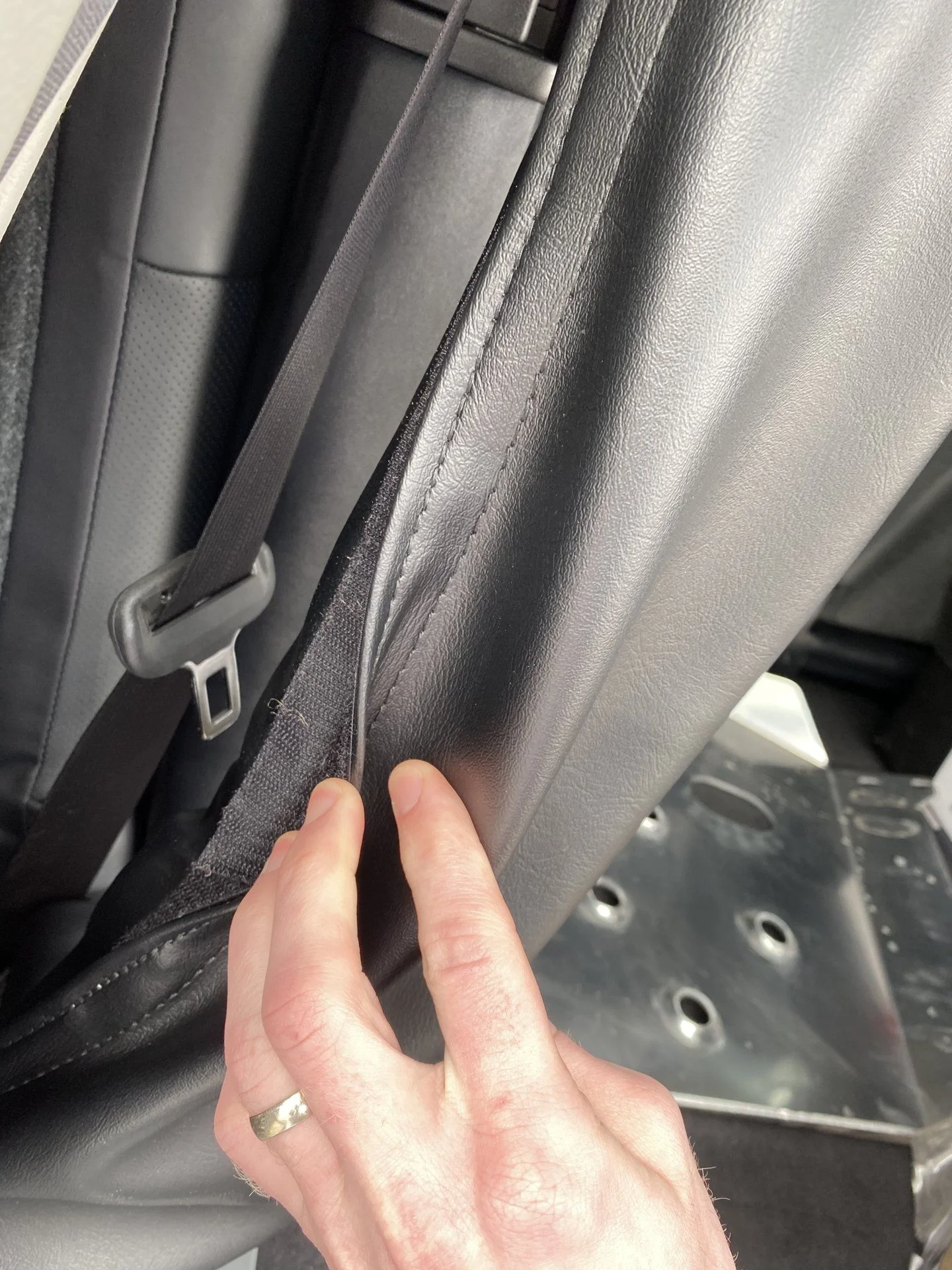

Custom cover. Finished product

I like the base but personally I'd want something much more substantial holding the top of such a dense/missile-like object that is inside the passenger compartment in case of serious accident. One of the mesh barriers I've seen on your build would probably get the job done in another way.
When I was considering putting a hi-lift on my roof I had an idea for a kevlar tether to a solid anchor so it didn't mess someone else up in case of accident.. and that wasn't even inside my vehicle.
I definitely understand where your coming from. I secured that Quick Fist with a steel plate bolted to the seat belt restraint behind the plastic trim. It would take a solid collision to dismount.
My concern would be the quick fist itself failing. The ones I have and larger ones I’ve seen are just rubber.
Either way.. it is certainly a clean install.
