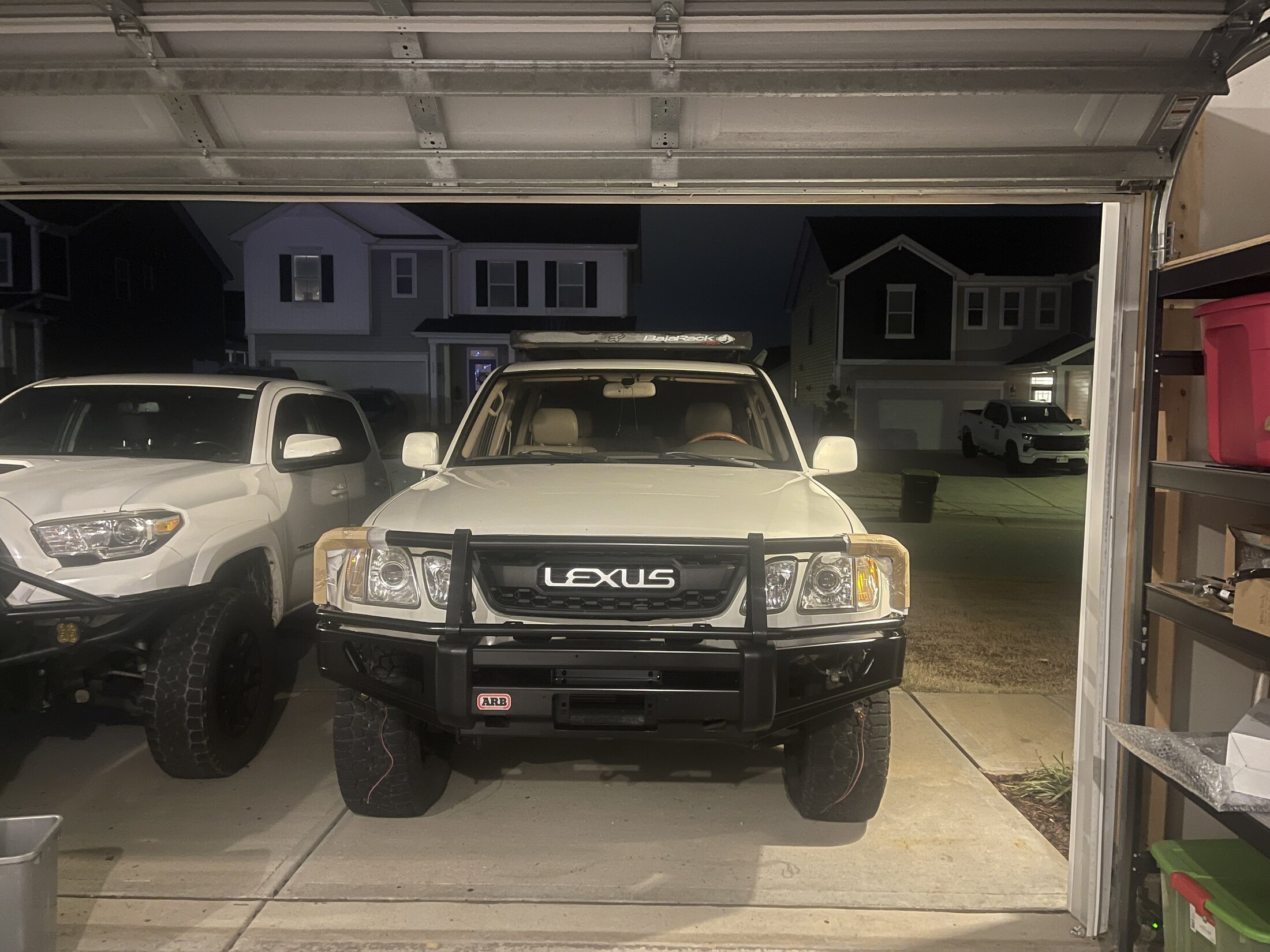

Shifted the bottom of the grill inward so it would clear the light tabs.

I'm having Slee put one on my 2000 LX470 June 5th lookin forward to it
Nice! I did my solo, it was a royal pain in the ass to do without help haha. Good call on having someone do it
Thanks I'm retired I can think of better ways to have a heart attack :)
