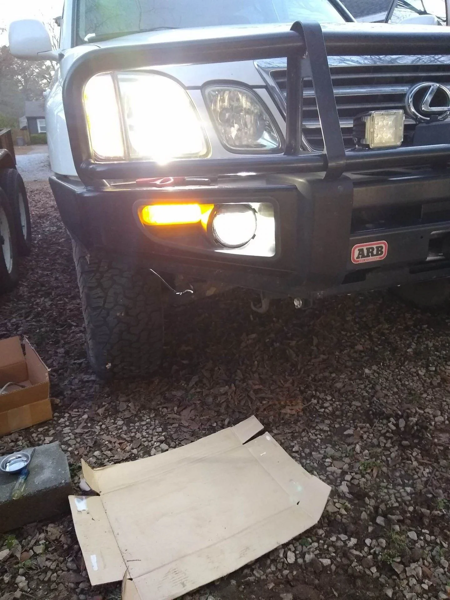

Installed ARB's LED fogs in my Sahara bump last week and very pleased. I never checked reviews but assumed the incandescent ones (ARB 6821201) would not meet my expectations. Instead I installed the LEDs, ARB LED Fog Light Kit (Small) - 3500890

I bought these are they are excellent. Nice well defined cutoff and bright beam. Well worth the upgrade from generic chinesium $40 jk fog lights I had rigged up in there before. I upgraded the turn signals to the ARB LED versions at the same time as the halogen ones constantly were getting water and mud in there.

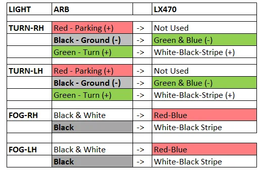

Sorry to bump an old thread but you how are you guys wiring the ARB turn signals and the fogs? In the instructions I followed I cut both factory connectors and used 3 of the 4 wires just for the turn signals that came with the 03+ ARB bumper. I now want to get the ARB LED fogs and would like to wire them to the stalk.
For my 99 LX470, I used the following diagram. I stayed with the LX470 parking light.

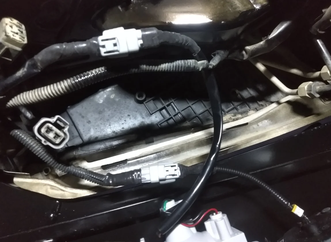

Then I connected the wiring using some Toyota style plug connectors that I got from Owl Expedition. If I need to remove the bumper or lights, its plug and play.
