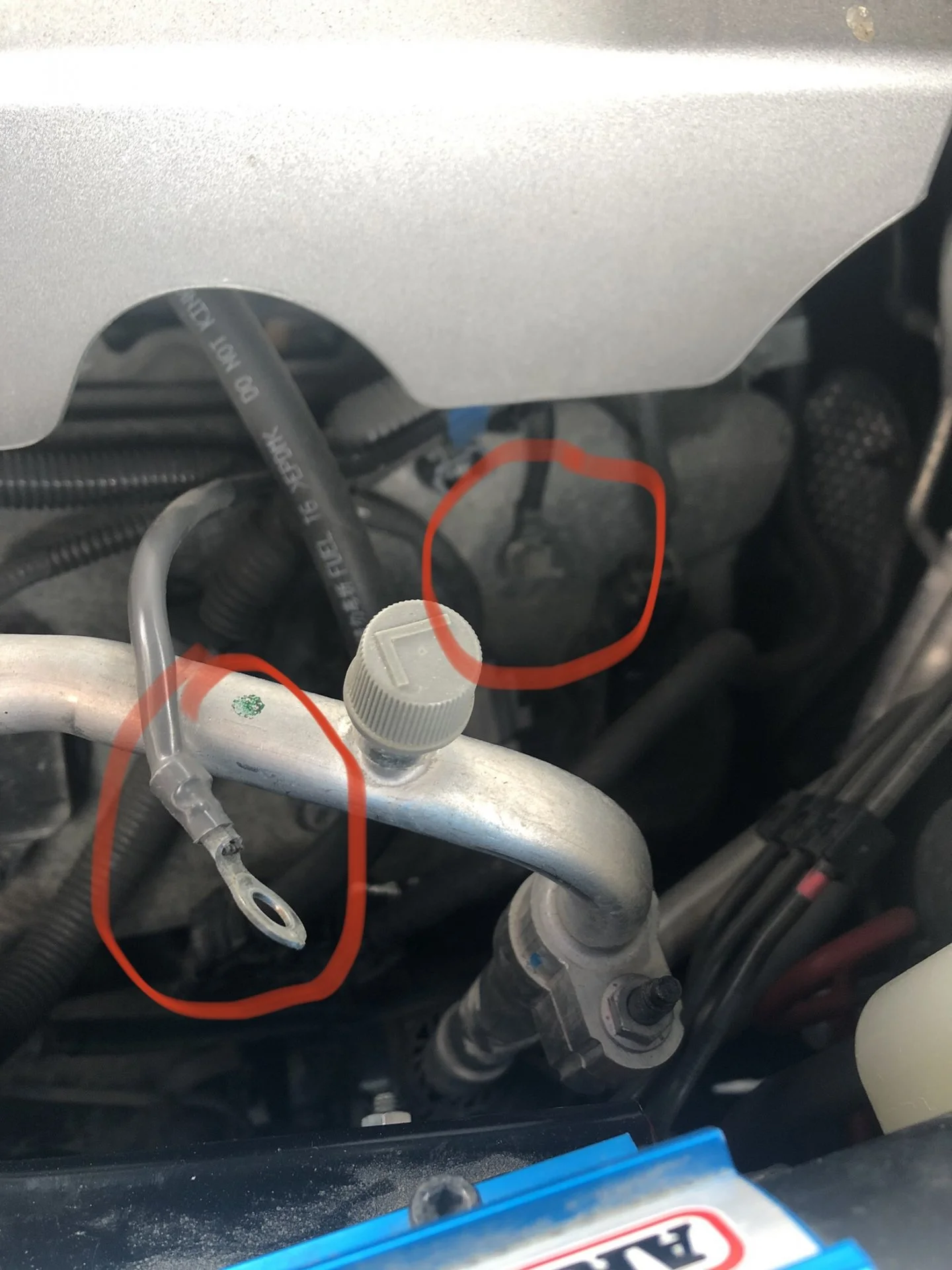

I moved my air compressor and Slee tray over to my ‘16 (was on my former ‘13). I have a ground wire from the engine that I don’t know where to attach it. One end goes to the engine and the other end went to the SAIS controller bracket.
I don’t remember this being on my ‘13, but could have just forgotten.
The stock wire isn’t long enough to reach the Slee bracket where the SAIS boxes are now mounted.
How have people dealt with this? I’m tempted to just remove it, but don’t want to be too short sighted.

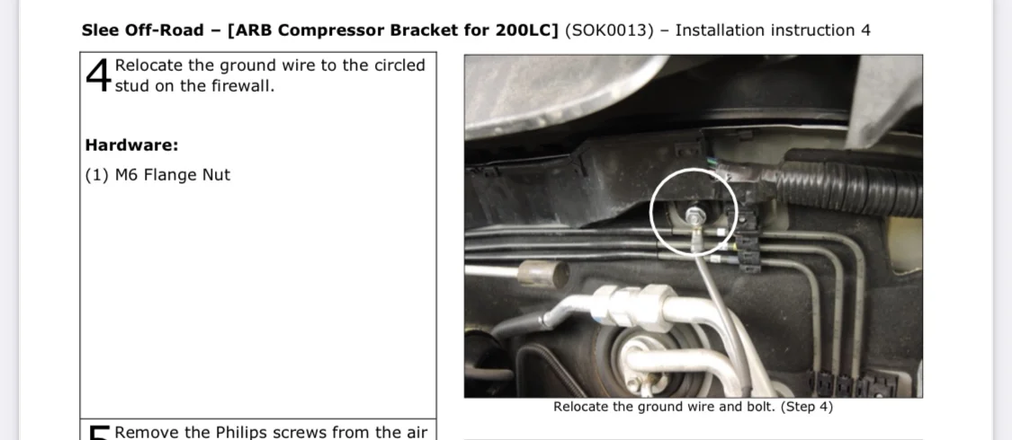

I looked up the instructions on the Slee site, and you relocate it to the firewall stud.
I should’ve gone by instructions instead memory. Mea culpa.
