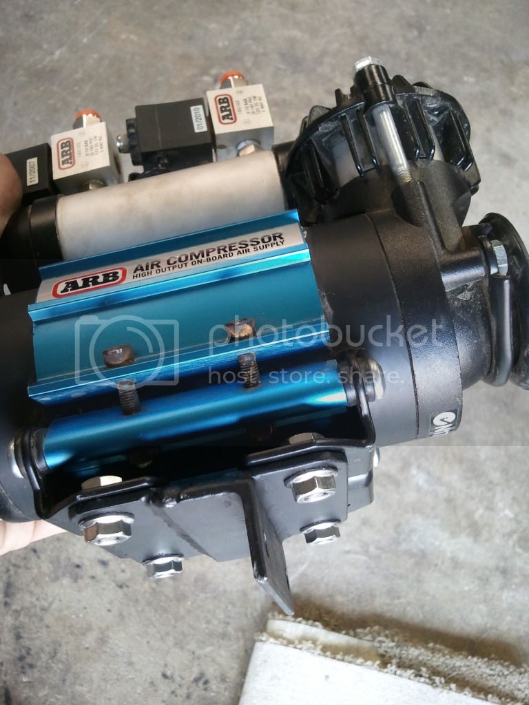

I designed a mount for my ARB CMKA12 compressor to be mounted where the stock Jack goes... I'm using it to air up a 4 gallon pancake tank I will be putting underneath for tires and tools...
Meeting with the laser cutter tomorrow and will start offering them soon with all hardware and rubber isolating washers..

I isolate the mounting with marine grade rubber washers.... compressor to the mount and also mount to attachment points... That combined with the cover panel... Very quiet.

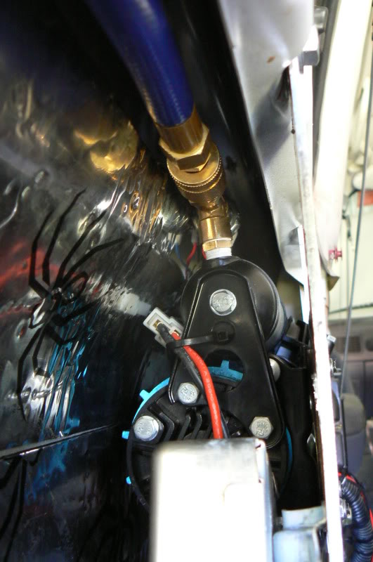

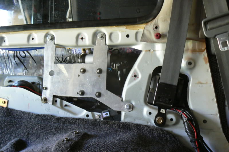

you could consider mounting as I have done
LH rear quarter
The mount started out as a cardboard template from a box of beer. (where all good templates and ideas come from) transferred onto some ally sheet.
It picks up some factory holes in the structure that werent used by the trim clips.
The hose is rolled up near teh bottle jack. I will be adding a small tank later. If you run air lockers you can get solenoid vents and run them overboard the the rubber bung at the bottom of the quarter panel. otherwise you'll get the smell of diff oil. probably need to mount mine a little lower soon, but for now it does the job nice

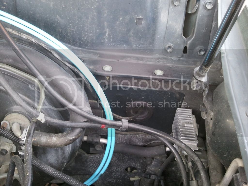

I mounted mine near the master cylinder. I used rivnuts to mount it to the firewall.
Here is a pic of the bracket:
For some reason I don't have any photos of the installed finished product, but you get the idea.
