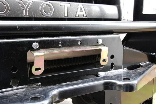

Most of the winch bumpers come with the licernse plate mounting bracket included. Did you buy it used?
Here's a pic of the bracket that should have come with the bumper.

Not sure if this would work if you had a winch mounted.
Edit: For the bottom....I ran a long zip tie from one side to the other, then attached the two small ones to it. :2cents:
