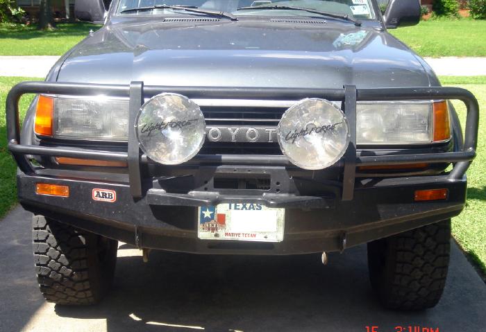

No airflow problem I like these for around town driving.People get out of your way and are very friendly-always waving.But seriously, I really like these and contrary to the rule -fogs,glare,Etc.... Froma a Colorado snowstorm to Gulf coast fog,I really can see beter with these.
Bill
https://forum.ih8mud.com/attachment.php?attachmentid=21123&stc=1
MoJ said:
What's the consensus on diminished airflow to the radiator by mounting large lights in front of the grill? Nothing to worry about?
A lot depends on where you are in the country. I do find that once temps exceed 110degrees it does make a slight difference on the hwy without out lights up front. That said most of you never see temp that high and thats a good thing.
I've got the same type of set up as what is being pictured above and never had any heating issues whatsoever. And I also have a winch up there filling that hole so less air than the above pictured scenario.
