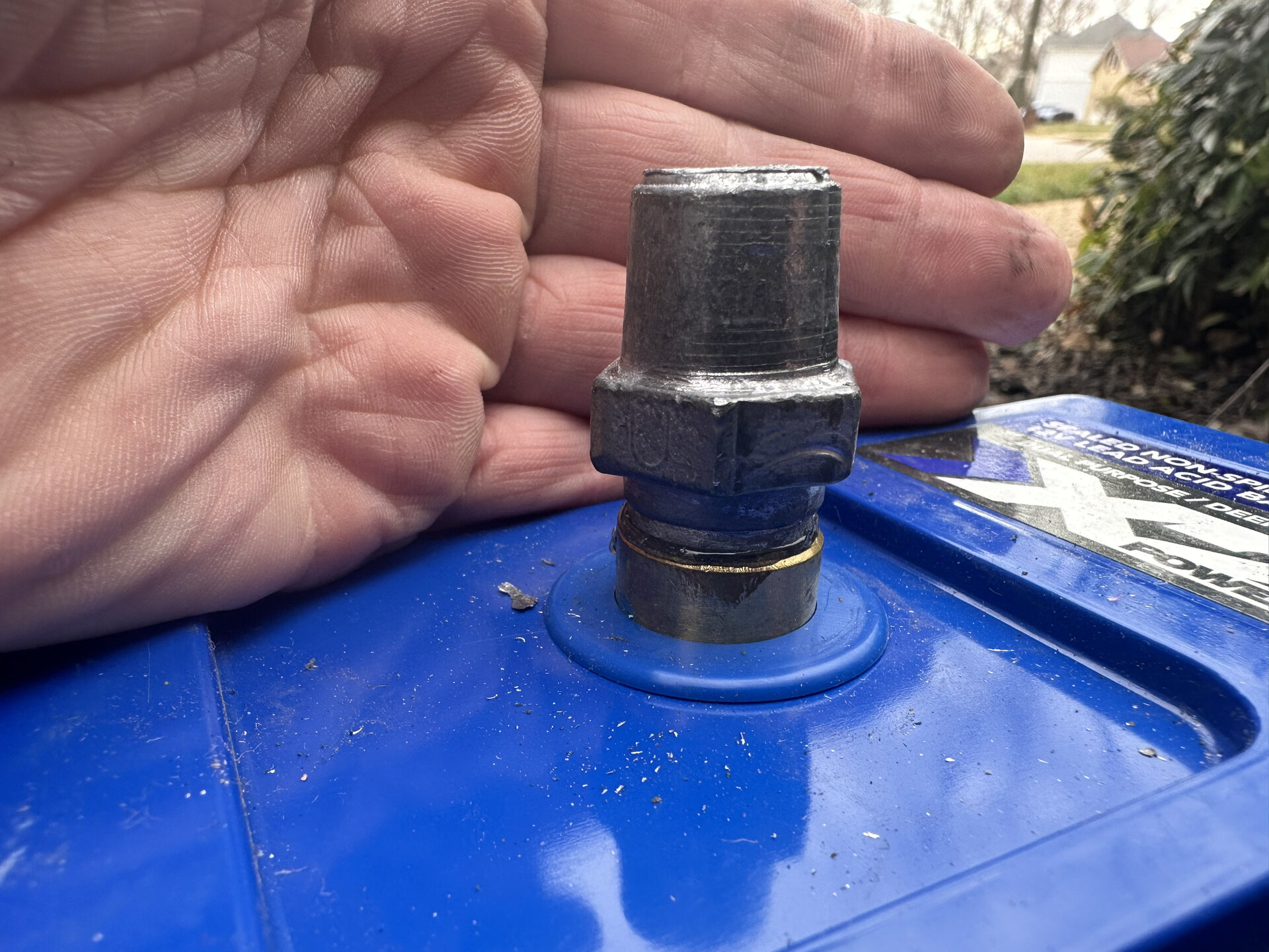

I will say the battery posts are a bit tall in combination with the Slee tray and hit the hood silencer pad.
Same question from me, did you need to do anything to clear the hood? I just finished my install and although my preliminary test fitment allowed the hood to close (with some indentation of the hood pad), the battery connectors provided by Slee appear to hit the hood itself and I can't close the hood.
No issues with that though? Did you use the Slee connections? What about the Toyota terminal covers?

Any answer to this? I am having same issue!
I'll see if I have a pic or if not I will take one. Mine clears, once I see it again maybe it will joggle the memory on if there was anything that stood out.
Here is mine.

I purchased the single post x2 which comes with the skinny posts. The adapters sold at batteries plus sit too high and the hood won’t shut. Anyone know of lower profile version?
They make a 27f version which is the factory battery size. Just installed one in my 05 LC and it fits perfectly but I have factory connections, not the Slee clamps.
