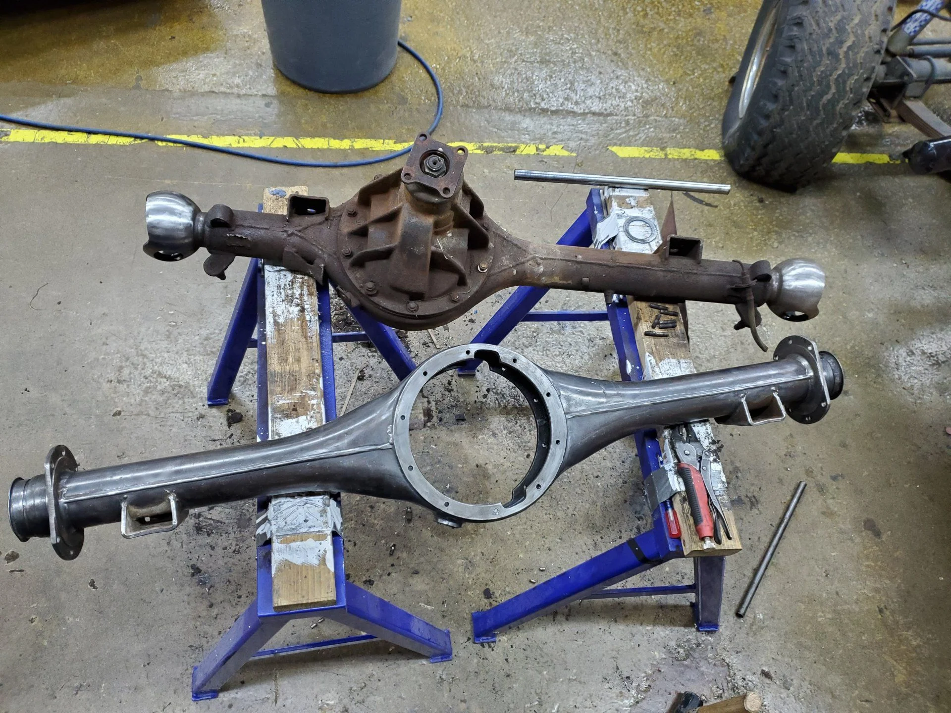

My plan for that housing was to cut the semi float ends off and weld on 80 series full float ends and get rear disk brakes at the same time. Then you can have custom length 80 axle shafts made which will fit in your later 40 series fine spline diff. The fine spline axles are stronger and I would think a better match for your v8 swapped 40. I am not sure who makes custom semi float axles, finding someone who does might be your challenge if you want to keep the semi float ends.

Here's a link on centering a stk Fj40 rearend.
I did this same thing to my 40 rear end probably 15yrs ago when I went to a center rear output T/case. It allowed me to use my 3rd member which had 4.88 gears and a Detroit locker in it, It also eliminates the C clips that hold the 40 axles in. Another plus is both mini truck axles are the same length. I'm pretty sure you can do this with the FJ60 axles using a Tacoma rearend. The job was not that difficult.

Learn something new every day. I had not seen that FJ40/Minitruck hybrid build before. Cool!

This could be an option
Called Ruff Stuff today looking for details on installation and was told "there are no instructions". I said how do I know where to cut the axle housing, they said "I'm not really sure". I was like ok, well maybe you can run my question by someone else and get back to me. I do hope they will get back to me with some good info because I like the looks and idea of the product. So far, the lack of product knowledge and level of customer service is not doing well for them. I will update this post appropriately based on the response or lack of a response.
