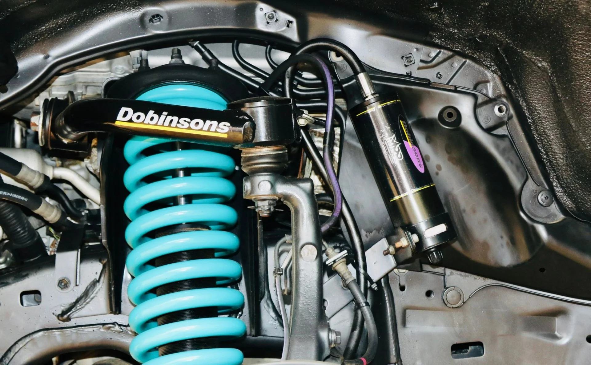

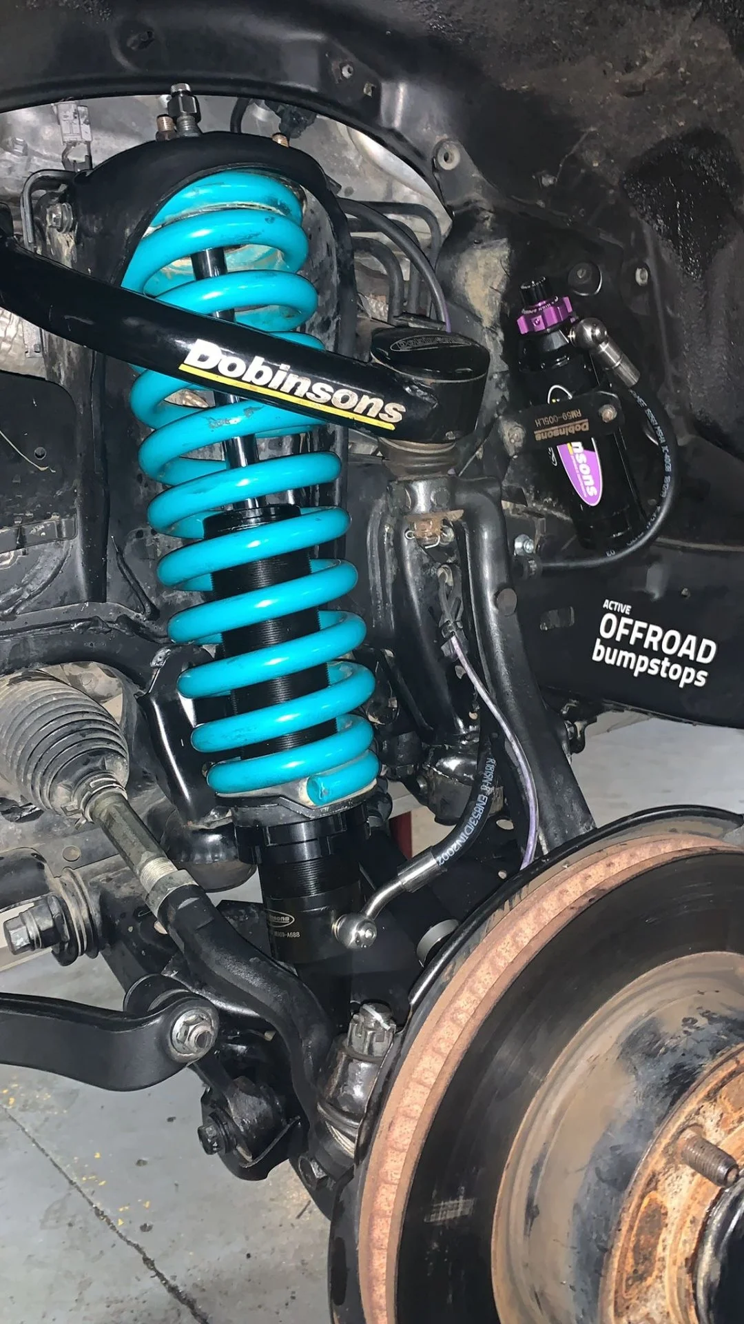

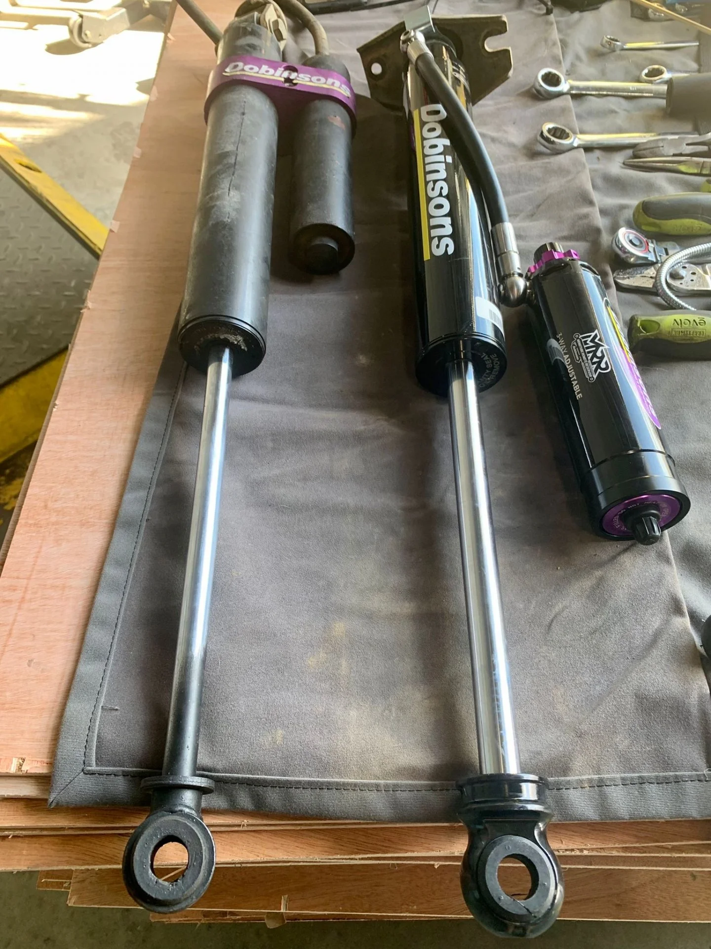

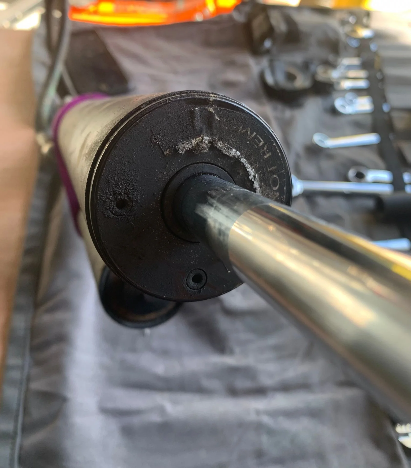

If you can spare the extra money for the 3 way adjustable MRA shocks go for it. The adjustability is amazing and when yo combine these shocks with the perfect coil spring for your constant load is the best combo that you have ever owned you can go as soft as you want and do trails and be super comfortable in your LC200 or you can set up the High Speed Compression to the highest setting and run high speeds in the salt flats or sand dunes. Also the durability and quality of the MRA components is over the top. I have the experience with their first generation MRR and they were top quality, we use them and abuse them and they never failed when they were upgraded for the new MRA we dissected all MRR shocks and the seals were in perfect condition, shafts, pistons were almost like new, the nitrogen pressure was the same in all 4 and never loss one single psi on them (see pictures)
Now about the BP51 I don't have any personal experience with them but the disadvantages that i know is that they use the same coil spring for all loads which for me its crazy because you gonna need a lot of preload in the coil over for vehicles lifted and accessorized with bumper, winches, dual batteries. another disadvantage that i hear constantly is that setting up the rebound and compression is difficult since the adjusters are located in the actual body of the shock and for the front strut is a pita since the coil is on the way easier
