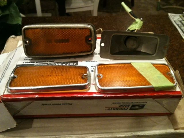

I bought 2 complete lights here on mud, then ended buying 2 aprons which came with 1 extra light.

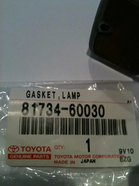

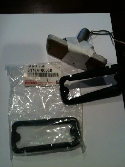

Remember the rear lights do NOT come with the rubber part you need for the front. Last time I checked, only one side was avail form the dealer. You can get 2 of the side that is avail and turn it upside down and it will work, but there will be a "slot" in top of the rubber on one side. Normally the "slot" is one the bottom side of the rubber.
HTH
Shawn
Gaskets for both sides were available when I bought mine 2 months ago.
Daryl
Well, I didn't have much luck finding gaskets... Cloest warehouse that had them was in Puerto Rico. Was told it would be about a month before they could get them :( Also could only get the one side so have to do the upside down deal... Hate to half-ass things like that but was beyond my control...
