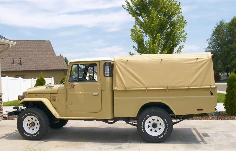

Cab top

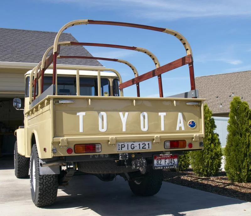

A few months back I finished the bed cover made by a local canvas shop and now I am in the process of designing and building a cab cover something like what was on the old US Army deuce and a half trucks. I am waiting to find a good tig welder or just buy one. I will be posting the steps when I have all the items and dawning completed.
Not to off set The Red Camel question, but the bows were old US Army bows from a duce and a half truck. the rest was just some engineering.
My cab bows will be made of aluminum tubing.
