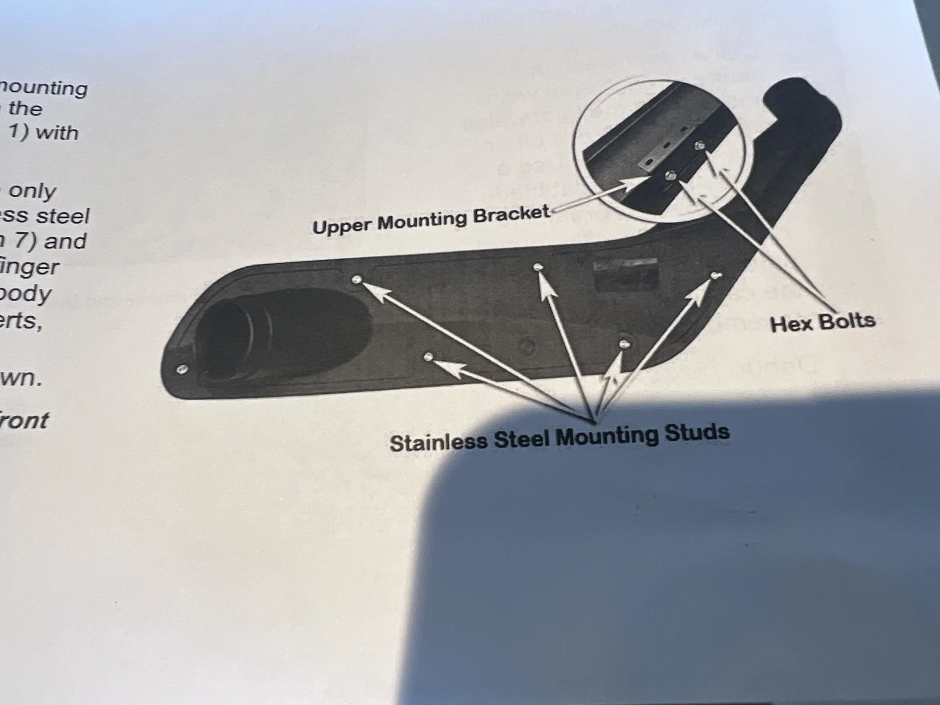

Pics from manual

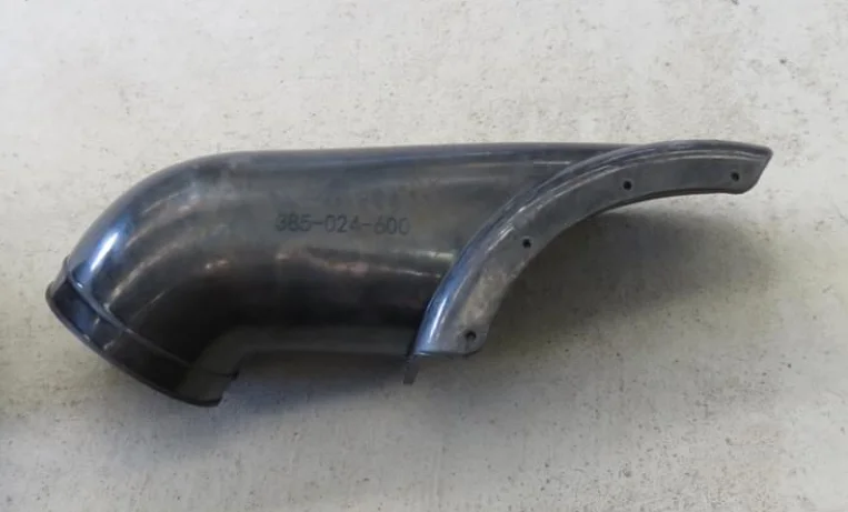

Are you still in need? I have the intake for the round box but I need the “S” intake for the square box.
