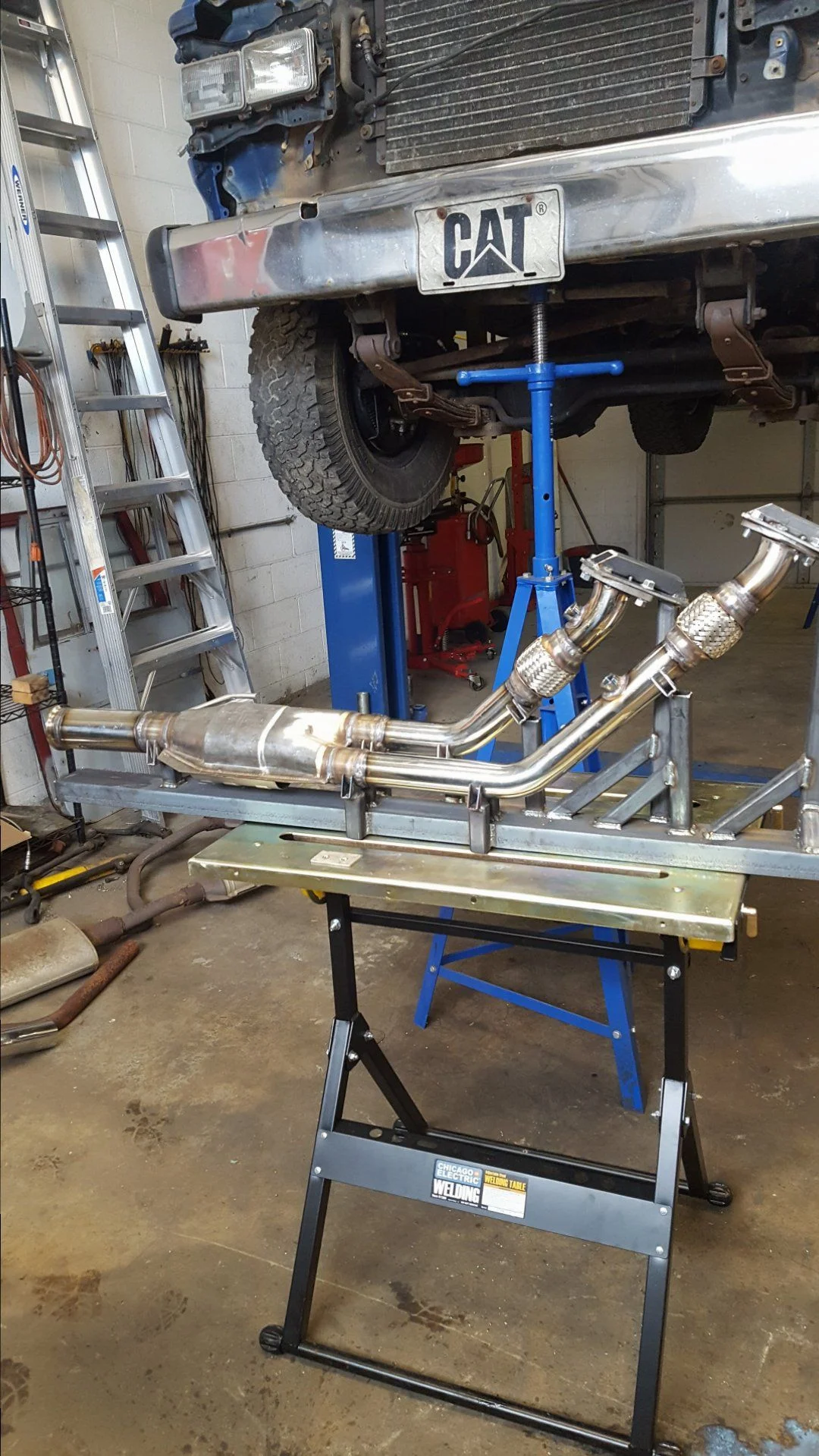

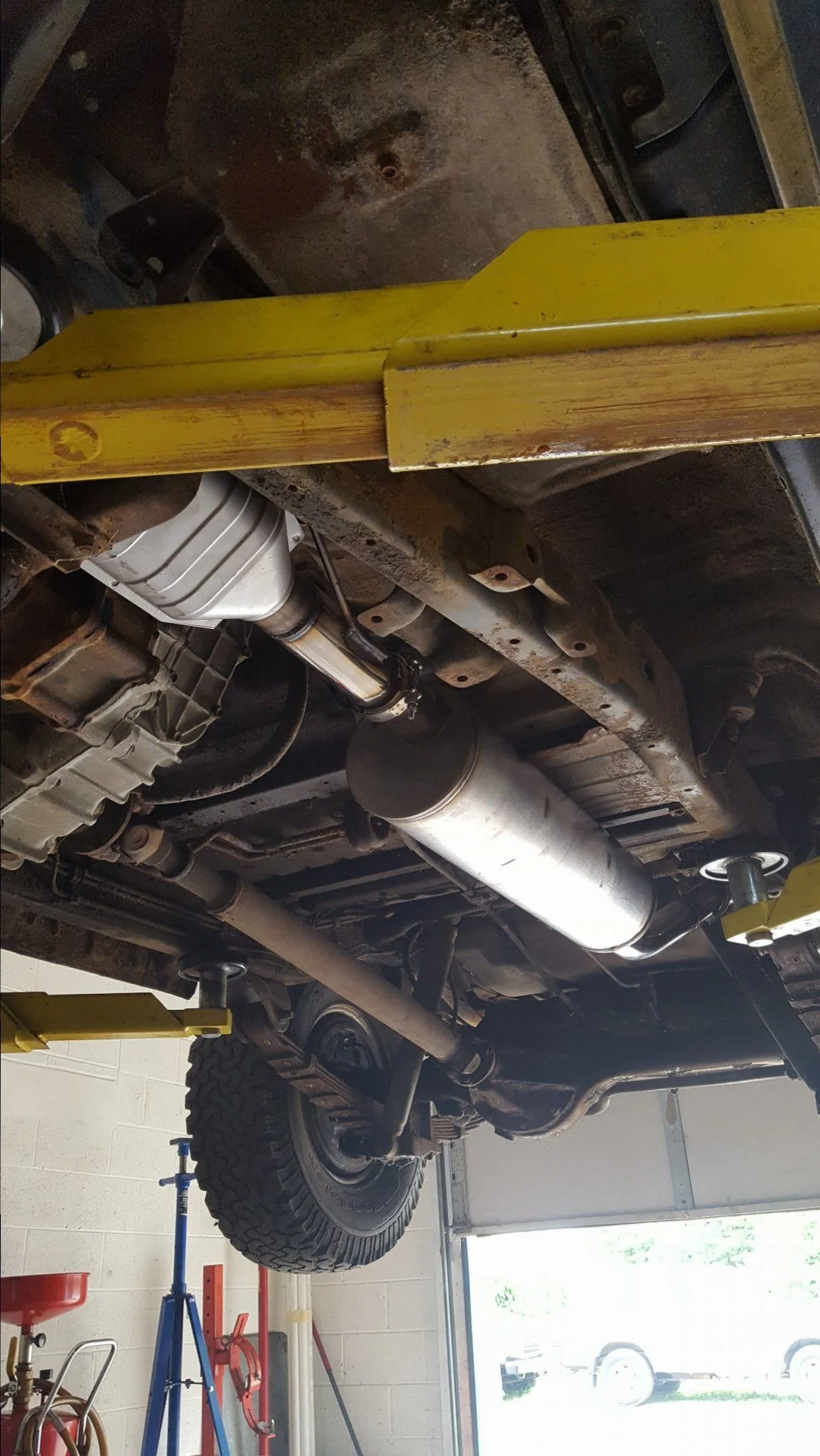

    I'm working on producing an exhaust system for the FJ62s. I've got the prototype done and fixtures built. Before I start going in to production I'd like to fit the system on to at least one more truck. The truck I used for the template had an H55F swap. I'm fairly certain I left enough clearance for the factory auto but I'd like to be positive before sending sets out. I'd be willing to do a pretty substantial discount if someone needed an exhaust and i could test fit on their truck. It's heavy wall mandrel bent stainless from the manifold back. I used a single 2 to 1 cat to get rid of the pipe outside the rails. And a large Magnaflow muffler to keep it semi quiet. 2" down pipes and 2 1/2" from the converter back. There's more pictures on my IH8MUD forum page. PM me if you have any interest. Thanks, Ryan 20170630_154218.jpg 20170703_162146.jpg 20170703_155849.jpg

    Those look sweet! I'm gonna need a version of those down pipes for my 2fe...

    I made the fixtures 2 piece so I can do the front half separate :)

    I really like the jig for the flanges.

    It was a "what steel is laying around" kinda deal.

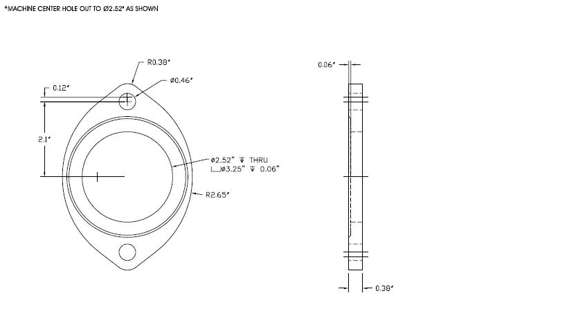

  17. iptman
    iptman
    Messages:
    3,377
    Likes Received:
    1,756
    Joined:
    Nov 22, 2008
    Location:
    Northern VA
    Here's the diagram for the Magnaflow flange if you want it.
    Stumpalama and OTRAMM like this.
