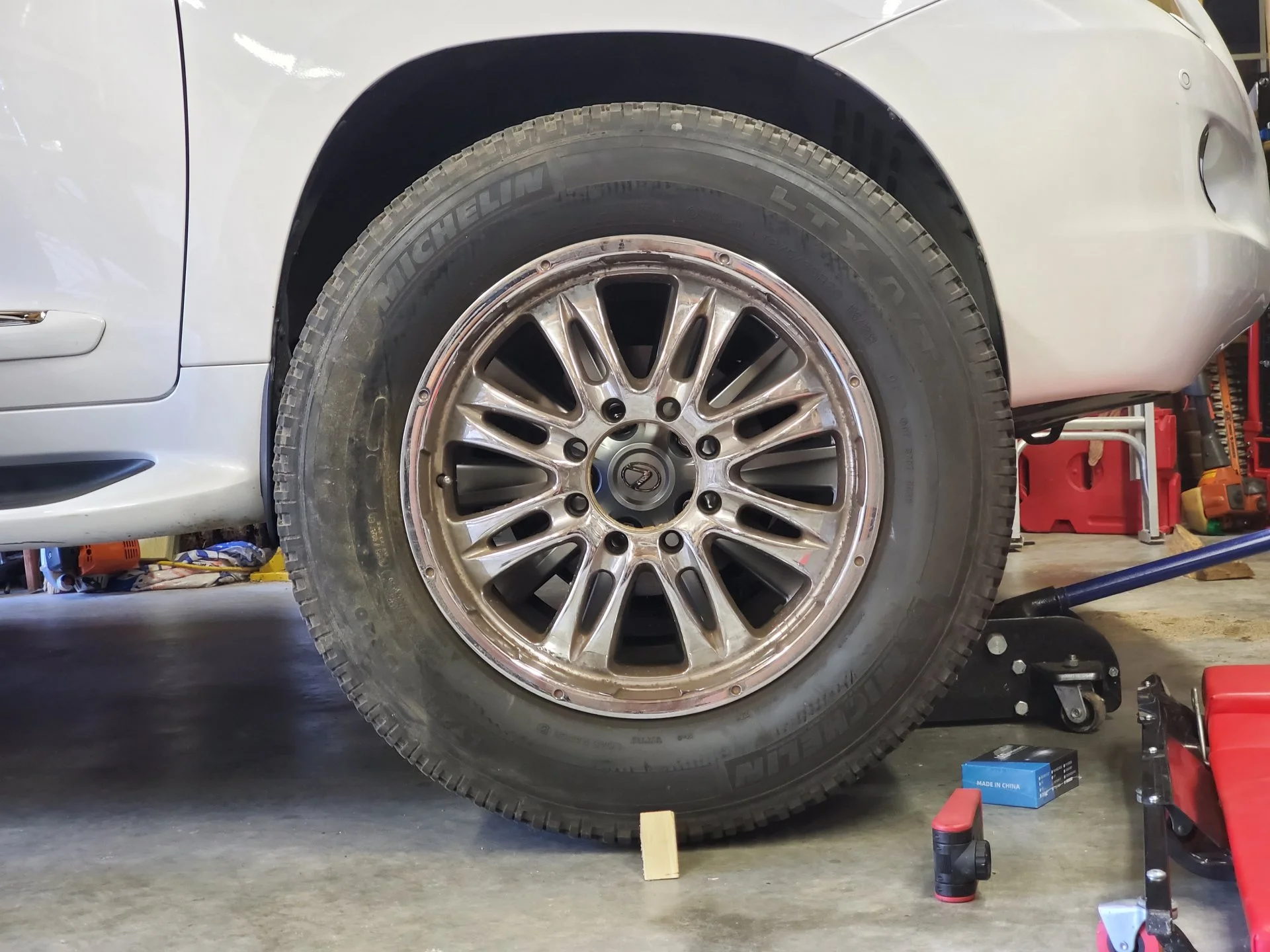

Hey everyone first post here - I'm going to jump in on this part of the post as I've been reading for quite a while trying to figure out what wheel/tire combo to order. I have a new to me 08 LX 570 and definitely need tires. Thought I'd upgrade wheels while at it. I'll break this out to a couple clarifying questions.
Question 1: seems like several are running 17" and 18" wheels. One supplier is saying the brakes are too big - you have to stick with 20's. I don't believe that to be true because LC's come with 18's. I like having more sidewall so I prefer to run 17's. Are there any modifications needed to run 17" wheels?
Question 2: after reading and struggling to find the wheels I want I had an epiphany; I have a set of Michelin LT275/65R20E's ( 34.07 x 10.83 ) I pulled off my truck (wheels won't work) but could just use stock wheels. I jacked up a corner of the LX to try to match up wheel centers to gauge fit. Can you really run a tire this big without anything but clearancing plastics? I've currently done the sensor lift - good or bad idea? Rides fine to me in N mode. Check my pictures on fitment please - my jack was under A-arm. Seems like it'll be really tight. Perspective on picture - tire is rolled in front stock tire on vehicle so it probably does appear a little larger - kind of like when you take a picture of a fish you've caught - hold it closer to the camera and walah, it looks bigger. Basically, will these tires I have fit? This is likely a temporary solution but maybe not.

1) Yes, 17s will generally fit. But not all. After you find the specific wheel, search to see if anyone has run them on these boards. Also, if it fits the Tundra, it'll work on the 200-series.
2) There's a good chance 275/65R20s will drop right in with minimal effort. Perhaps just pulling the plastic fender liner forward at the front of the tire. And removing the mud flap. Check out this thread. For more details of fender liner mods, check the build thread in my signature.
When you get into 34” you might also consider this impacts your effective gearing, speedometer readings, freeway rpm’s, etc.
Lots running that size with no complaints, but it’s worth a thought.

Speedo doesn't bother me too bad, I'm used to that with my truck. GPS on road trips from Waze will work and I don't drive fast anymore. Diesel fuel in my truck has conditioned me to back it down. Still, it's a fair point and appreciate the input!
Honestly these tires that I already own are a bit of a stop gap, potentially, if I use them. I still would like to get smaller diameter rim and a tire size in the 32.5 - 33 range seems like a good size compromise.
You can run 17" rims on both the LC and LX. No way those tires are going to work.
Thank you Charlie S! I agree, they don't look like they're going to fit to me, however, that picture is a little misleading perspective wise. Thank you for the confirmation on 17's!
