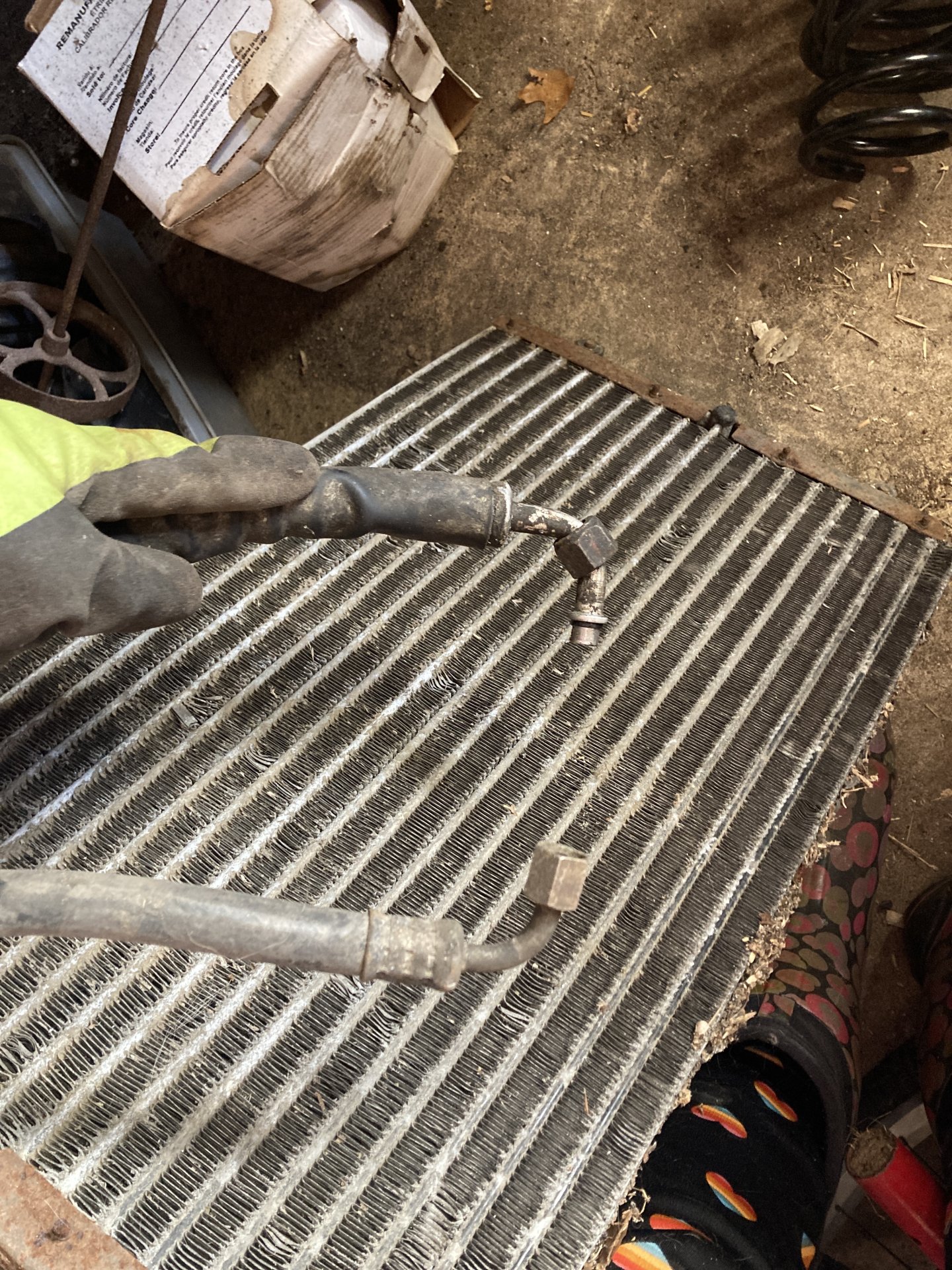

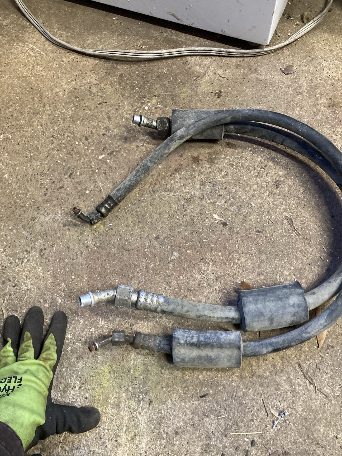

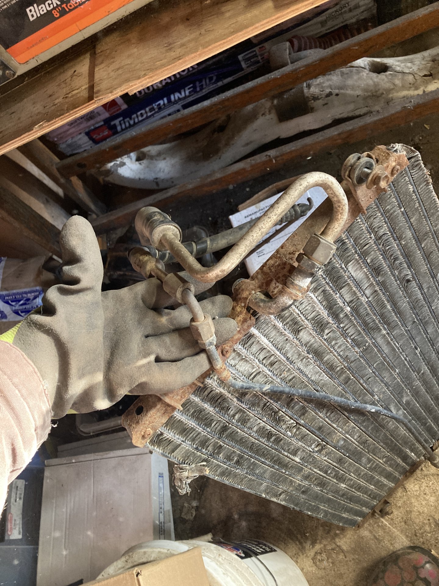

I definitely have it but I don’t want to give it up. I’d be happy tho to lend it out or take photos etc. I’m in CT. I removed mine a year plus ago but figure at some point I’ll add back in. Lmk.

Would you mind posting a photo? I'm going to round up the aftermarket parts and might take you up on borrowing it as a template for the local shop if they can build it (I'll ask them when I take my other hoses).

This is what I have. Your looking for the curved one?
Thank you SO MUCH! And sorry to hear it was a rough day at work.
Yup, the curved one is is it. That's the discharge - the one underneath that connects to the line that runs across the condenser connects to the receiver/drier and my drier had that connected. I'll round up the parts and let you know if I need to borrow it to have one made (I'll pay for shipping and everything).
Np, just lmk. I’ll wd40 it now to loosen the connection incase you do need it in hand. I have calipers so I can do some measuring too. We can talk via cell, I’ll pm my number to you if that would help.
FWIW it should be quite possible to get that hose made. I'm going through this right now, depending on the manifold/fitting on your compressor it should be a #8 female o-ring fitting (3/4"-16 threaded nut) on both ends. In my limited experience so far, if you can find an AC shop that will crimp hoses they may be able to supply fittings or you can order some online, and they'll just route and mark the hose and crimp it for you. No need to copy another as a pattern.
