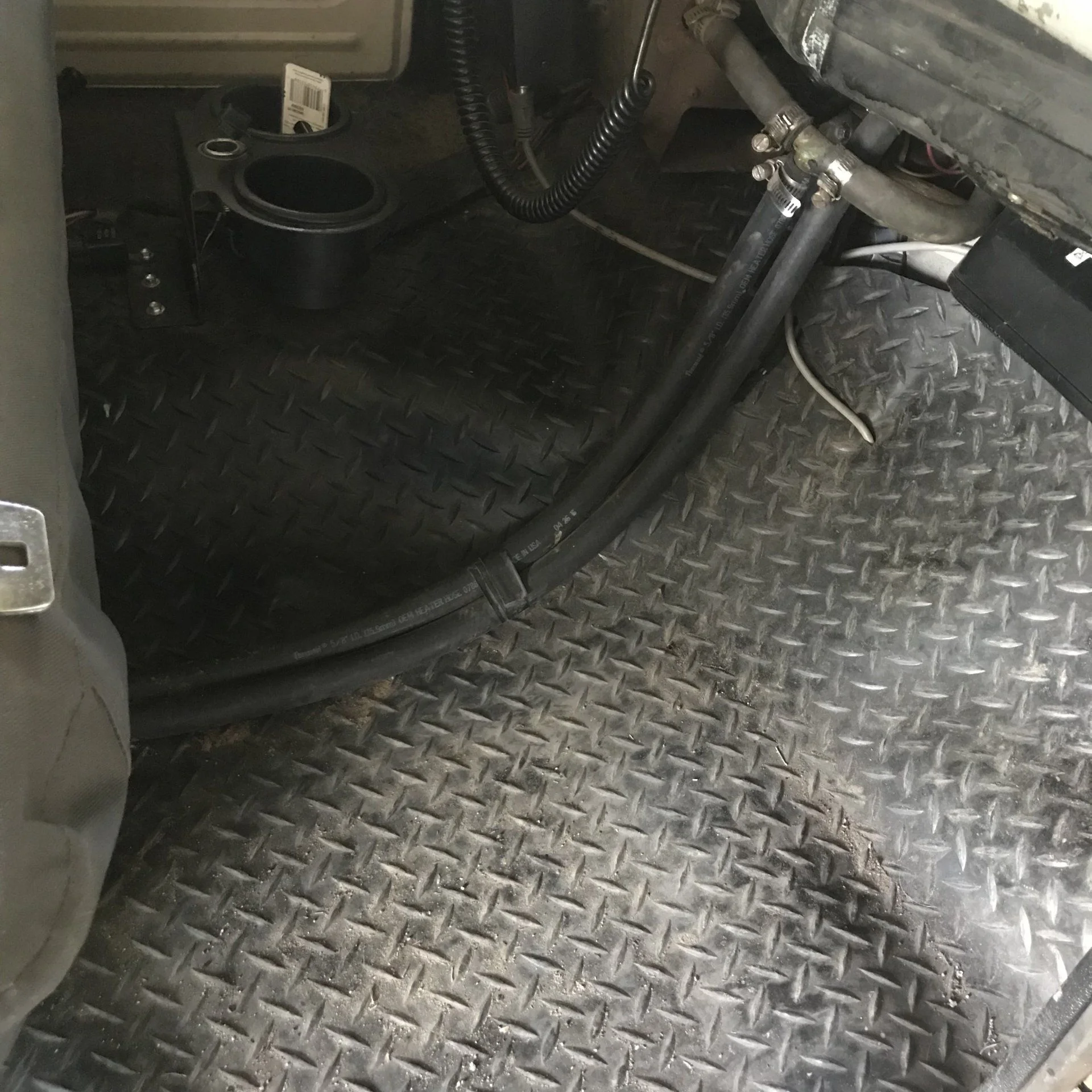

I bought a roll of diamond plate rubber and made my own for my LV like I was ever going to find an original. It turned out really well I made a paper pattern and cut it out. Rubber cost me about $60.00 .
Nice. That’s what I was thinking about doing. Do you remember where you sourced it from?

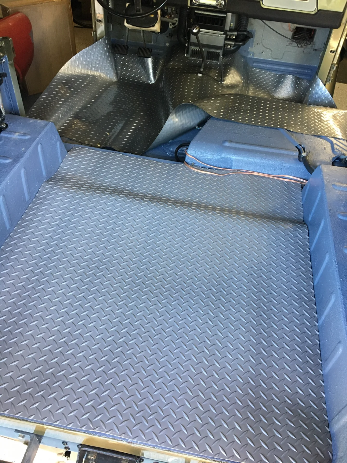

I’ve got leftovers of vinyl diamond plate from redoing the ambulance floor. I bought the 7.5’x20’ roll at Costco. It was a bit over $1/sqft. Originally it was designed to cover garage floors. I plan to cover as much of the floor as I can manage. It should work well for all the flat areas. The floor I have installed offers good grip and limits things sliding around.

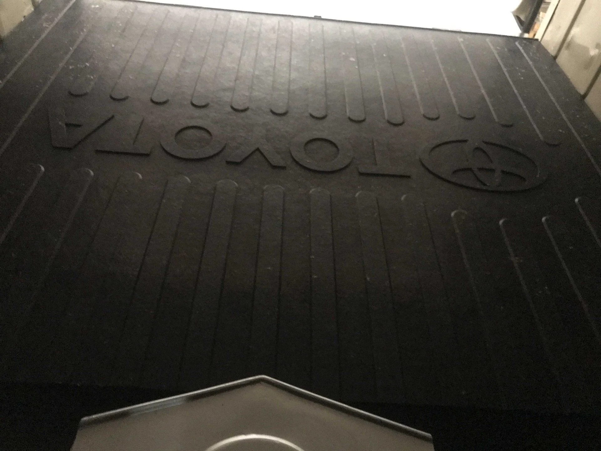

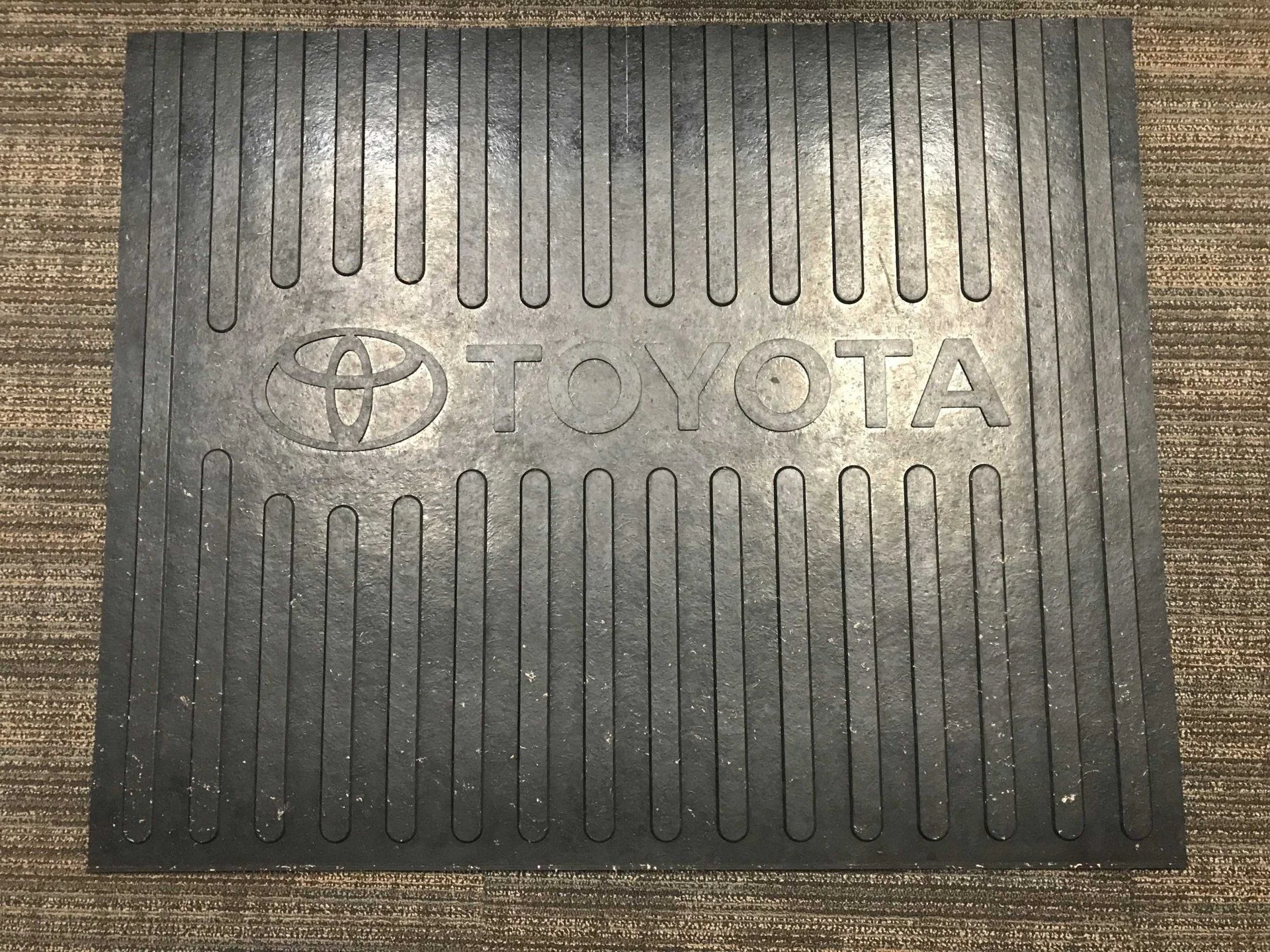

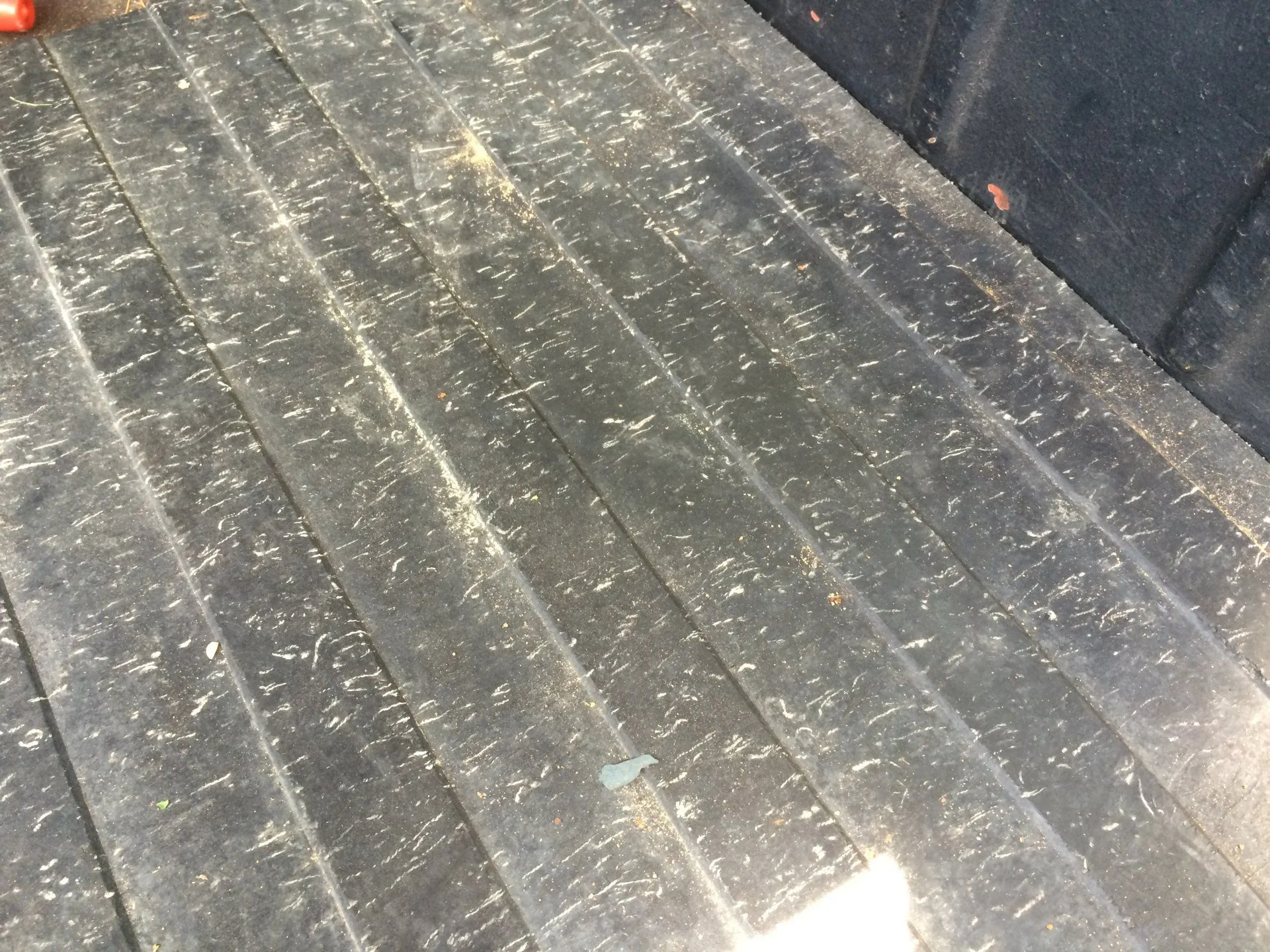

Truck bed mat from Tractor Supply

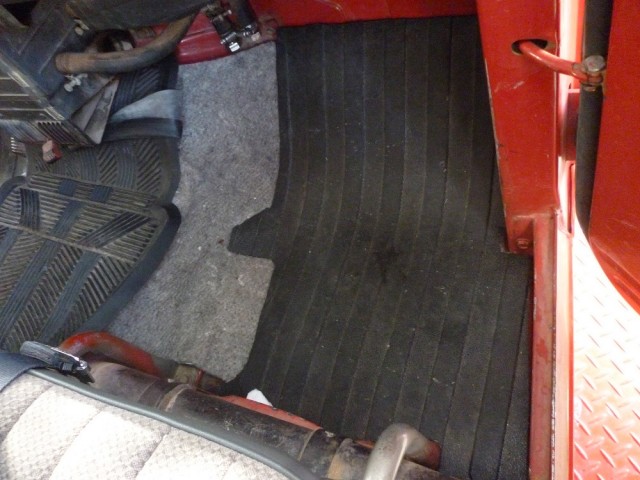

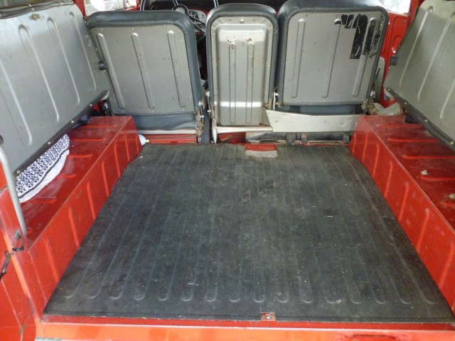

The truck bedmat has ribs that matches factory floor

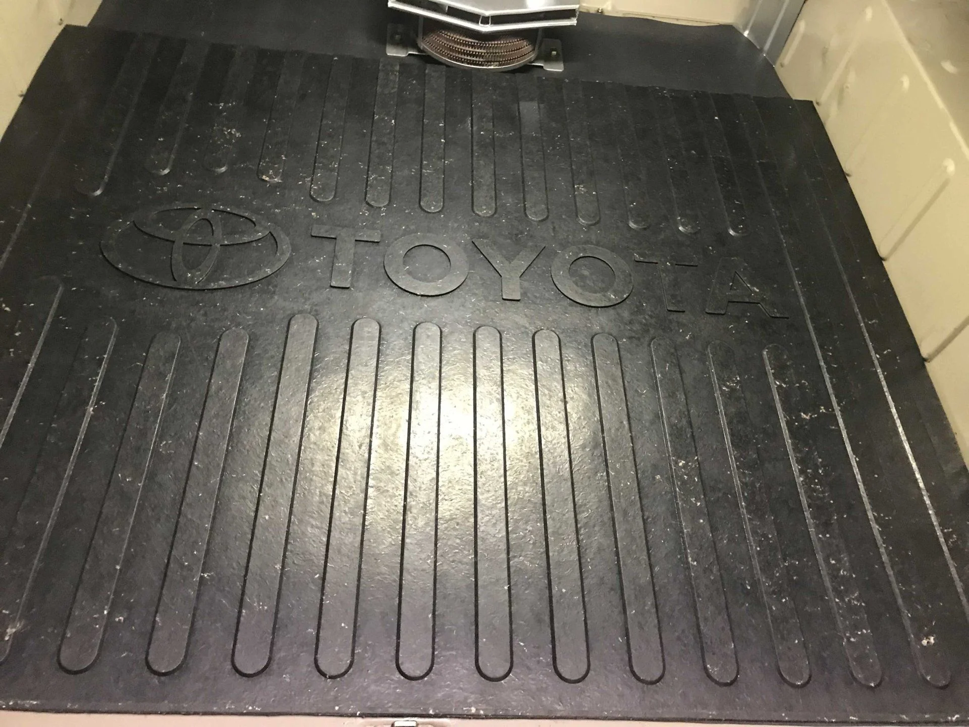

Rear Mat: Not factory from '77.....but then again, it is an OEM Toyota product. :grinpimp:

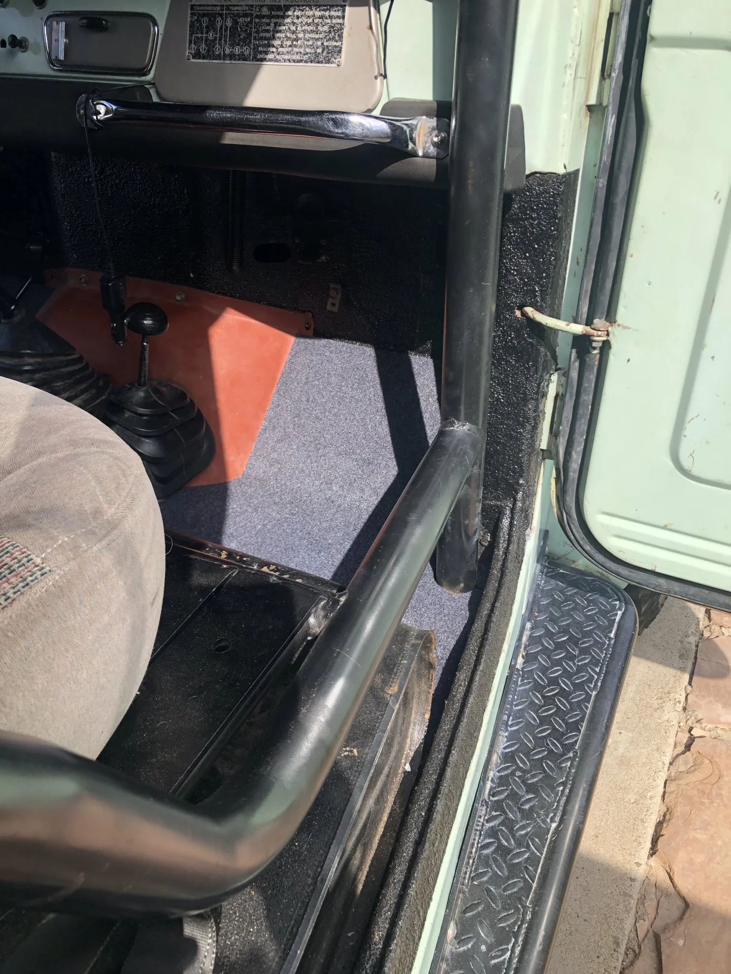

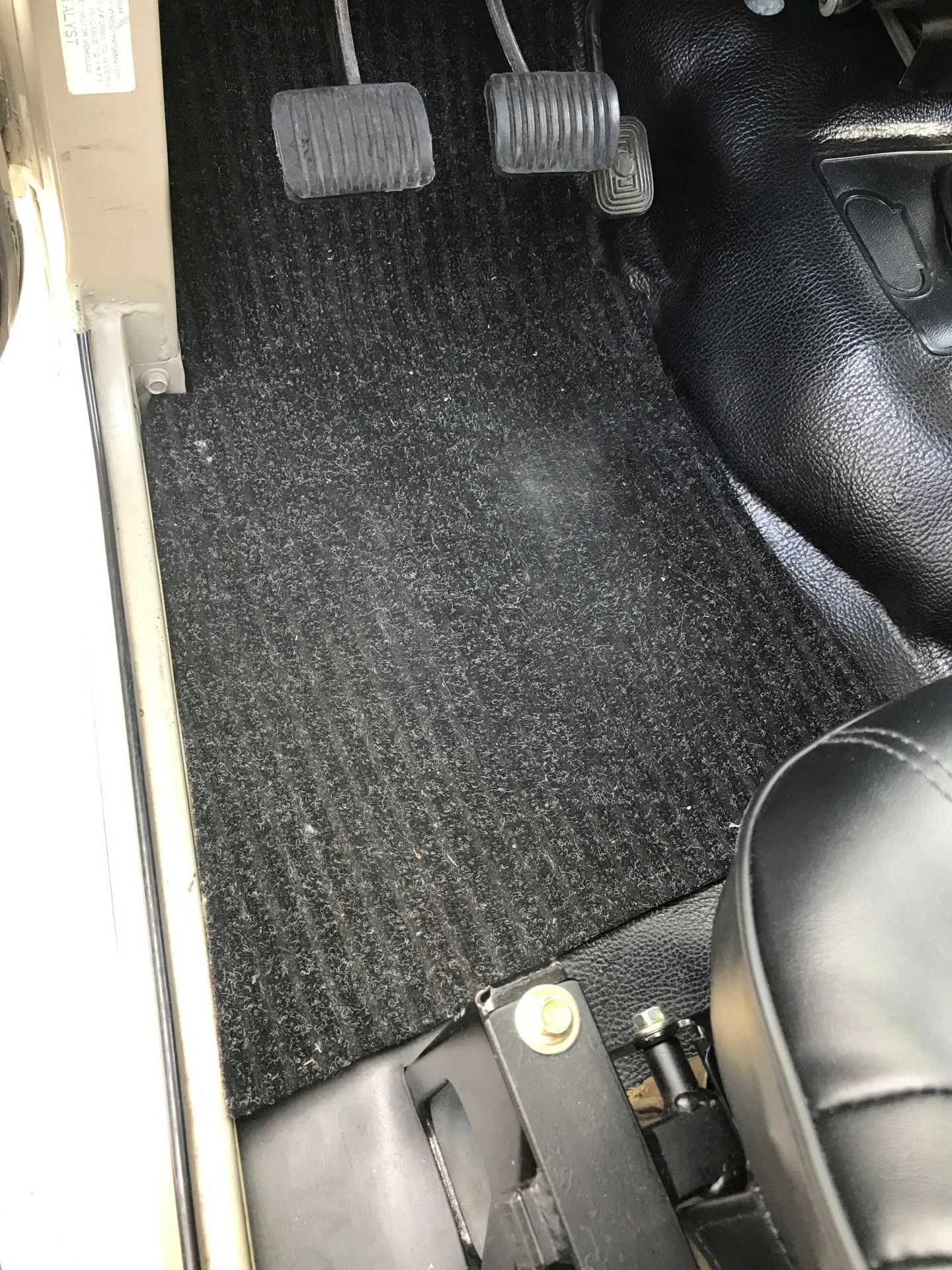

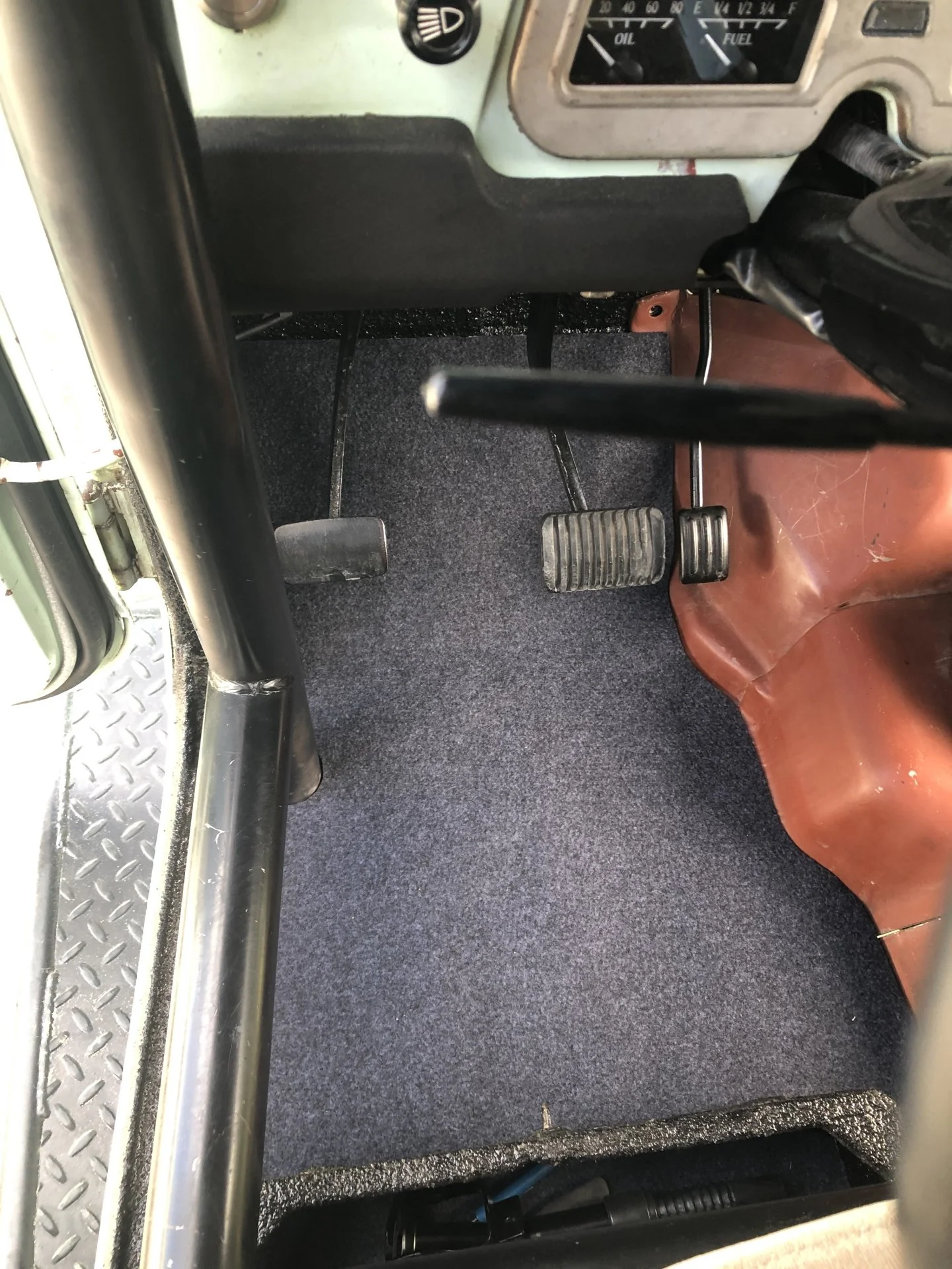

For the front floor mats, I cut up some stair runner stuff from HD to cover the OEM mat.

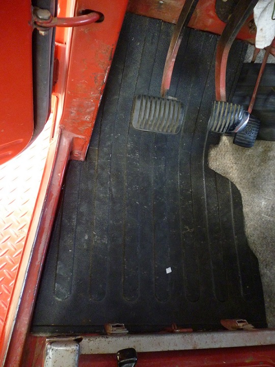

Horse stall mat.
Heavy duty, thick, even cuts down on some heat in the cab.
