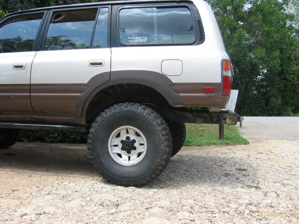

Greetings all.
Due to some rust and damage I am strongly considering cutting off the lower 1/4 panels of my 100 and custom fitting a rear bumper that will fit in the old body line. Has any one done this?
So far I've elevated the electronics behind on drivers side to higher up in the body. Next Is making a plan for the drain tubes but at the end of the day the question is a straight chop and weld on or a jeep cherokee style cut the back 75% off (inboard body panel) and fold the existing outboard body sheet metal back.
I'd love to hear some thoughts.

Check the link. Ive seen some folks chop the 1/4 on 80 series (picture taken from link above). I'm thinking of following the same body line but on the UZJ100.

Agree about prices. Crazy expensive compared to the slabs of angle iron im used to with 40's. Doesn't seem like there is a lot of prior experience on the topic of 100's. I will try to document what I get into. My thought was to modify the 4x4 labs design to fill the 1/4 once chopped.
