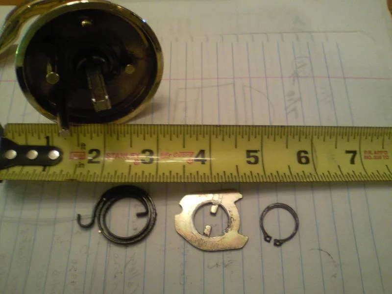

For now, it's not a traditional coil spring, it looks more like a piece of 1/8" flat stock wound into a spiral approx 1" in dia. There's a small ear on the inner and outer ends of the spiral.

Thanks, guys. Inside the handle, the snap ring holds in the side control, which is on top of the spring. Anyone have anything like this spring??

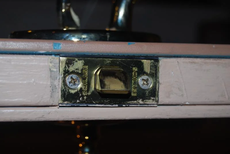

I need more information to help you. There is a lock that uses that spring but is it more common to see it on a French door. Can you do me a favor and take a photo of the latch.

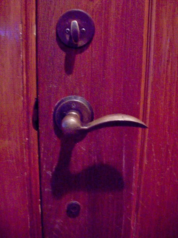

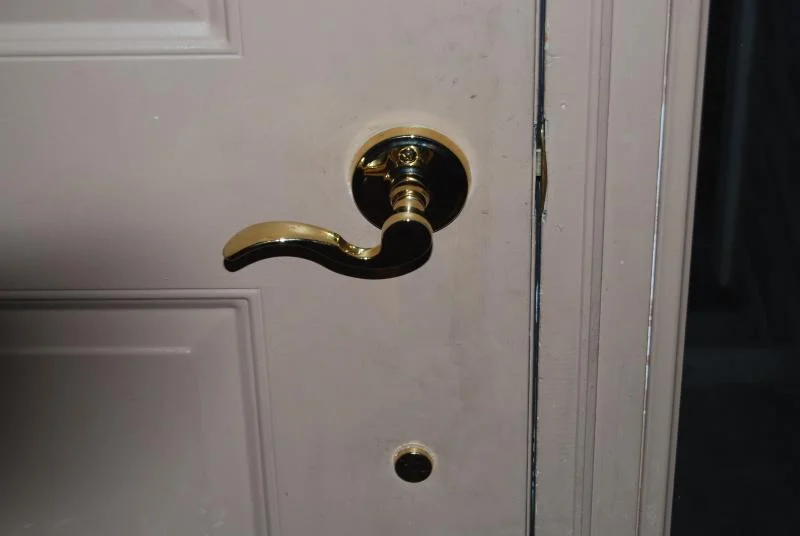

Here's the best I can do, thanks for taking a look!!!
inside
outside
striker
What you have there is one of Schlage's early models of their "F" Series picture handle sets. I am surprised it has lasted you this long. There is nothing that is "off the shelf" that you could use to fix your problem that I am aware of. The whole series was designed to economical and not very repairable. So you can continue to try to fabricate a return spring or purchase a new lock. Worst case is that the new one might different size base trim so you might feel the need to repaint the door if they do not cover the old lock prep area. Second is you will want to measure from the center line of the latch to the the bottom fastener on the handel so you will be aware of any changes in handle length there. Again worst case.. drill a new hole and putty-paint over the old one. I have seen many of these at the "big box" stores. And from memory I think you have the "Camelot" style of trim. The guts of the new ones look nothing like what you have either.
