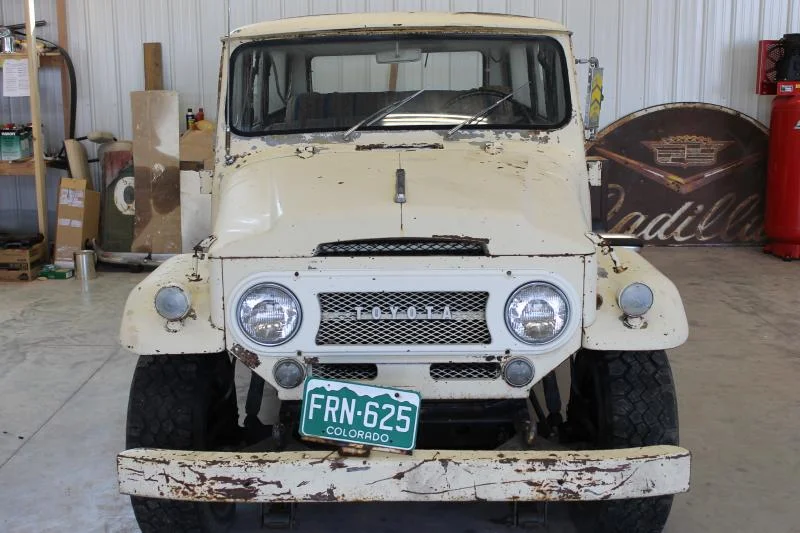

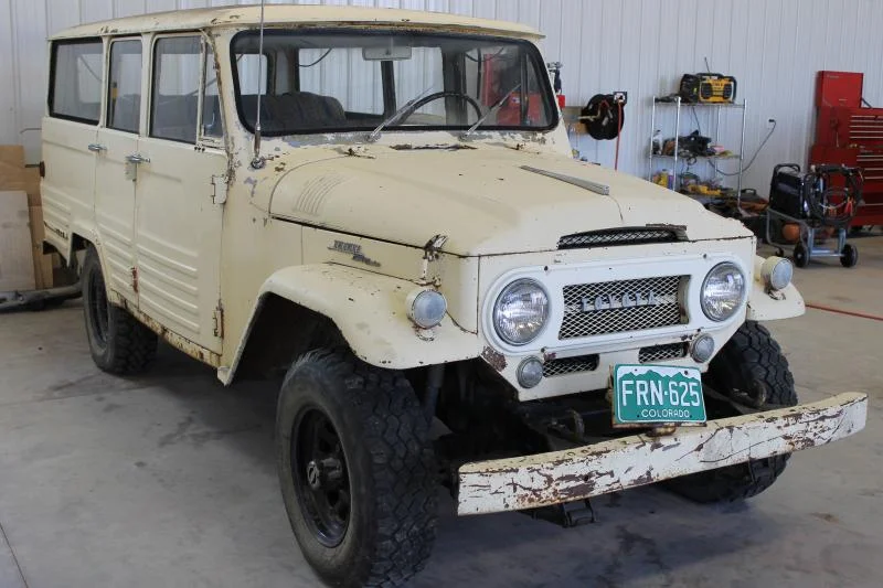

I've started on one of my 45LV's to build as a daily driver. I love and respect keeping these old things original, but I'm building this for a daily driver.
I've measured the wheel base and it looks like or at least the closest Toyota frame I could find would be an FJ Cruiser. I am wanting to keep the body all original but put it on a newer drivetrain, chassis and running gear. I would like to keep it all Toyota if possible, or maybe an LS motor?
Does anyone have any ideas or thoughts on what would be the best way to go with this project? I also need to fix a little rust in some of the floor boards and rear quarter ribs. Any ideas there!

Cool Cadillac sign in the background. Looks like you have good taste.

Oh... and the Caddy sign I found out in the badlands here in Wyoming, with a giant rattlesnake under it!
