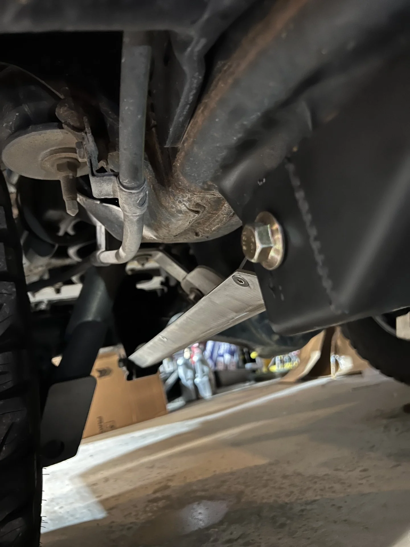

I did this today, and it couldn't possibly have been easier.
I followed the guidance here and fsm directions about putting a jack under the rear axle, but I'm not sure it was necessary.
It was as simple as removing the RLCA one at a time and replacing them.
Two bolts (19mm) and nuts (22mm) each side.
The driver side was easier since I could use my electric impact - the pasenger side didn't have as much room (Budbuilt fuels skid was in the way of the front nut), so I used a breaker bar and ratchet.
I used a ratchet strap to help align the passenger side, and the driver side bolts dropped right in.
I installed new (takeoff) control arms, Turbo8 control arm skids, and Trail Tailor lower control arm skids all at the same time. It was easier to save up parts and do them all at once.
I installed the Turbo8 skids on the bench before installing the arm.
Like a lot of things, it took more time pre-planning and posting about it than it did to do the job. :)
