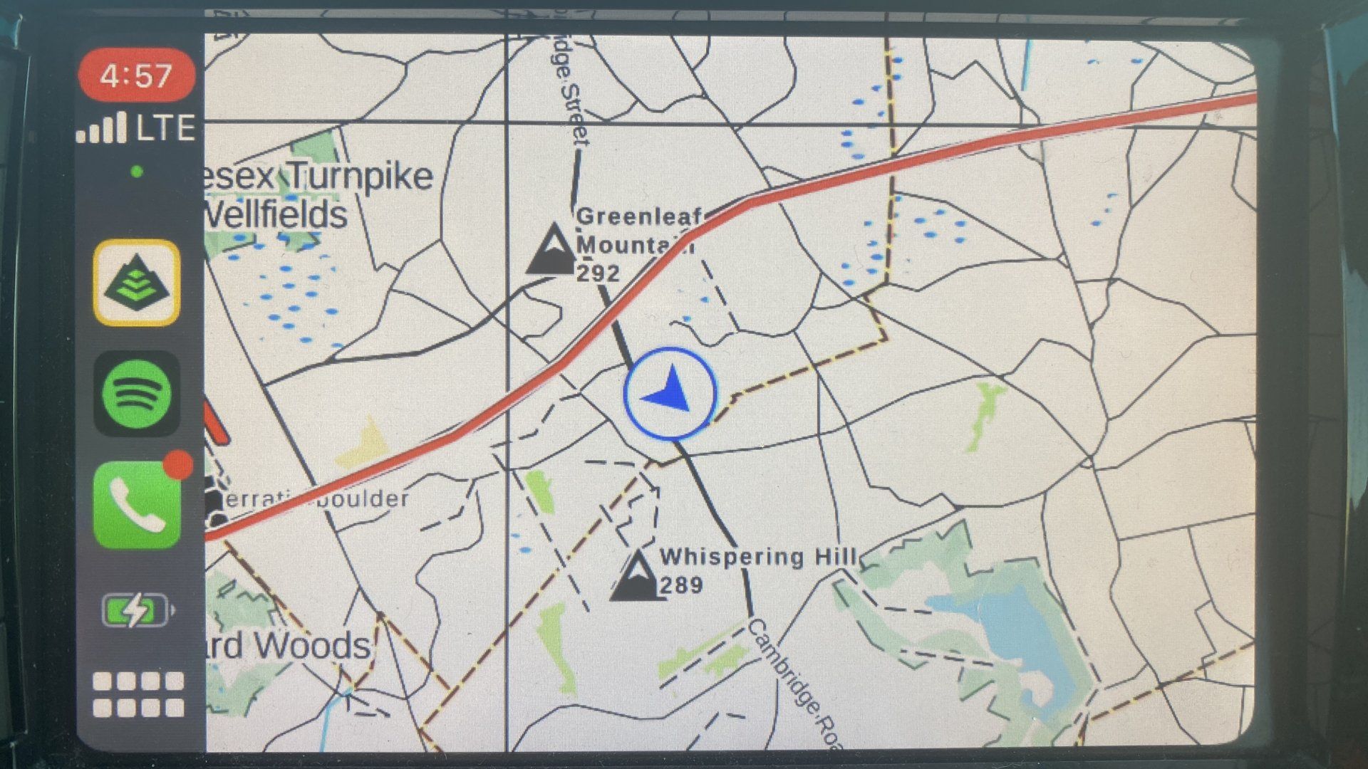

Gaia work well on CarPlay. Maybe adding CarPlay support on the oem system is another option? The screen is a bit larger than cellphone.
Yeah, I'd love CarPlay, but it is a bit out of my comfort zone price wise - Naviplus sounds like the way to go, but even with the discount code, it is more than I can justify. I think if I was going to spend that much, I might buy an iPad Pro with the cellular capability (which includes the GPS receiver). I guess I'm weird - I can justify that kind of spending on armor, tires, winches, etc, but to spend it for a radio feature feels wrong.

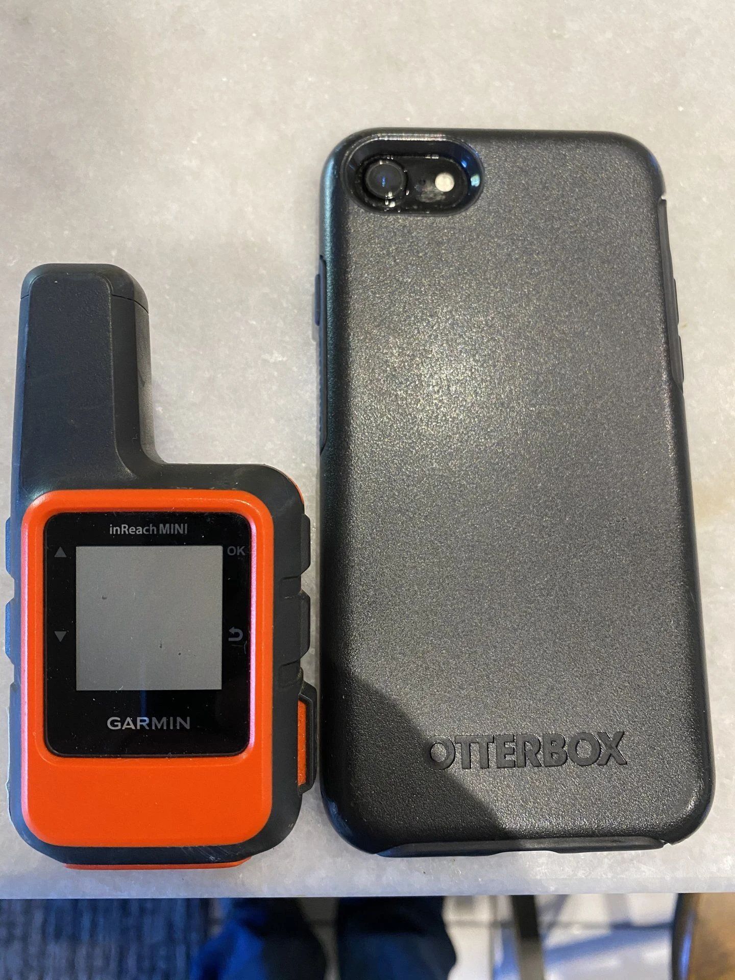

The main selling points for me on the mini are that it is incredibly durable, has incredibly long battery life, is IPX7 water resistant and there is this:
I can lash it on a backpack and never worry about it. When offroading, I keep it on the dash. And although it is IPX7 rated, I have dropped it in a near freezing High Sierra stream for over 30 seconds and it never even turned off.
More to the point, I think Garmin makes some damn good products and a large variety to fit different lifestyles and uses. You probably can't go wrong with any of them for this purpose.
