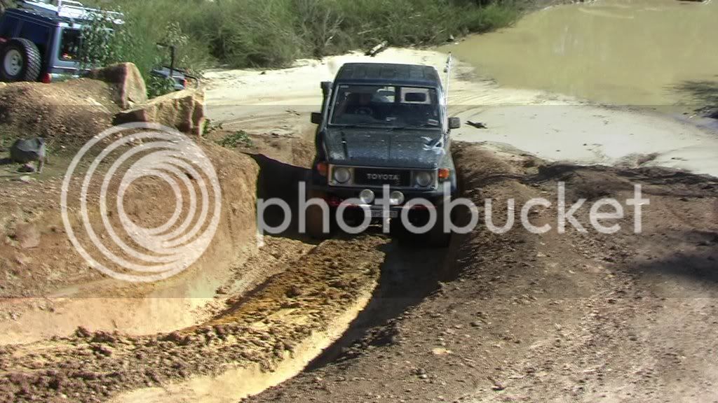

Heres it off

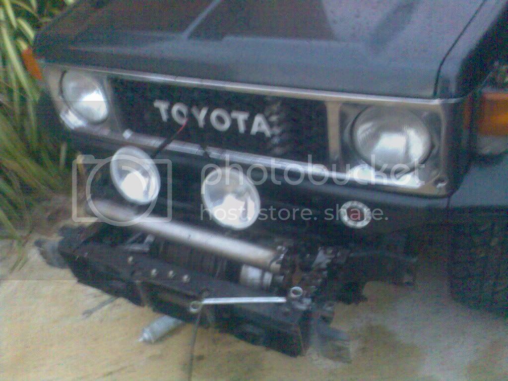

And on
Mine looks the same just not by choice. Was in a accident and ins. wont replace it. I am looking for the same idea. My thought was to make a new front crossmember out of channel and tuck it in as far as possible, then mount the fairlead to that. I figure that if I mess around and get the fit right I should be able to shave off almost two inches. Off there I will build a "bumper" that is a low key and tucked in as much as possible, kinda Baja style. Waiting for my bud to finish his bumpers so we can get it in his shop, will post pics when I start. Even with the "sun deck" bumper on the stock front the approch isnt that bad ad it sure is nice when you need something to climb on. Just m2c

lol sundeck bumper! Yeah i ripped that off the day i got it! Yeah i know the appproach angle isnt really that bad it doesnt even hinder it worse that the leaf and shackles but i think its just a mindset thing. You drive alot better knowing you havnt got this massive piece of metal sticking out of the front.
